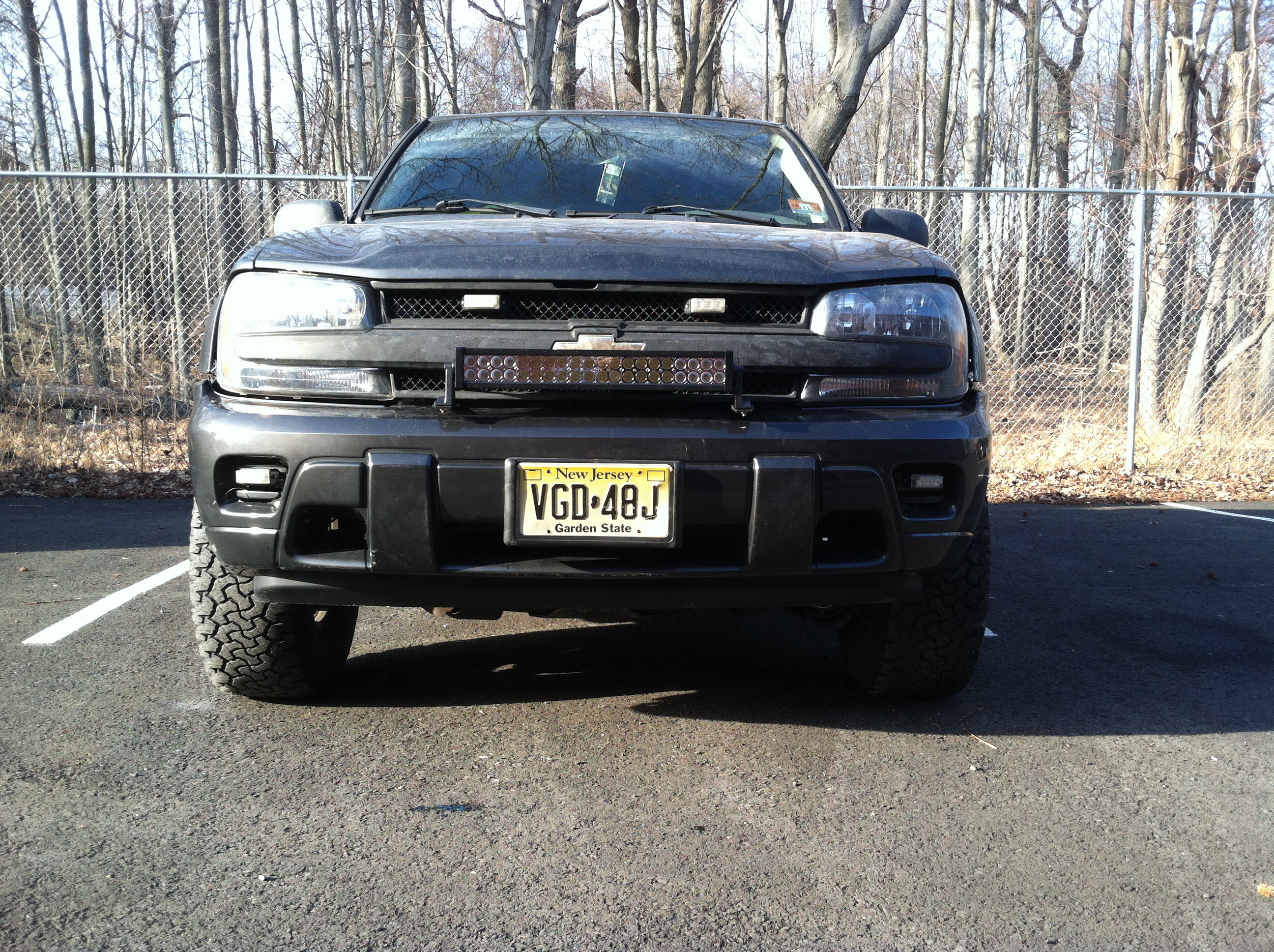

by c bausch » Sun Jan 25, 2015 12:42 am
21.5" mictuning led bar, 4 whelen tir3's
