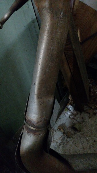

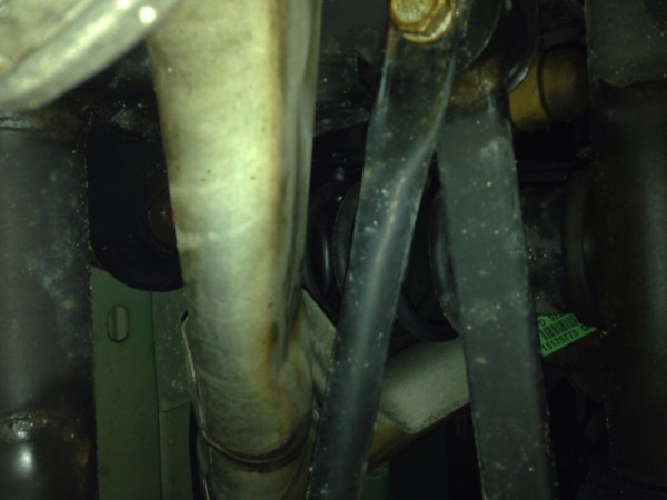

I added a Markmc 3" lift with hd bilstein up front and skyjacker 8030's in the rear not to long after I got it lifted I start to hear a noise when I would hit a bump in the rear end. I got under the tb today and the only thing I could see was what looked to be this bar in the picture is hitting the exhaust right before it goes up and over the axle. Does this look normal or is it hitting like it looks like it is to me. Has anyone else had this problem and if so what did you do?

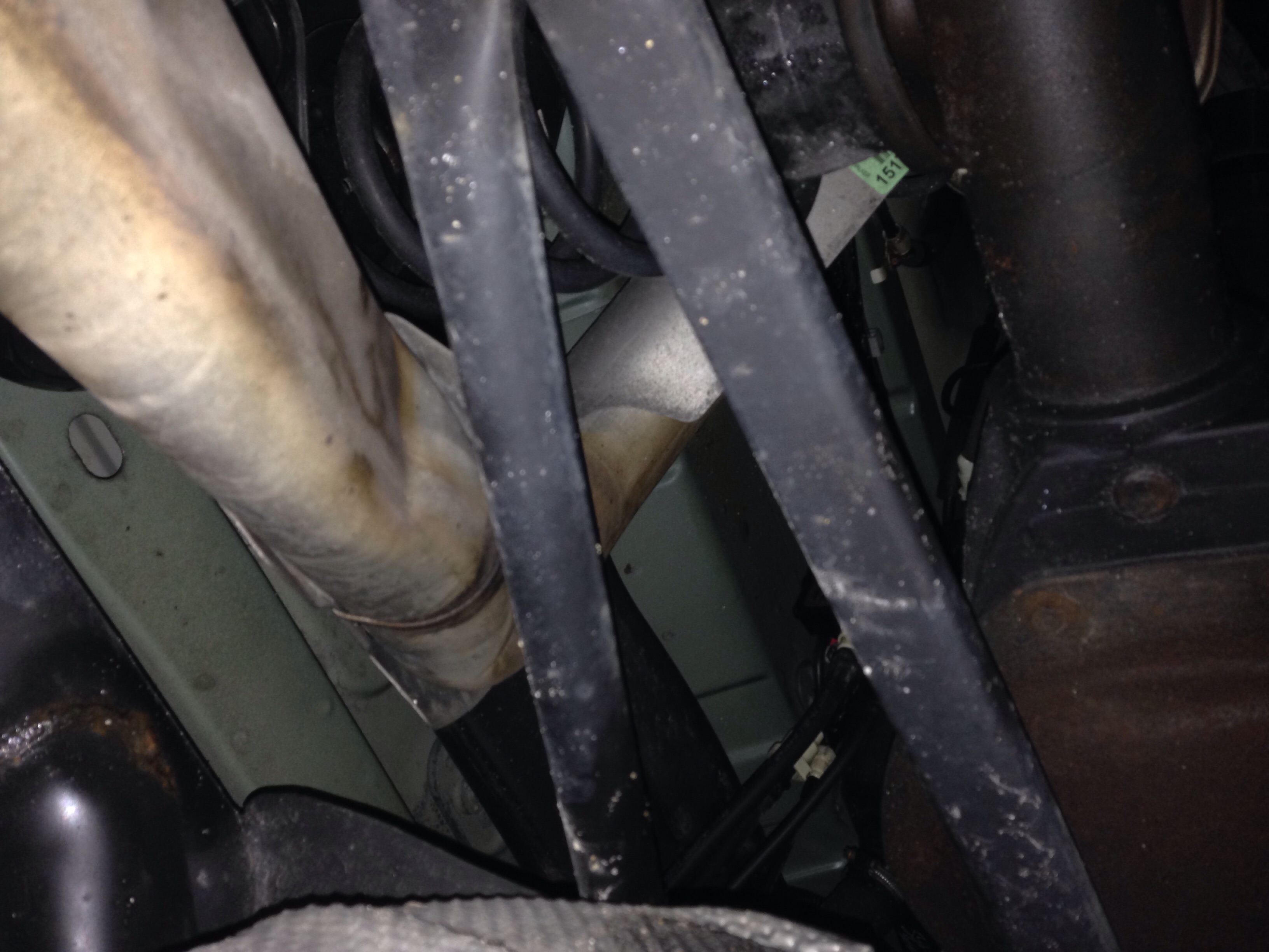

by JD8181 » Sun Feb 01, 2015 11:54 pm
Another picture.

It's possible. It looks like it's an inch or so which typically doesn't cause a problem. Is it a rattling sound? Can you find any broken exhaust hangers?
by v7guy » Mon Feb 02, 2015 1:07 am
That part of the exhaust is flattened like that in all of em
Most commonly it's the shock bolts that have loosened up.
Here's a pic of mine for reference...

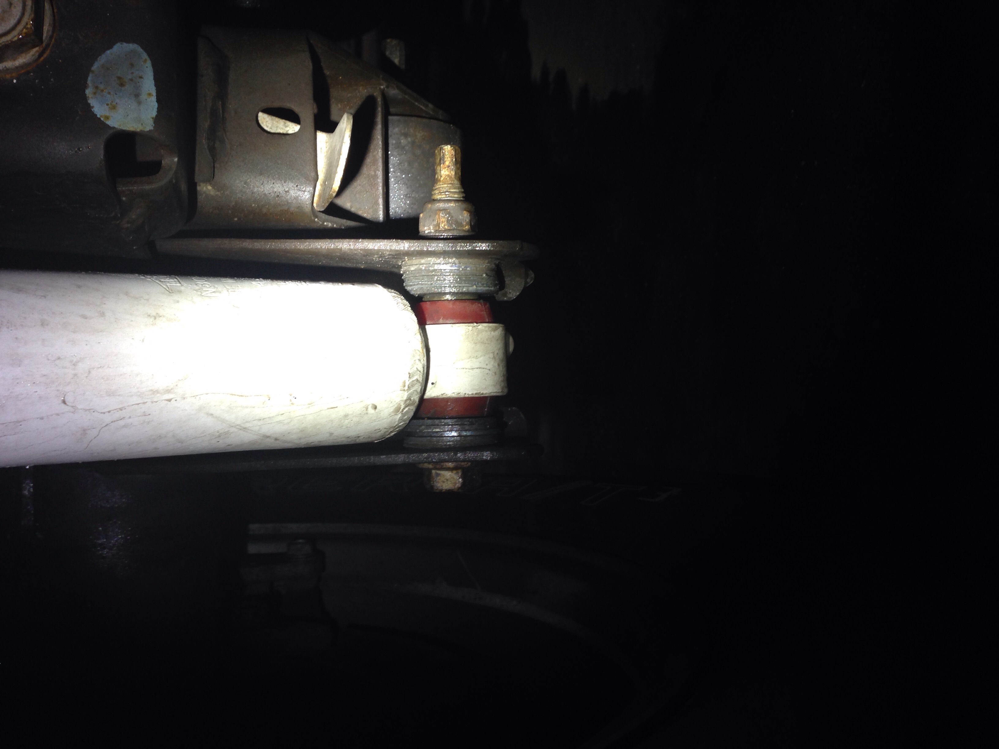

Post a pic of your rear lower shock mount.
Did you add washers on both sides of the shock mount bushing tube to take up the gap?

by JD8181 » Mon Feb 02, 2015 9:49 pm
Yes I have washer in the rear for spacing. I lowered the spare and retightened it and checked all the lugs. I recognized today I can only hear it at low speeds.

by JD8181 » Mon Feb 02, 2015 9:52 pm
Picture of the spacers
