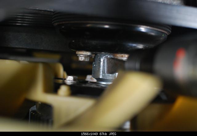

by Trail X » Sun Oct 27, 2013 10:58 pm
Both the fan and the tstat generally are fail-safe designs.
Anyways, if you look down in there, you should see some bolts opposing each other. See if you can loosen them and tie something between them. If you can tie those bolts together, you should have a fan that is mechanically attached to the water pump, and therefore turns with the engine no matter what.
Fan clutch image - source: meerschm@gmtnation
