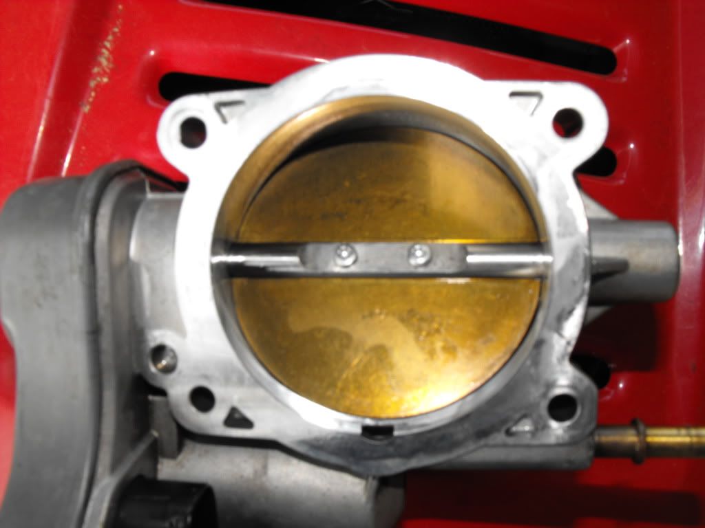

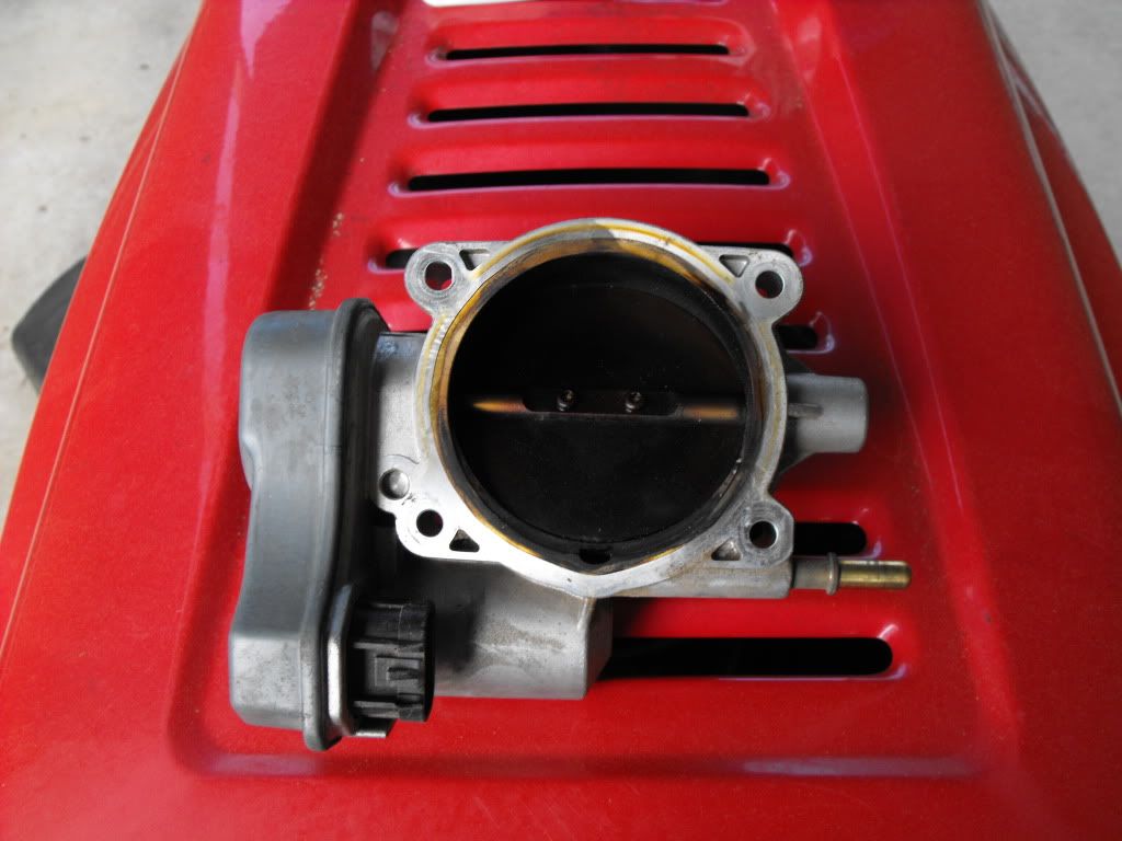

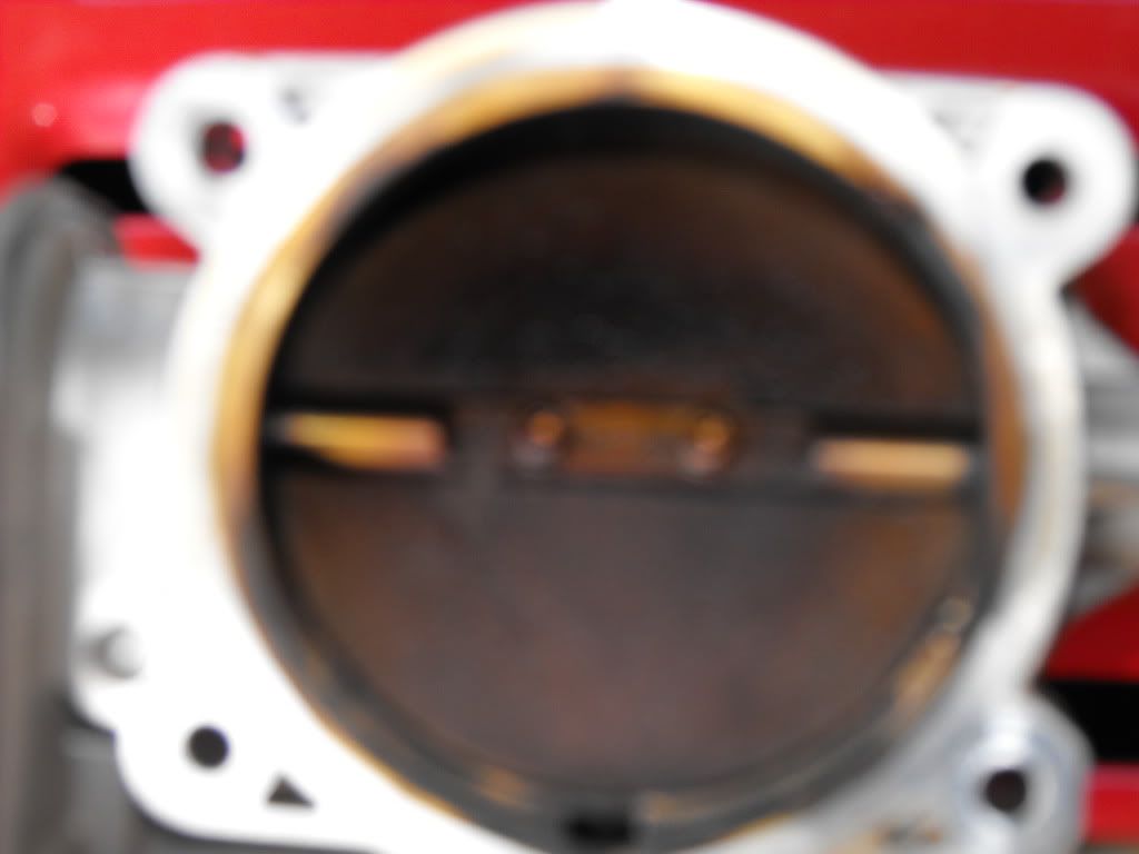

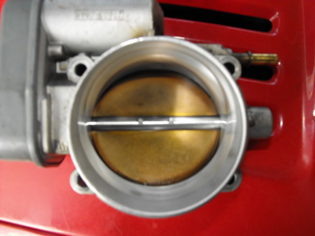

Throttle body cleaned this morning.
Before
After
Idle was smoother almost instantly!
