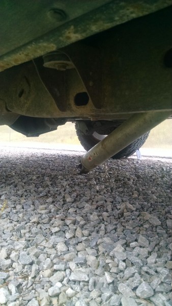

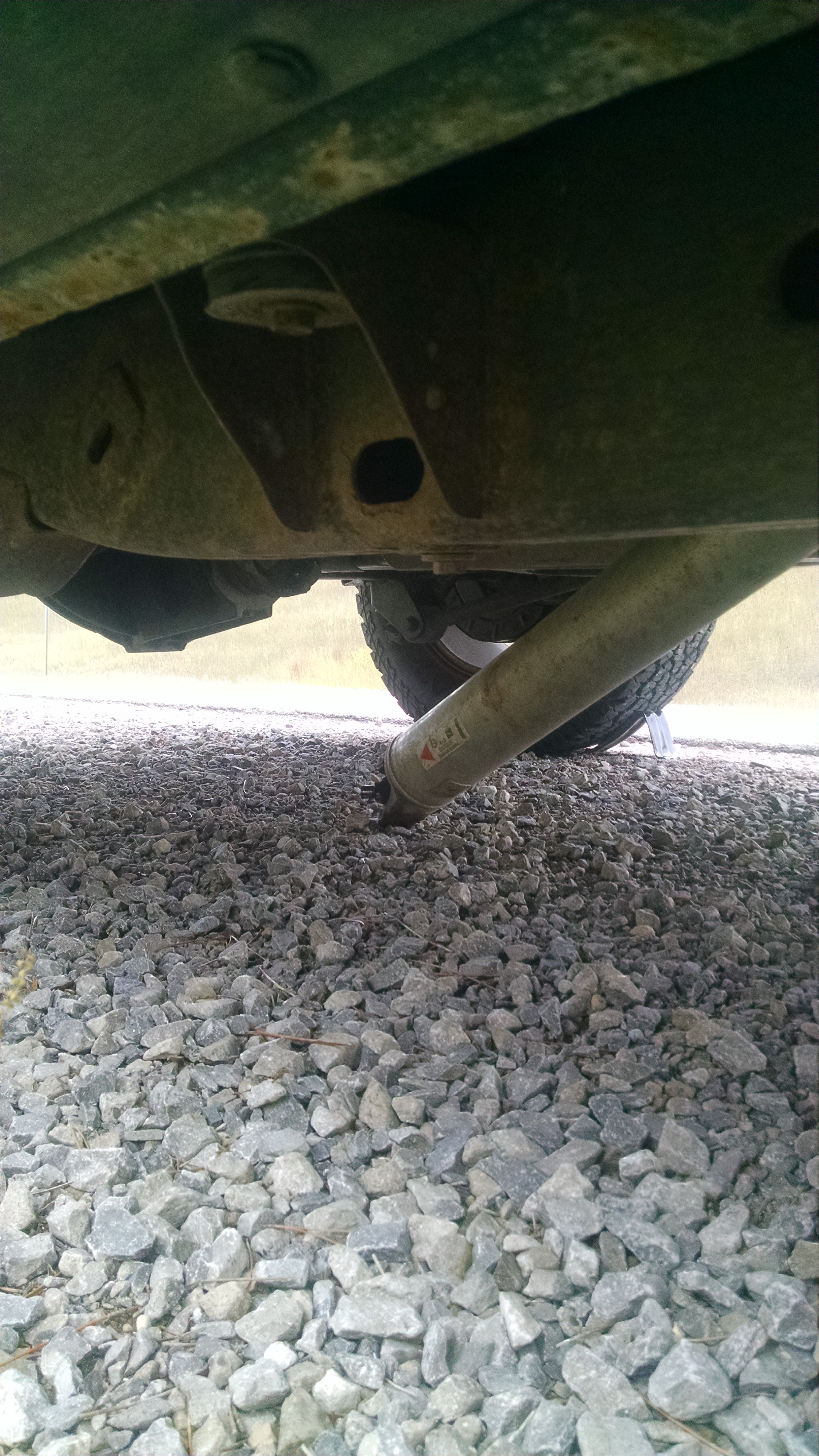

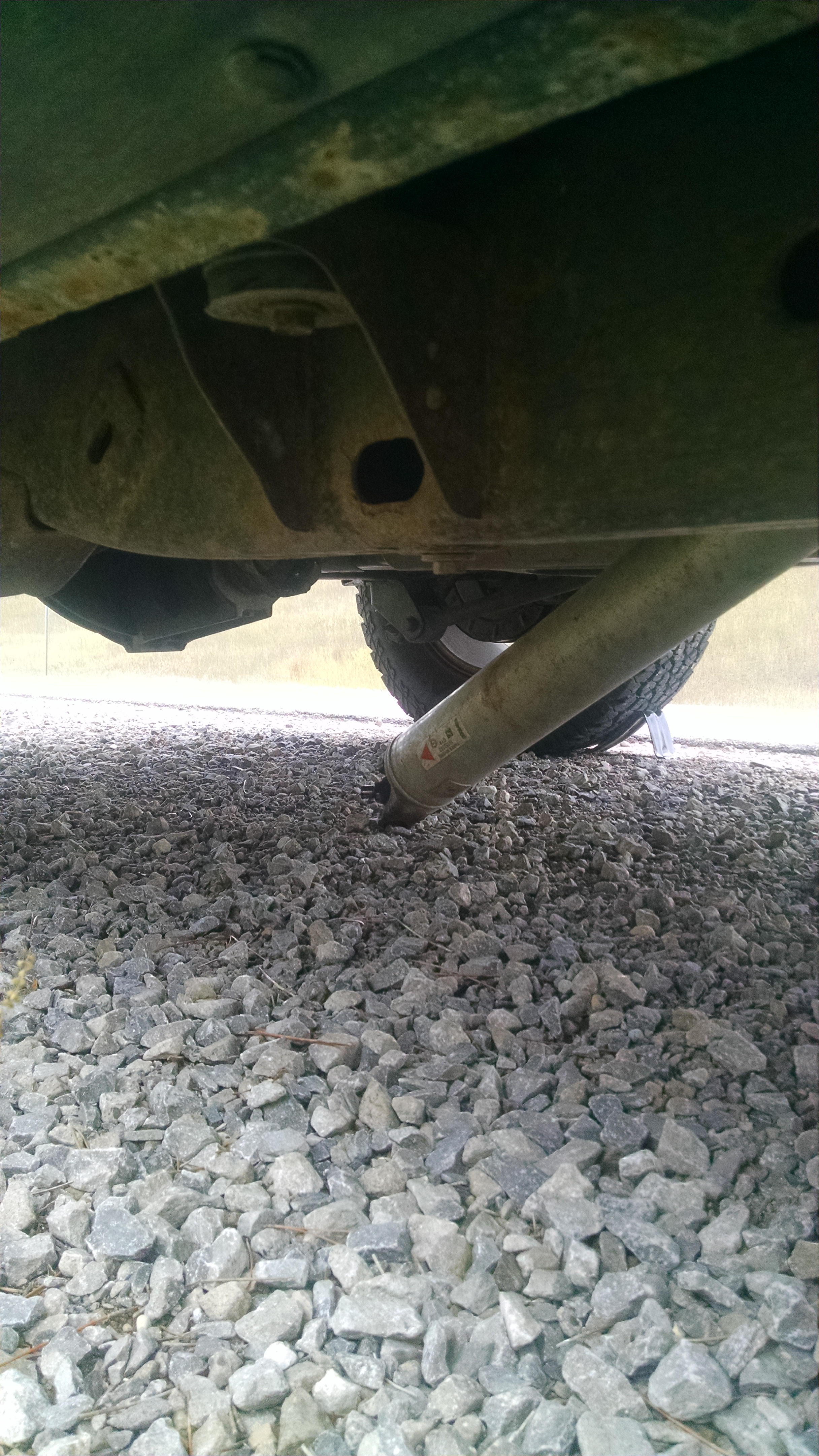

by Cable810 » Fri Sep 19, 2014 9:57 am
Drove it and had this happen
by Trail X » Fri Sep 19, 2014 11:09 am
Dang, looks like Mario's did. What broke?

by Cable810 » Fri Sep 19, 2014 12:27 pm
James, It looked like it just slipped out of a cap. The other one was still held in my the strap. Now I've got to figure out how to get it home...
by Wahugg » Fri Sep 19, 2014 12:42 pm
Pull the drive shaft, put a gatorade cap in the back of the T-Case to keep the fluid from leaking out, put it in 4hi, and drive it home nice and easy.

by Trail X » Fri Sep 19, 2014 1:18 pm
Wahugg wrote:Pull the drive shaft, put a gatorade cap in the back of the T-Case to keep the fluid from leaking out, put it in 4hi, and drive it home nice and easy.
-Wahugg
Yep, but I don't think you have to cover the slip joint hole. Though you want to if it's raining or if you're driving through dirt to keep it clean.

by Cable810 » Sun Sep 21, 2014 8:34 am
For Future reference the Gatorade cap trick wont work on the TC. I got the Shaft back in hopefully it wont happen again!!
