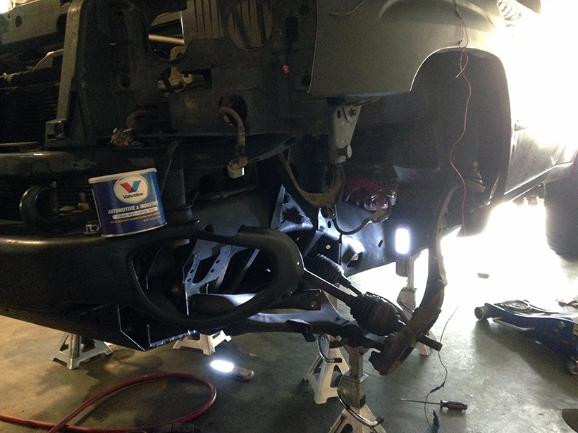

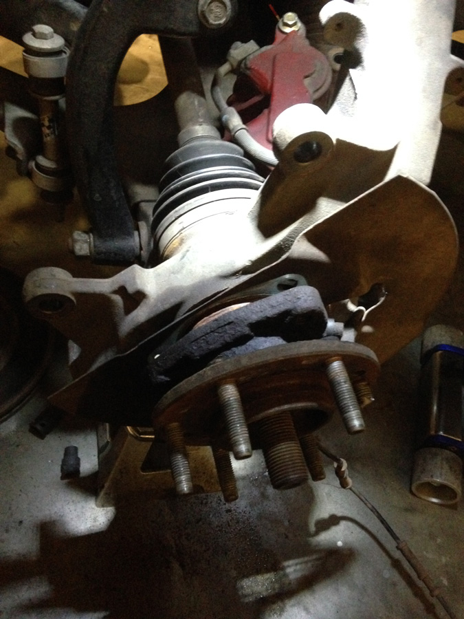

As with most things on my Rig, it seems like my front wheel bearings are fused to the knuckle. Anyone have any tips for getting the hub off the CV Axle.

Reading that again, your words don't match the picture. I'm assuming that you meant that your CV shaft is fused to your hub? Looks like your hub is free of the knuckle in that picture.
If your hub is fused in the knuckle, get the CV out of the hub first, then thread in your 3 mounting bolts a good bit, and hit their heads with a hammer to rock the hub out of the knuckle.
by mikekey » Thu Jan 02, 2014 8:29 am
JamesDowning wrote:Reading that again, your words don't match the picture. I'm assuming that you meant that your CV shaft is fused to your hub? Looks like your hub is free of the knuckle in that picture.
Yes, I'm probably mixing up my terms. I'm used to whats being referenced as the knuckle being the spindle on RWD vehicles.
Ok, so family visits interrupted me yesterday. I got the hubs on both sides separated from the knuckle, but the CV axles are still attached to the back of the hubs. I was referencing the great write up on replacing your hubs here on ORTB.
So I'm assuming I should thread the hub back into the knuckle and tap on the end of the CV axle, then remove the hub.
