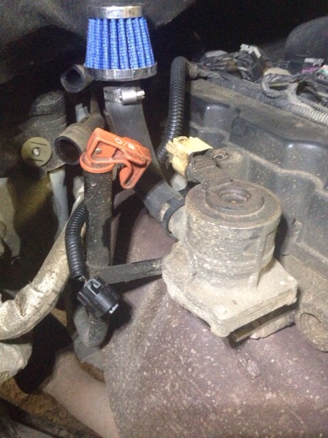

So what I did was eliminate the pump and hoses. Took the small hose and cut it short, took the little hose conecter part and put it in the other end of the tube because it had a natural 90 degree bend in it so it would shoot upward. Them simply put the breather filter in. While it was all off I cleaned my throttle body and reset the PCM. This is what it looks like
If I knew more about this system might have a diffrent approach at this but to me, it collects water and honestly does nothing. And it's expensive. If the older TB can run without so can mine! And yes there's a code but the SES light has always been on for dumb stuff but it doesn't bug me any. Maybe later down the road I will change it up

by v7guy » Mon Apr 06, 2015 1:10 am
As James said, basically you're letting hot exhaust just out of the head blast that filter when the valve opens.
I dunno if it's hot enough to burn the filter or set it on fire, but it's something to consider. Might be ok if you unplug the electrical connector on the solenoid. But at that point you don't need a filter on it, just take the tube off since it isn't going to doing anything anyways.
Or if you wanna delete it, unbolt the solenoid, then cut out a plate to seal the hole in the manifold. It would basically just be a couple holes drilled in some steel, super easy to make.

Yeah, that's what I figured, after my test drive to work today with the heat on it was letting some exhaust fumes in the cabin so I will be changing it up tonight. Ill probably make a plate like u said Jason. Live and learn right. When the heat was off I didn't smell any fumes, they went bad but I got kids so that's a given to change it up. I know it's got something to do with vapor build up or something like that. That won't pose an issue closing it up would it?

by Trail X » Mon Apr 06, 2015 9:25 am
No, the solenoid only opens for like 30 seconds on startup on a properly operating machine. If you're serious about removing the system, just block it off. But be sure to block off the end that connects to the intake too, otherwise you'll be pulling in unfiltered air into your intake.
