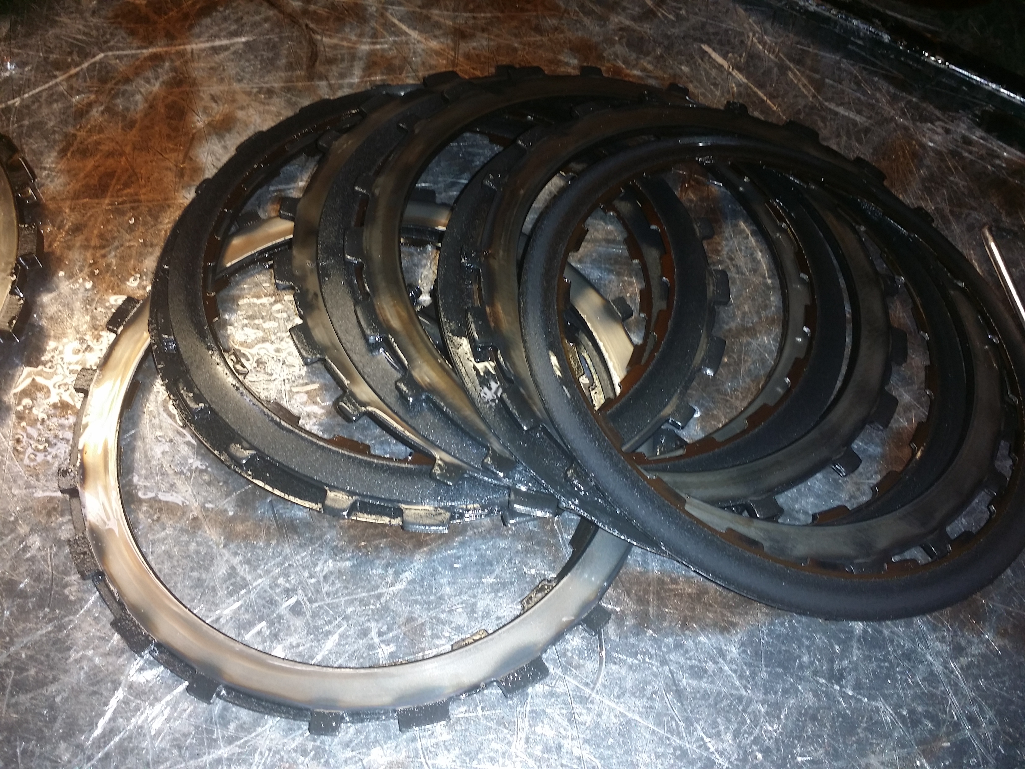

So as it turned out my tranny decided it was tired. The delayed up shift was caused by a dirty pressure control solenoid which in turn was caused by the 3 4 clutch pack being burned out.

by DirtyBacon04 » Thu Oct 22, 2015 2:19 pm
Sounds like what happened to mine. Dont suppose you had to drive 350 miles in 2nd gear though...
by TheHungriGerman » Thu Oct 22, 2015 2:24 pm
Ha I wish I could. Once I lost the clutch I lost the pressure control solenoid so at that point I lost every gear. Including reverse

by KingBird » Thu Oct 22, 2015 4:41 pm
Damn... Stuck like Chuck. Glad you got it fixed, did you end up installing a Corvette servo anyway?

by TheHungriGerman » Thu Oct 22, 2015 5:33 pm
It will be going into the tranny while it is being rebuilt
