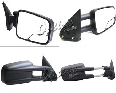

by Dirtyd » Wed Jun 27, 2012 1:08 am
LOVE IT!
Would Silverado extended mirrors like these work the same?

by RimoniManu » Thu Jul 26, 2012 1:35 am
Sorry I havent been on here for a while; Dirty the install would be very similar. You'd just have to measure the bolt holes and drill a hole or two and then rewire if they're electric.
