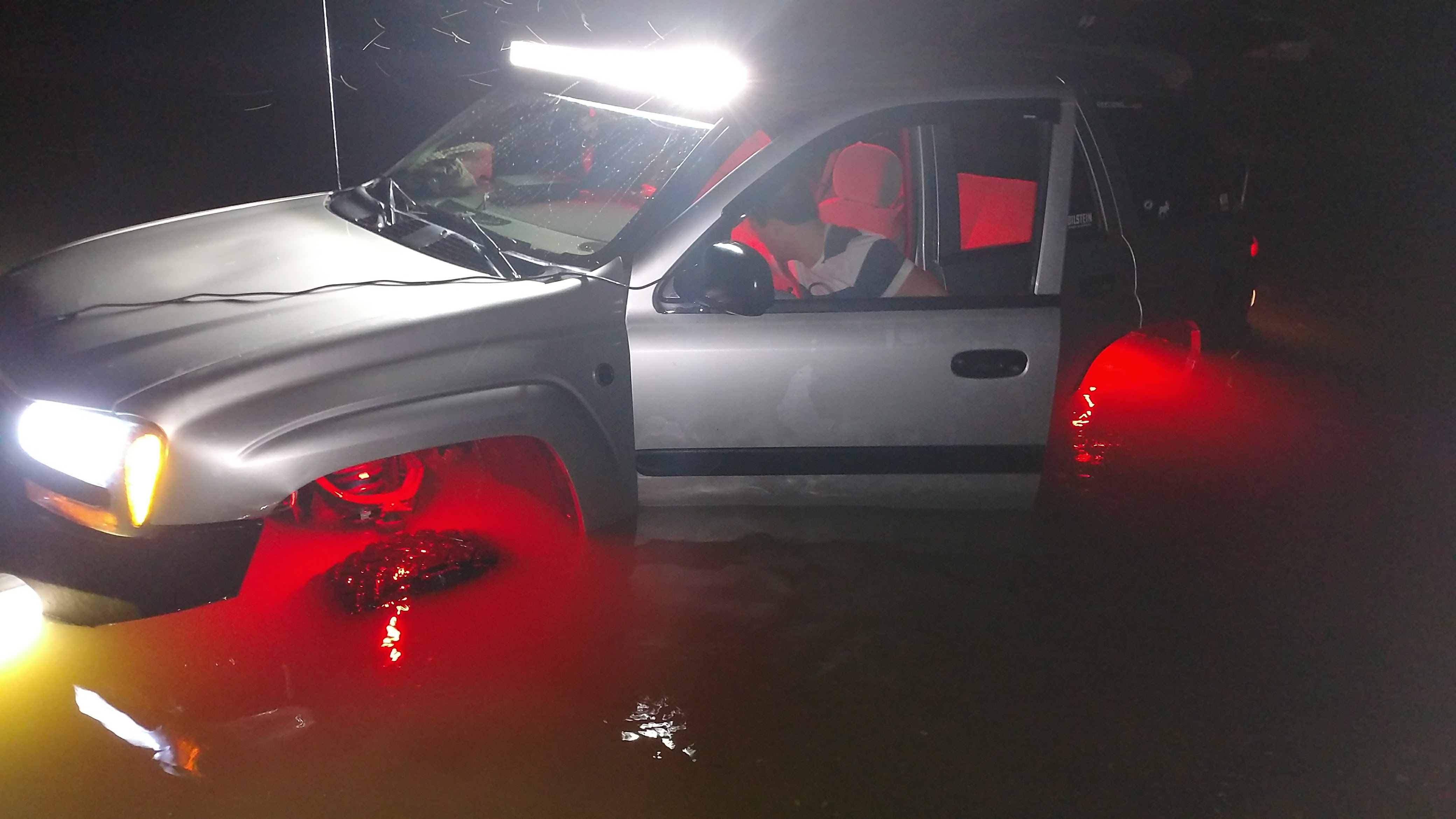

Hey everyone, had a bit of an adventurous night last night. Made an absolutely horrendous rookie mistake. Was doing a little trailing down by a local river, and parked and hung out for a few hours until dark. About 9pm decided to head home, accidentally took the wrong trail and dove headfirst into what I THOUGHT was another water hole I had already driven through on the way in. Water was waist deep, obviously not the same water hole. Engine died pretty much as soon as the truck hit the water. My first instinct was to reach up and turn the key to shut it off, but I forgot to pull into neutral first to unlock the ignition so I was too late. I jumped out and hooked the winch to the nearest tree and pulled it out as quick as I could. Water flooded the entire cabin by a couple of inches, soaked the BCM and everything in the truck started going haywire. Windows rolling up and down, doors locking and unlocking, lights flashing, beeps beeping, the whole shebang. After I winched it out of the water I went ahead and pulled the intake off (full of water) and tried to crank it. Absolute no-go. I can hear the starter and I know for sure it's trying to crank like it's supposed to, but the pistons aren't even attempting to budge. Just the click of the starter engaging. Got my dads Tundra out there with the towbar we use to pull the TB behind our RV to get it back home. Got it in the garage and pulled both batteries off and shop-vacced out the gallons of water in the floor by midnight.
My question is, does anybody have a good recommendation for what to do with the engine? I've heard of pulling spark plugs to release the water pressure and letting it crank the water out the top, but I'd trust members here before I'd trust the first thing I find on google. If worst comes to worst, I still have another (perfectly good but 200k mile) 4.2l in the parts TB at my house.
Here's the only pic I came home with. Was too busy getting it out to take any more. Was already winched halfway out when this pic was taken.

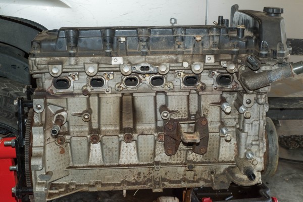

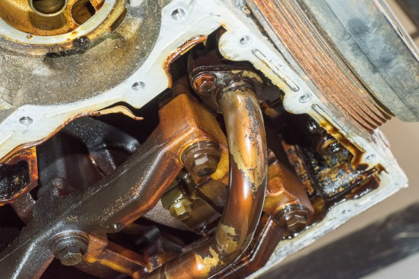

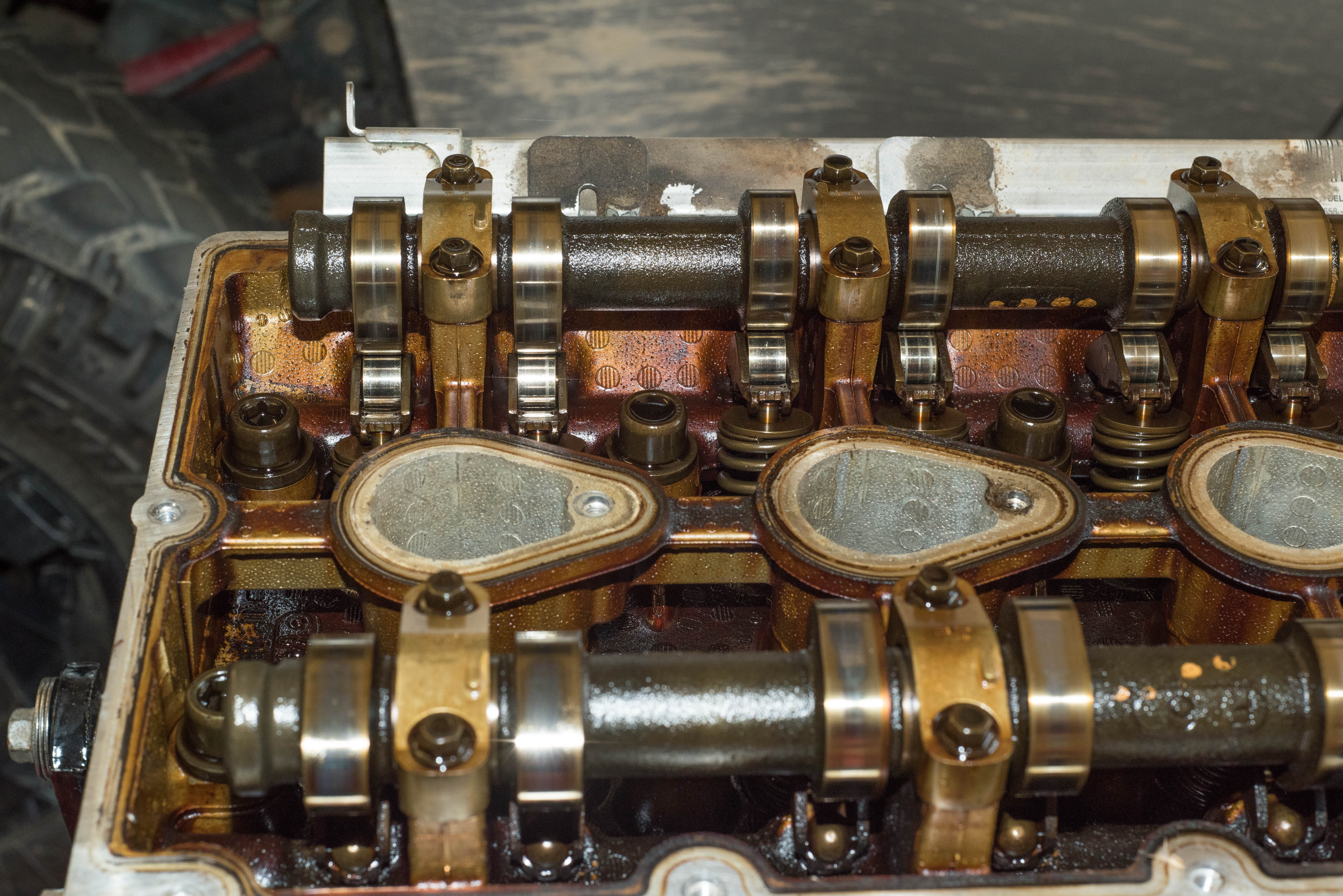

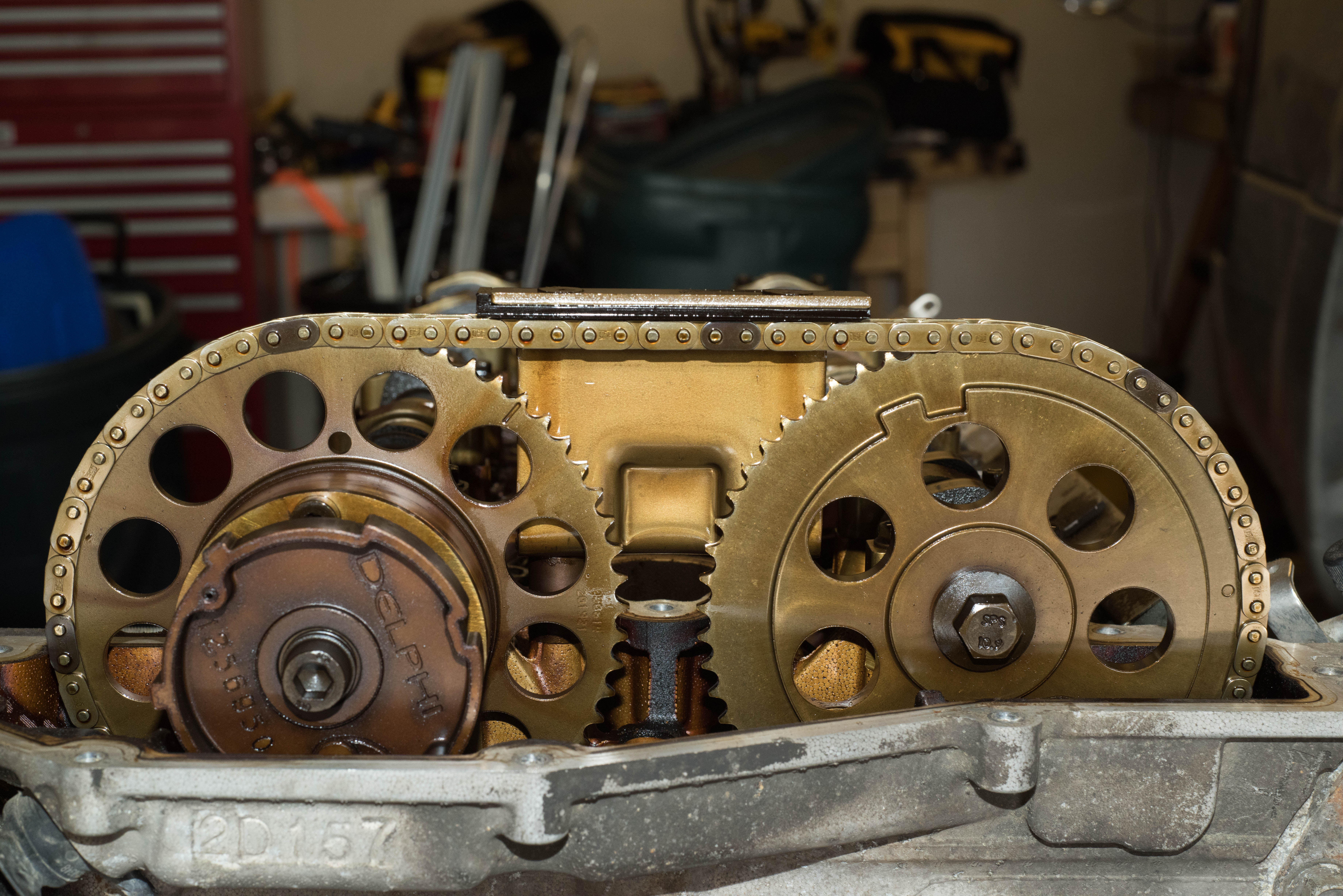

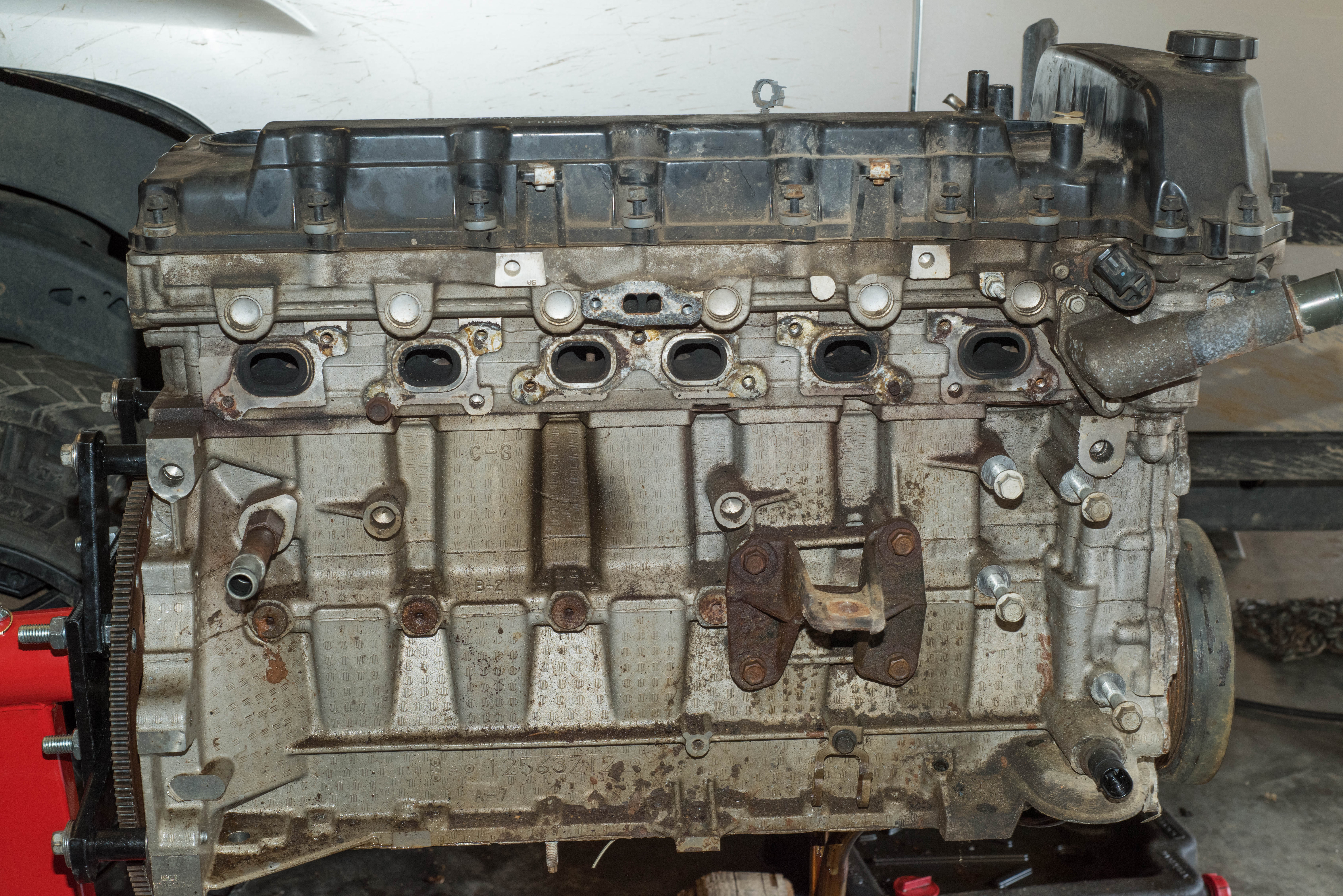

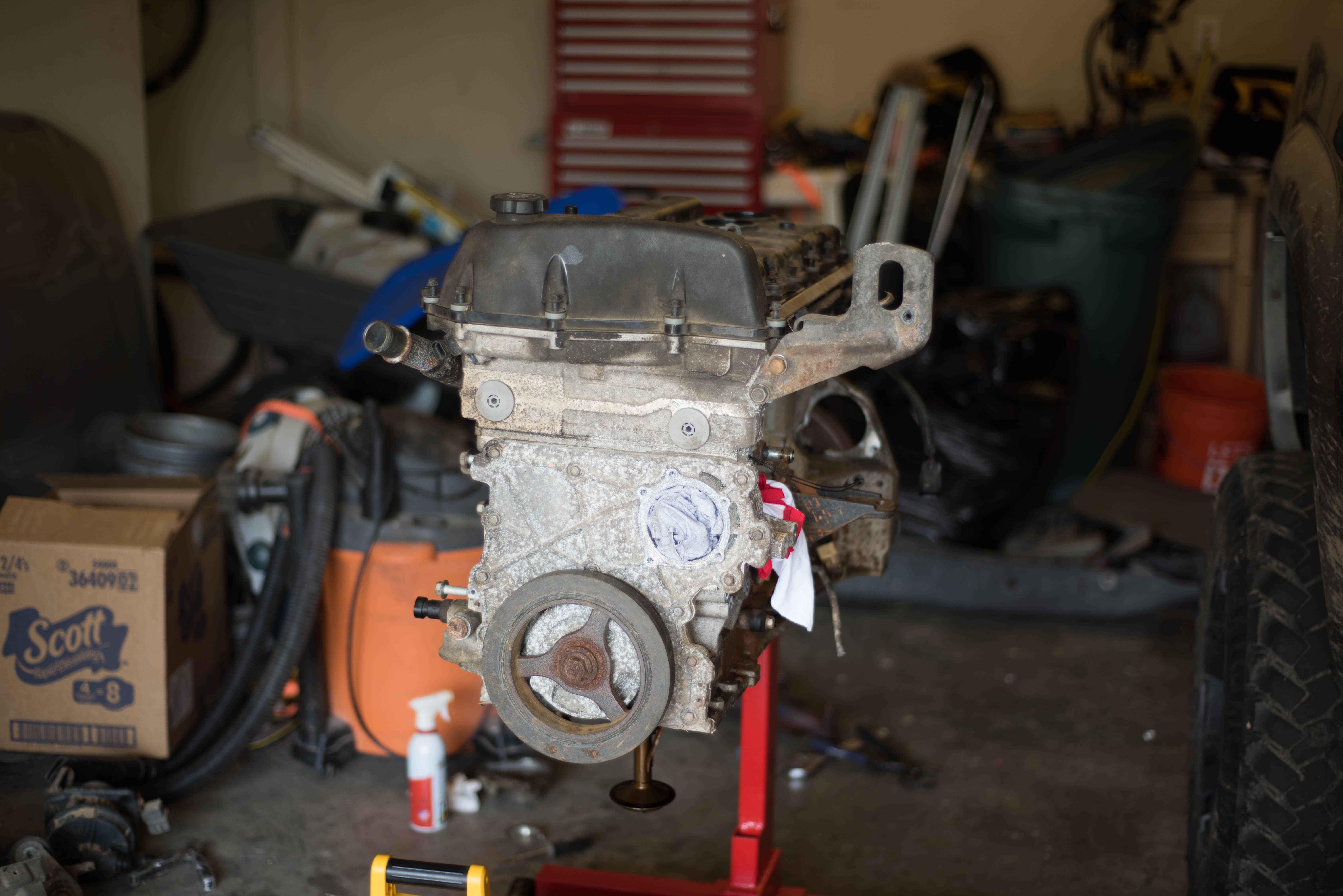

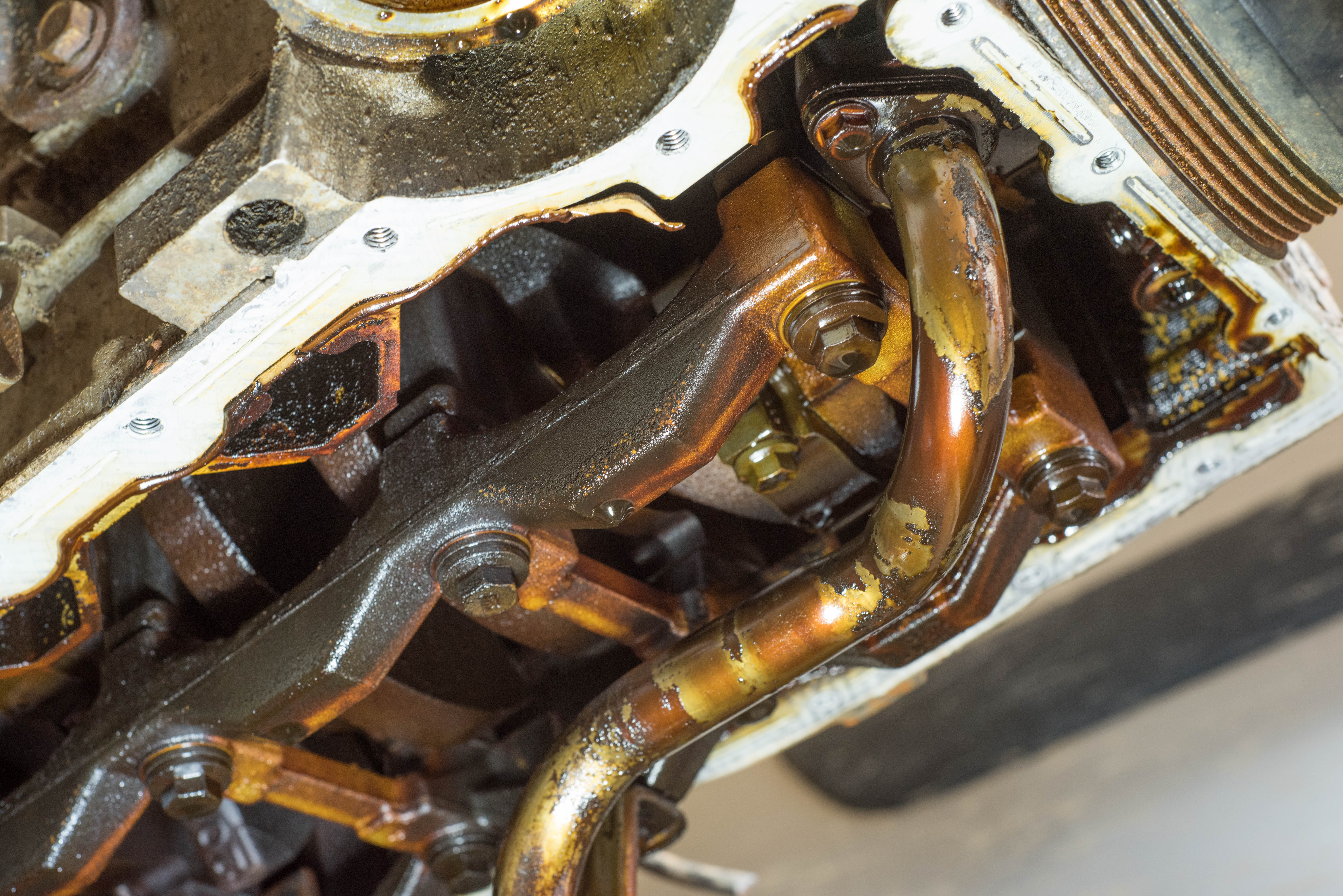

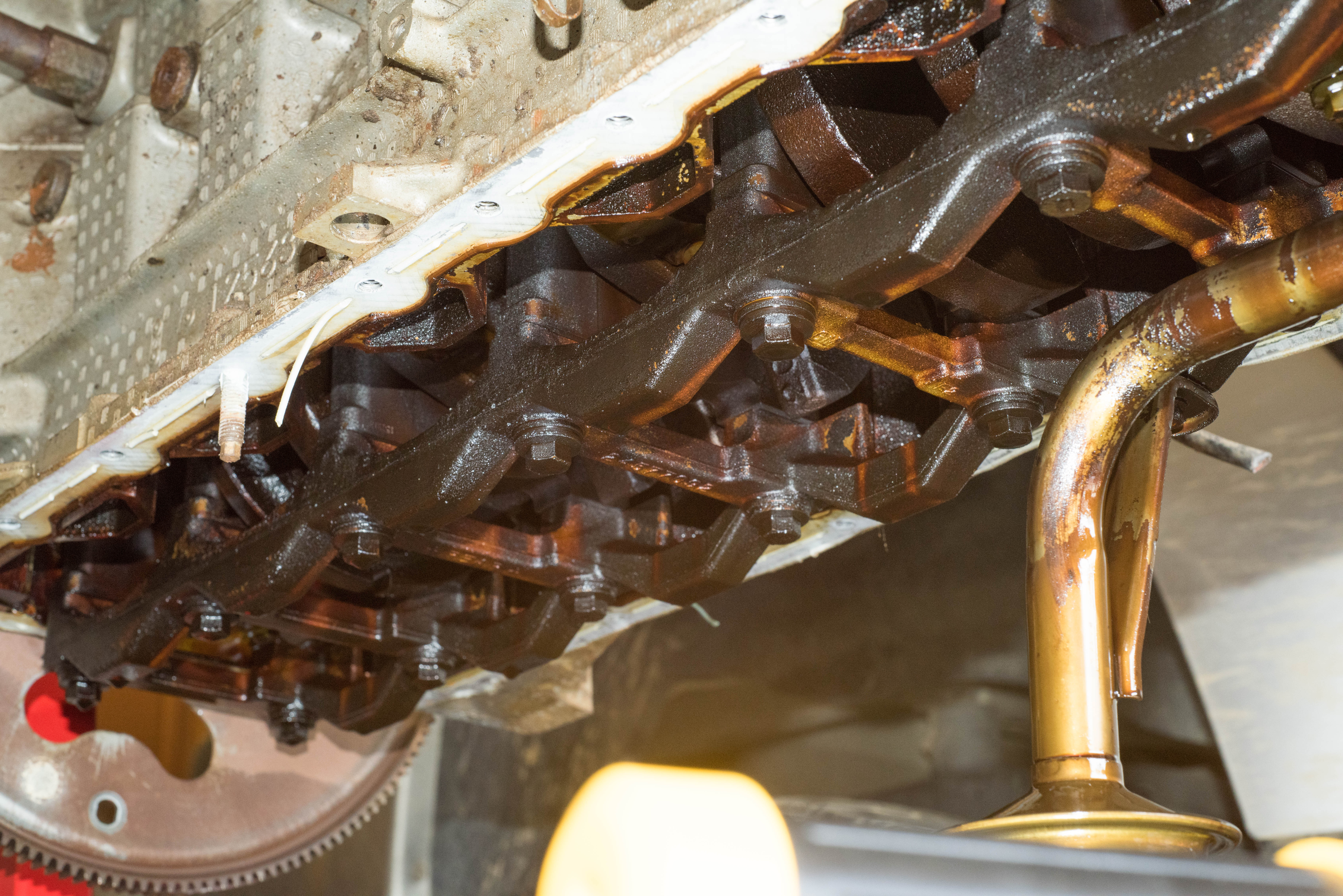

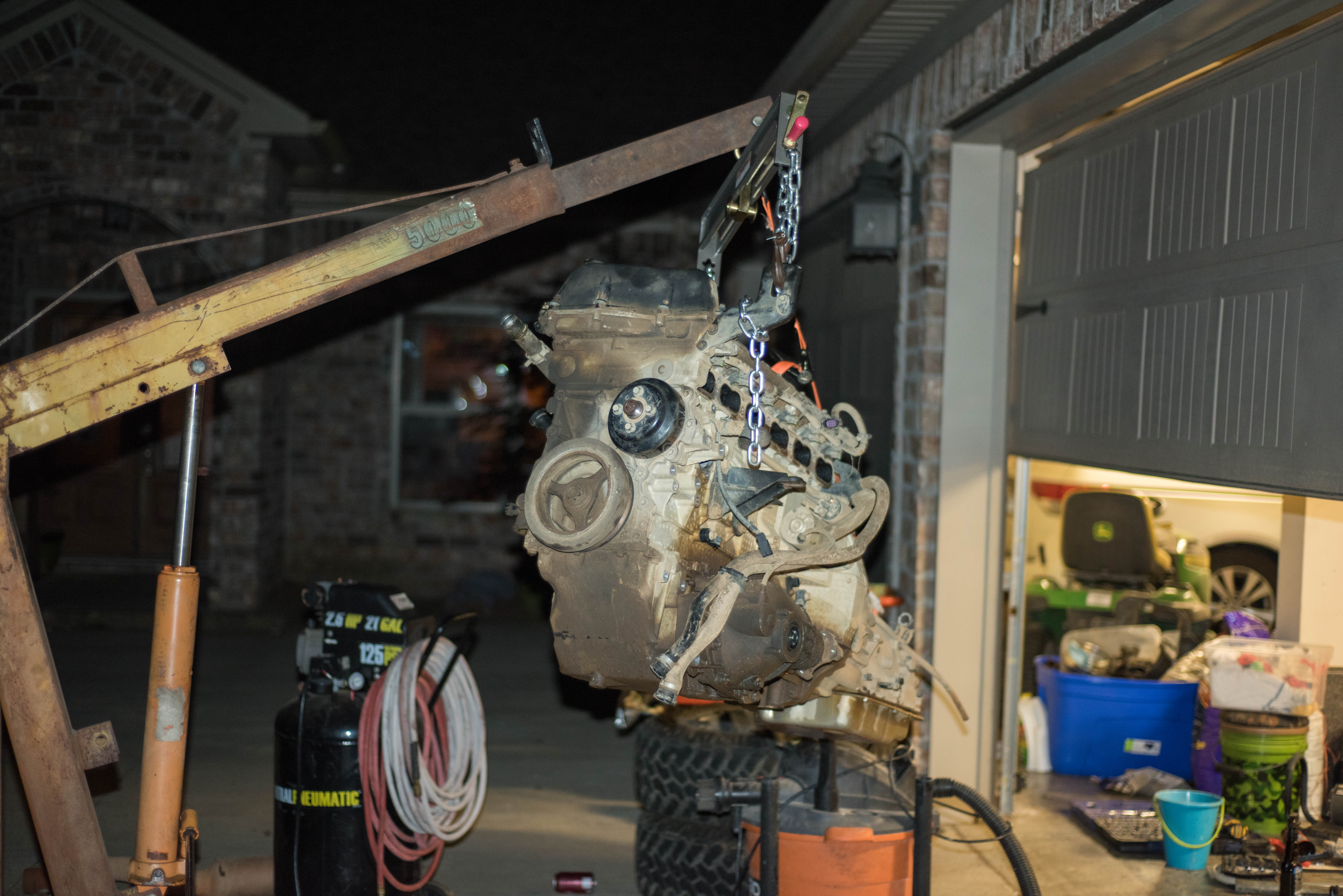

I've decided I'm going to use the motor in my parts truck as a direct swap in (after some routine inspection/maintenance of course). I pulled it out yesterday and got it set up on a stand, and took off the valve cover and the oilpan to take an initial peek. I'll attach some pics below. I'm currently pulling parts/pumps/wires off of the engine in the blazer and getting it ready to pull as well. I don't know alot about engines, especially servicing them, so as of now I don't really know what to do next with the motor I'm going to use. Gonna start alot of researching soon.

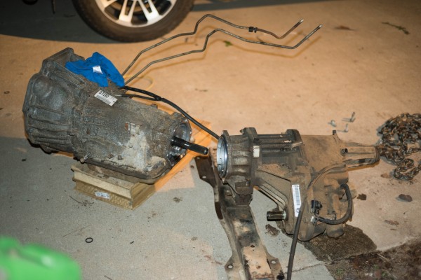

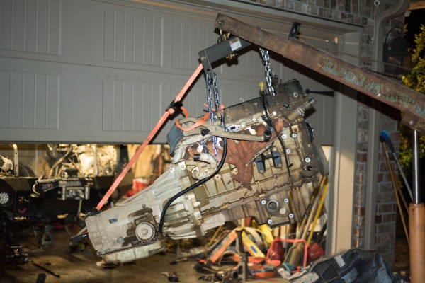

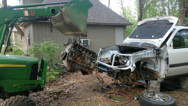

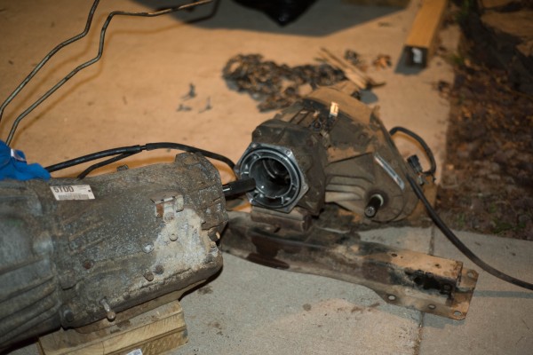

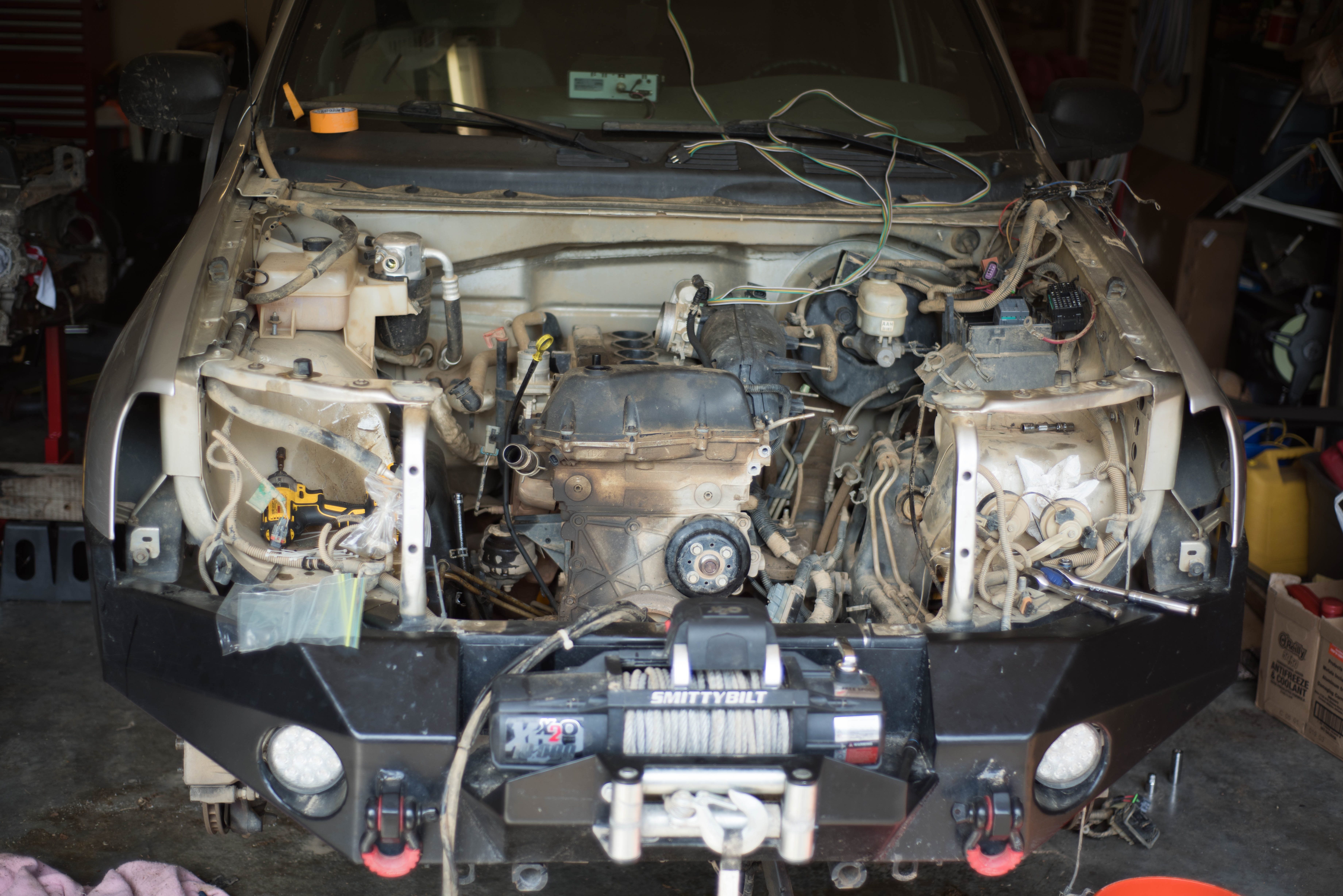

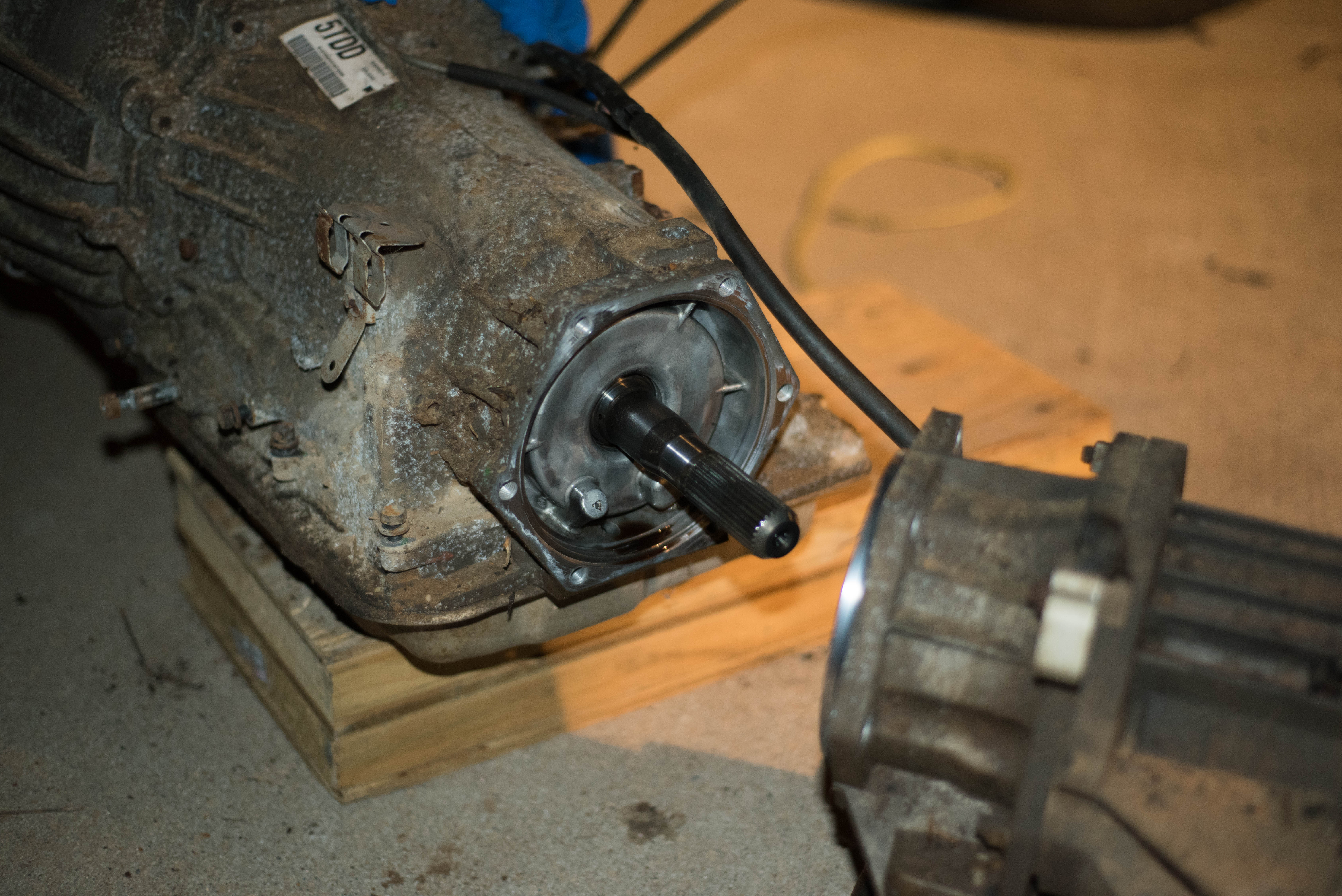

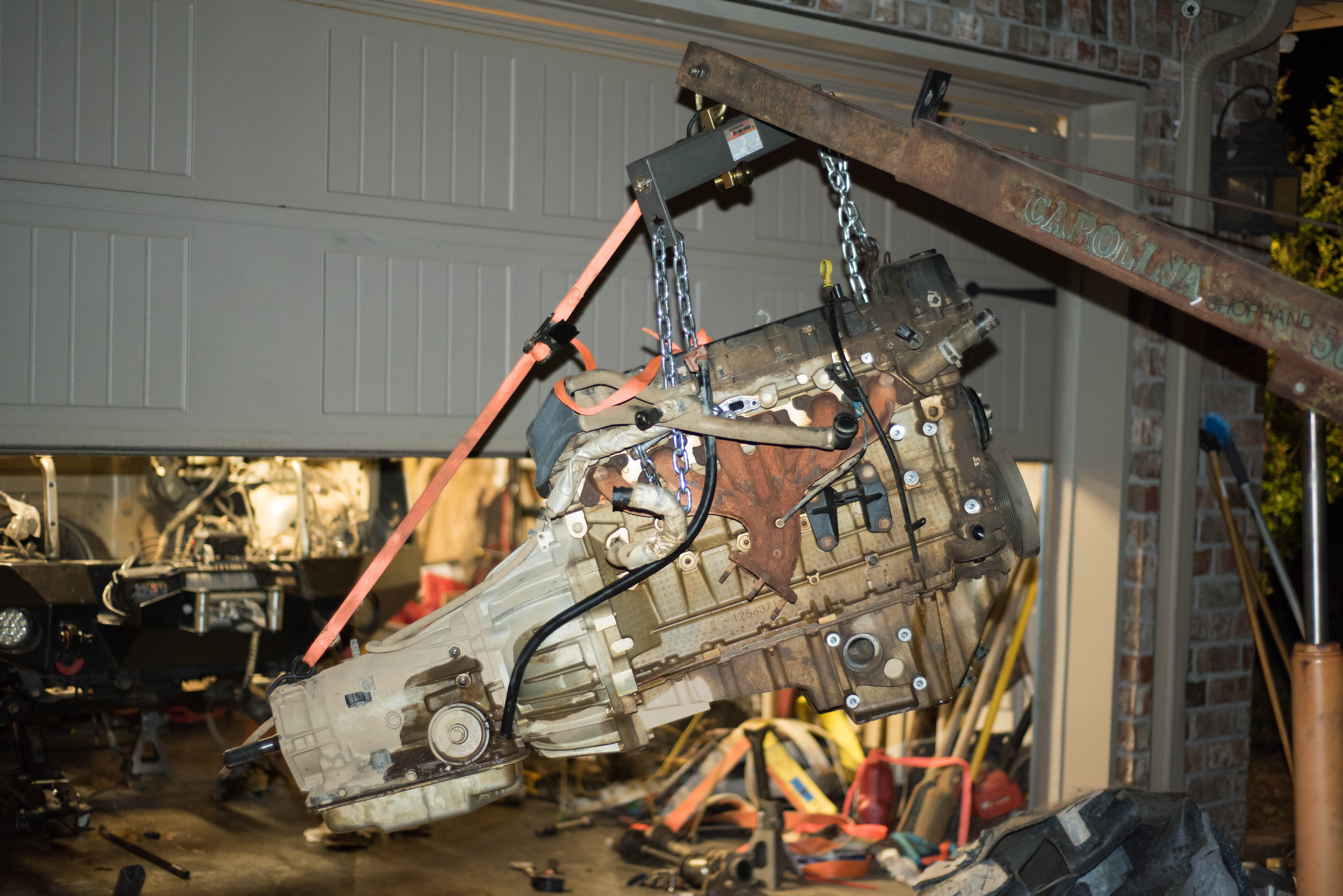

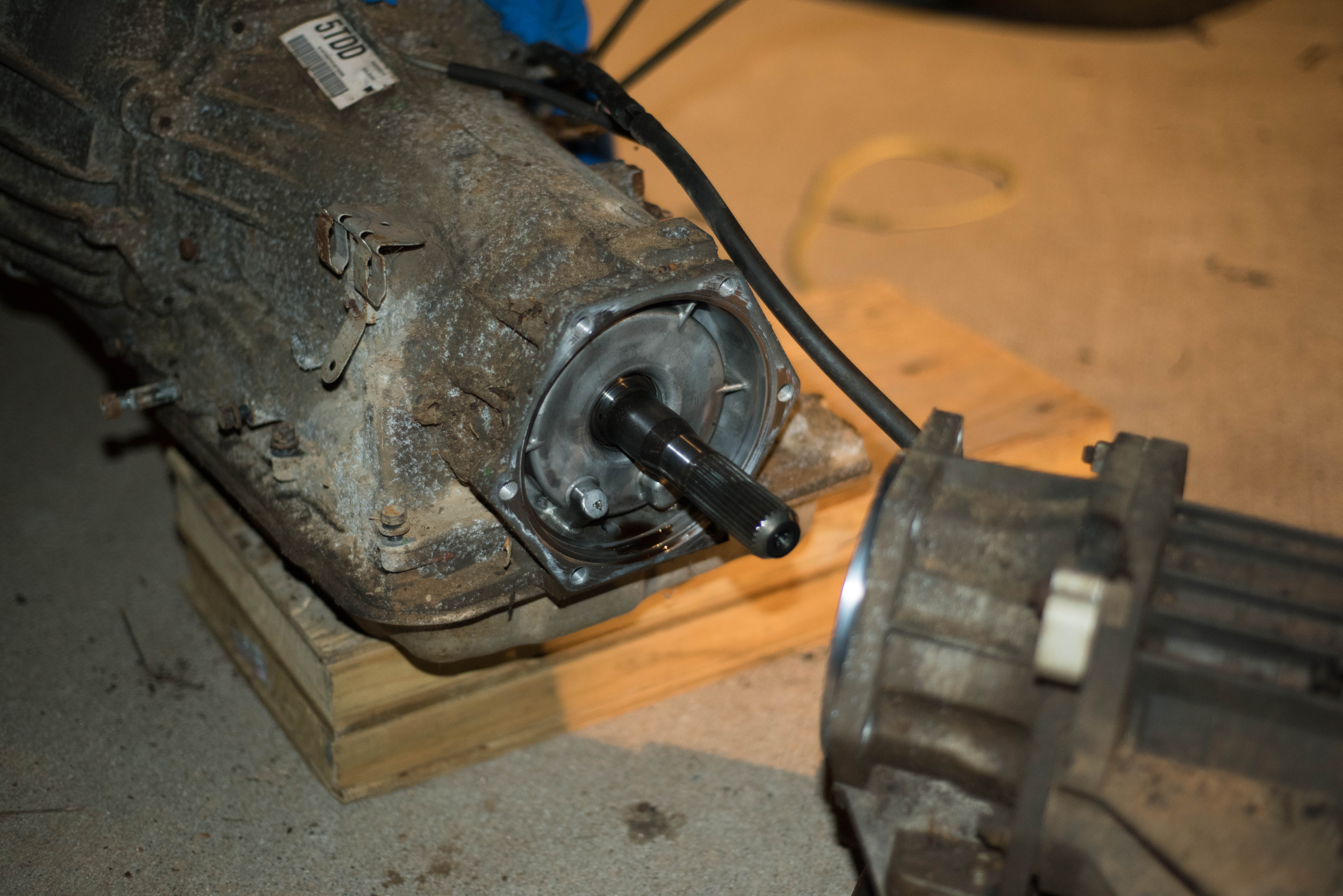

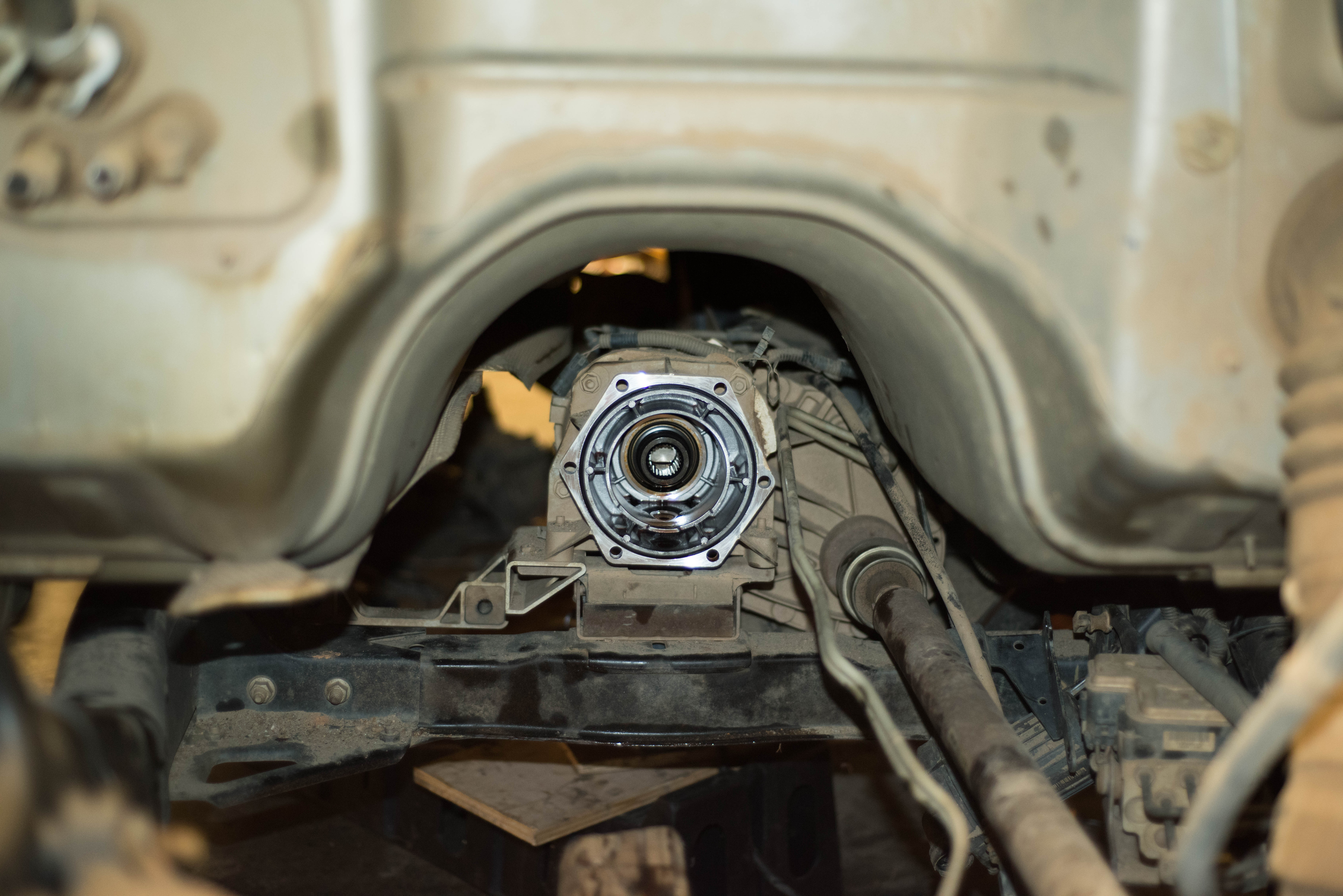

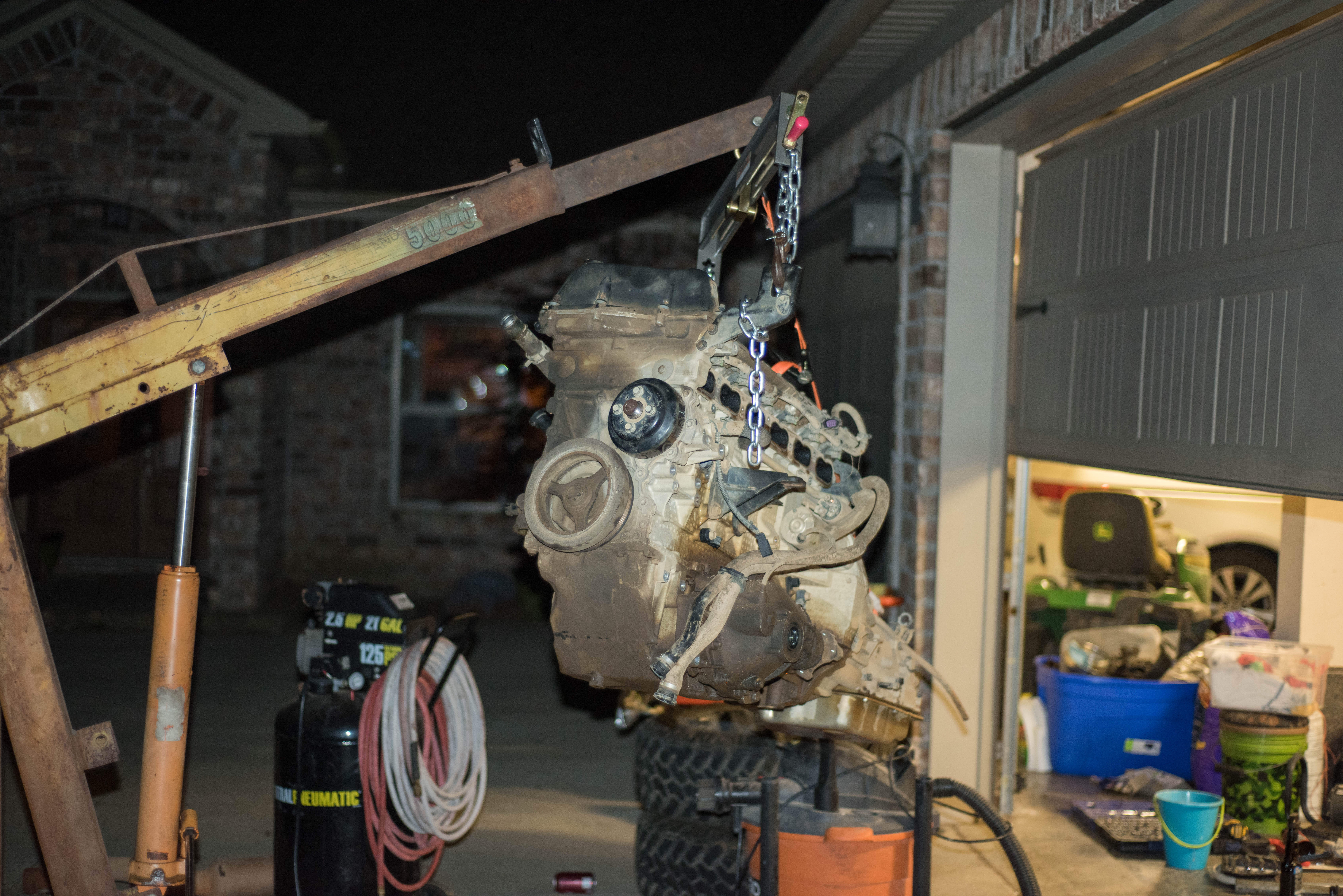

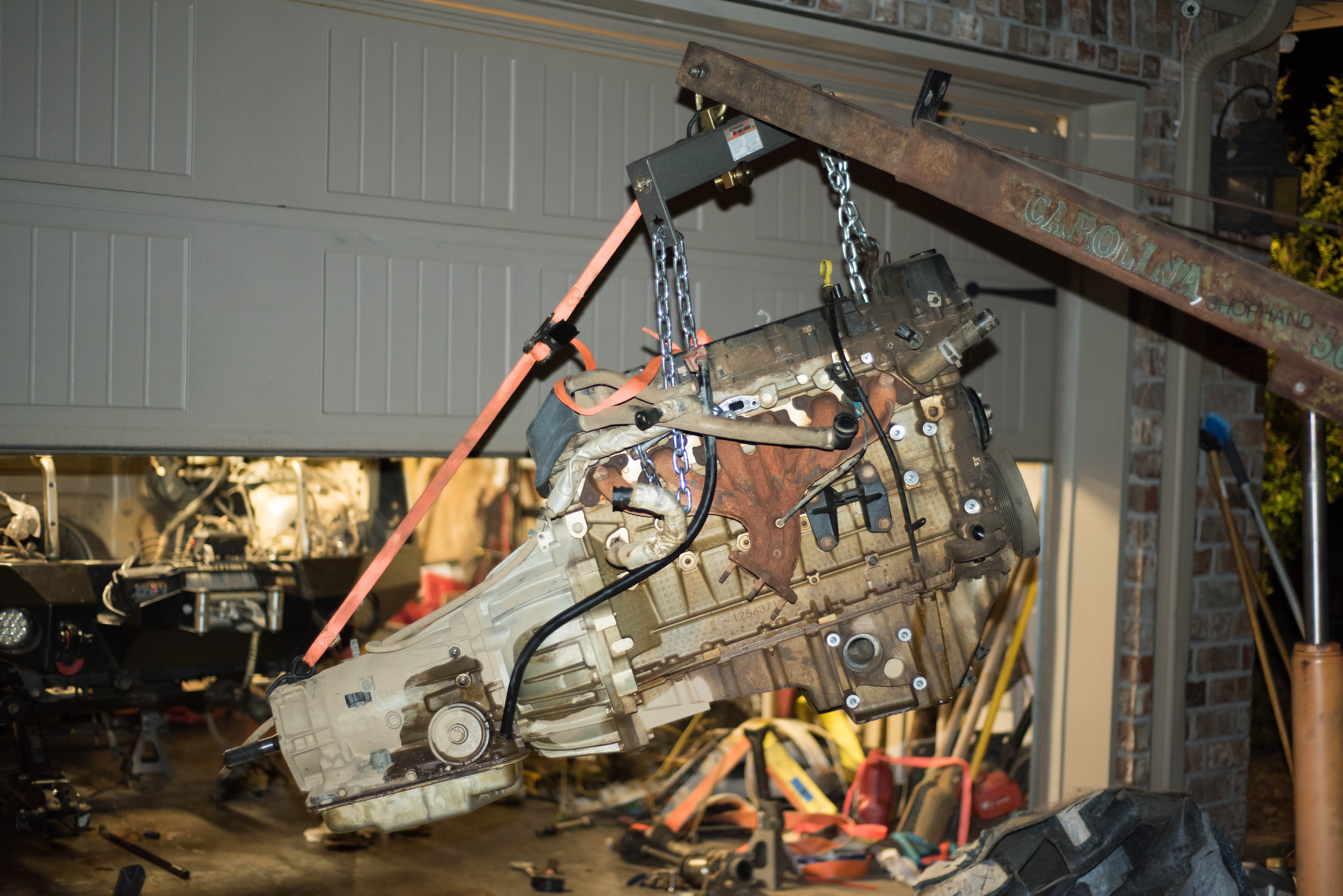

Alrighty. I got the blown motor out of the TB. I unbolted it between the transfer case adapter plate and the transmission and pulled the motor and the tranny as one piece. It's actually very easy. Just put a jack up under the tail-end of the transfer case to hold it up from tilting after breaking them loose.

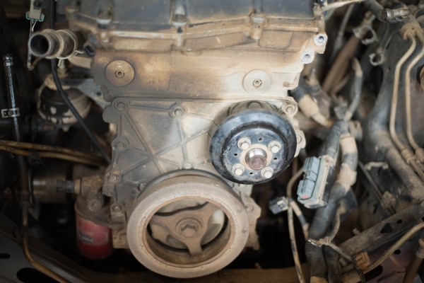

enginehang1
enginehang2
transfercase1
transmission1

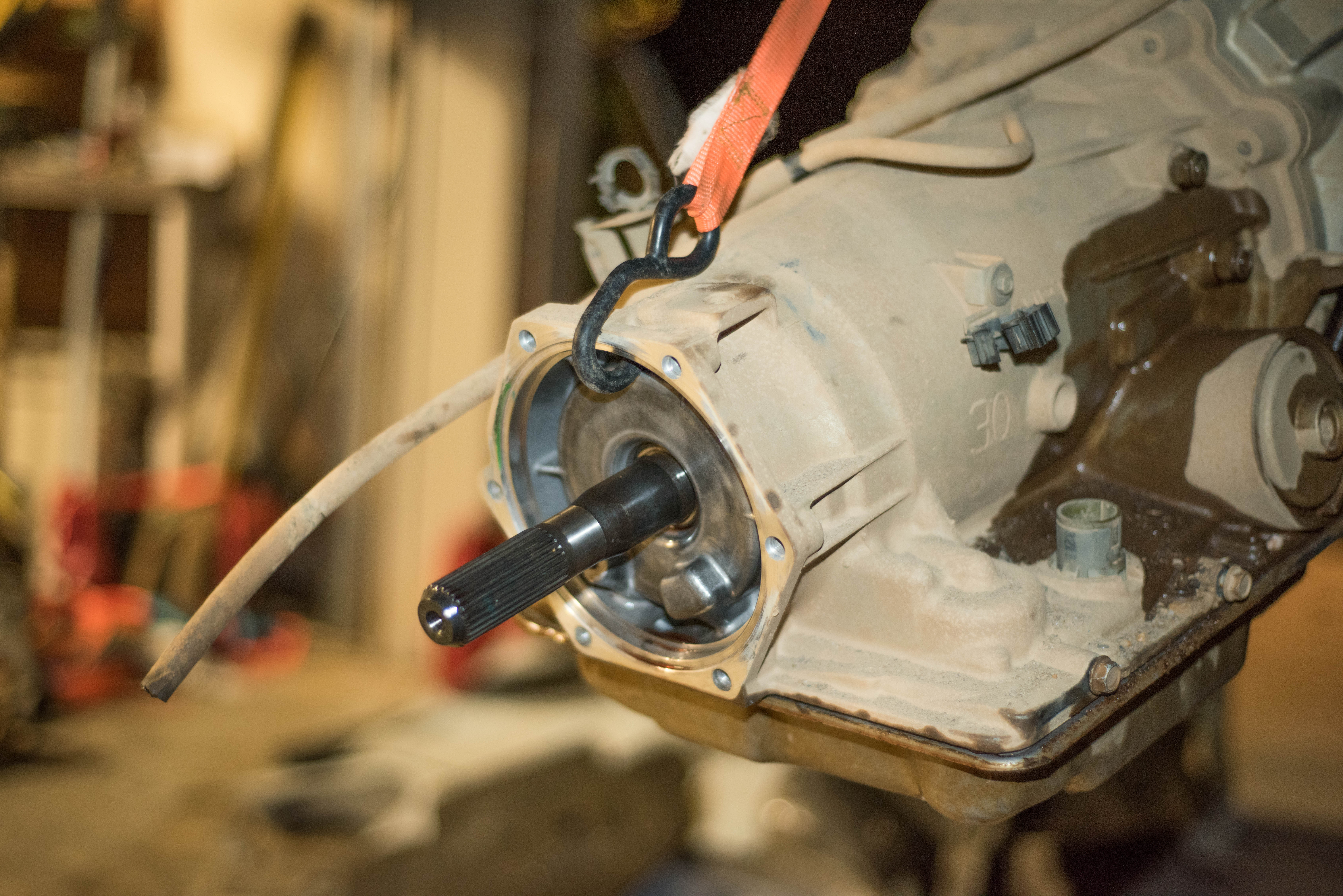

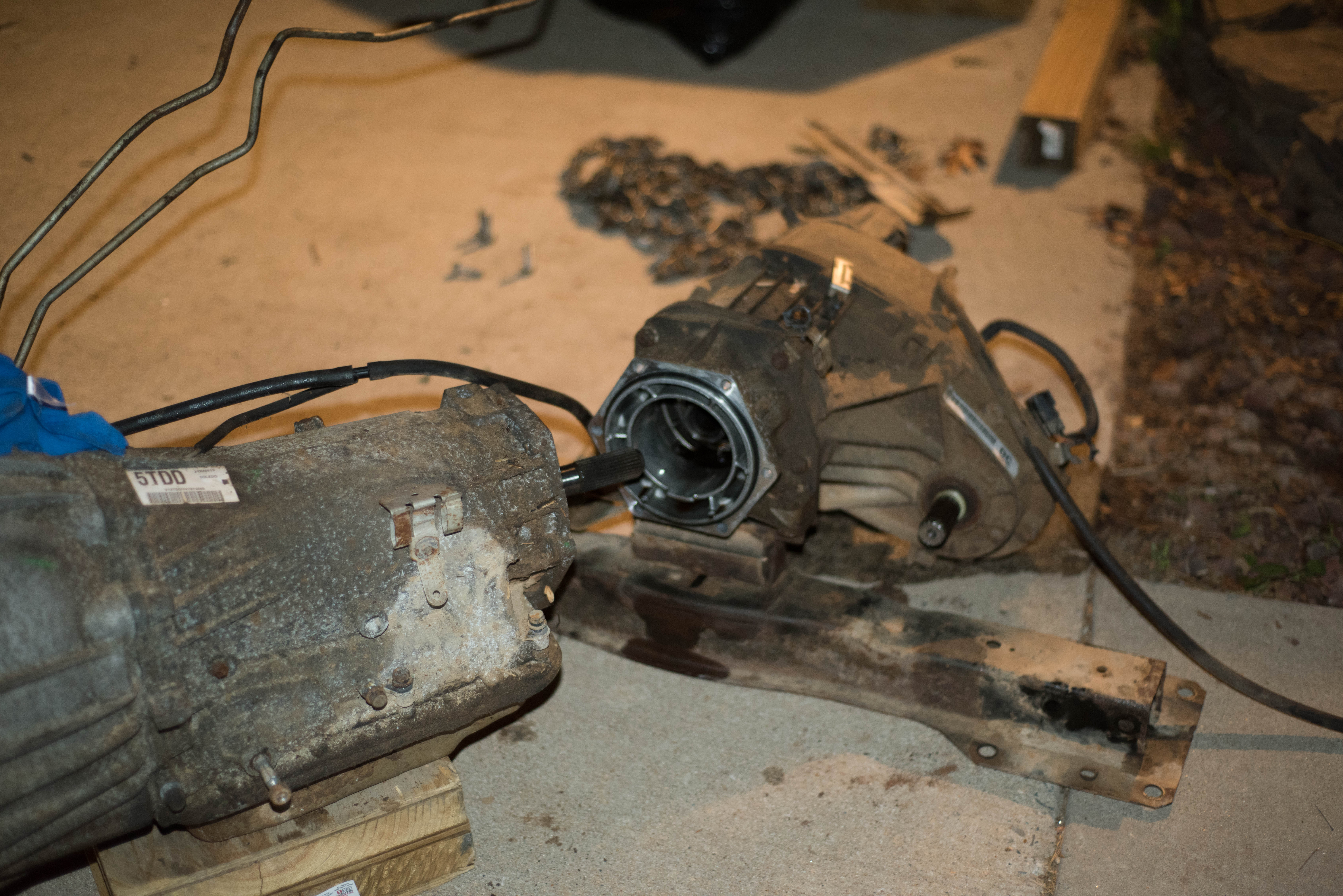

Also, here I've included pictures of the same procedure done to the transmission and transfer case out of the parts truck just in case somebody wants to see more of it.
partstruck1
partstruck2
partstruck3

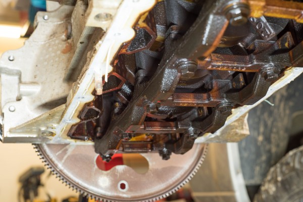

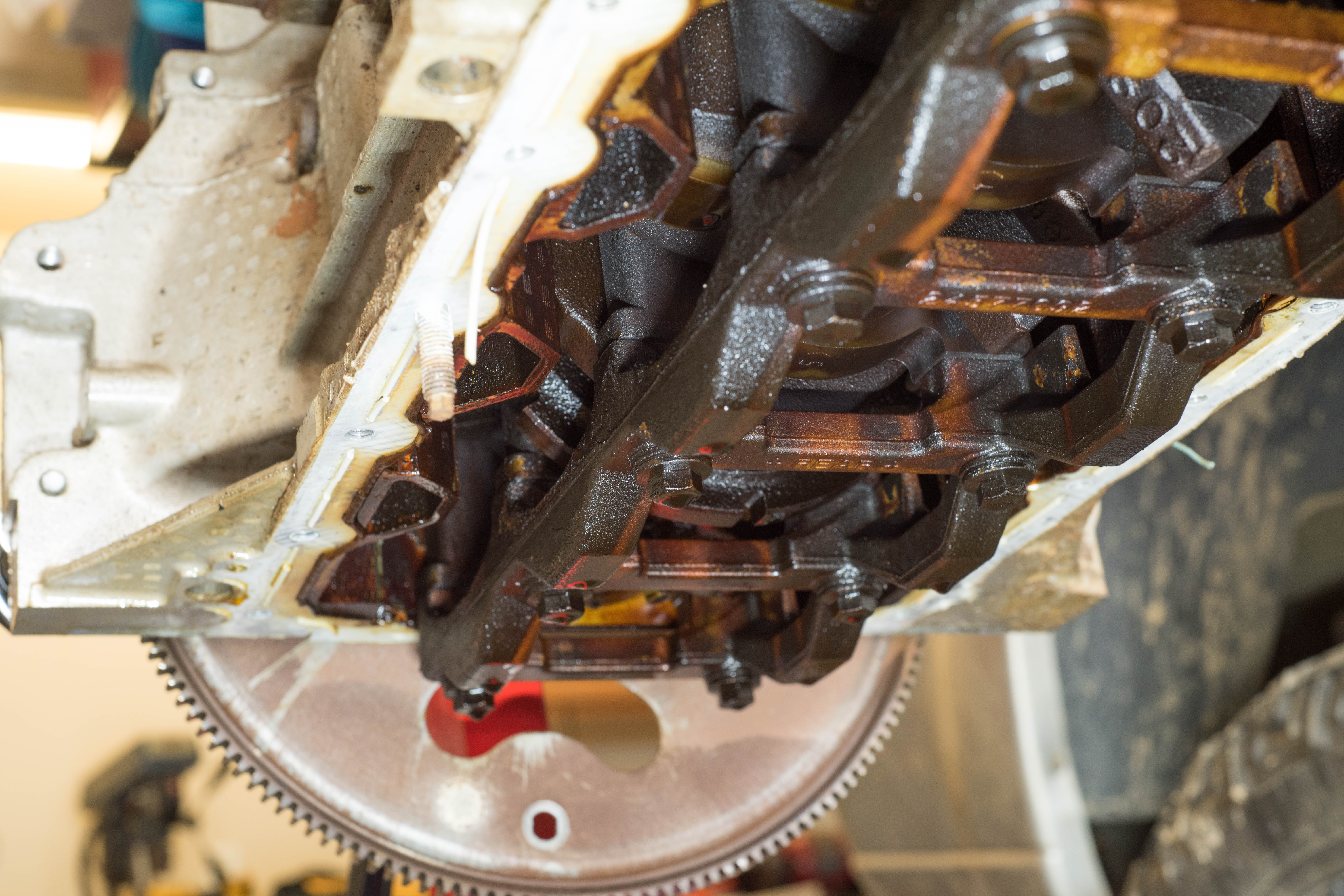

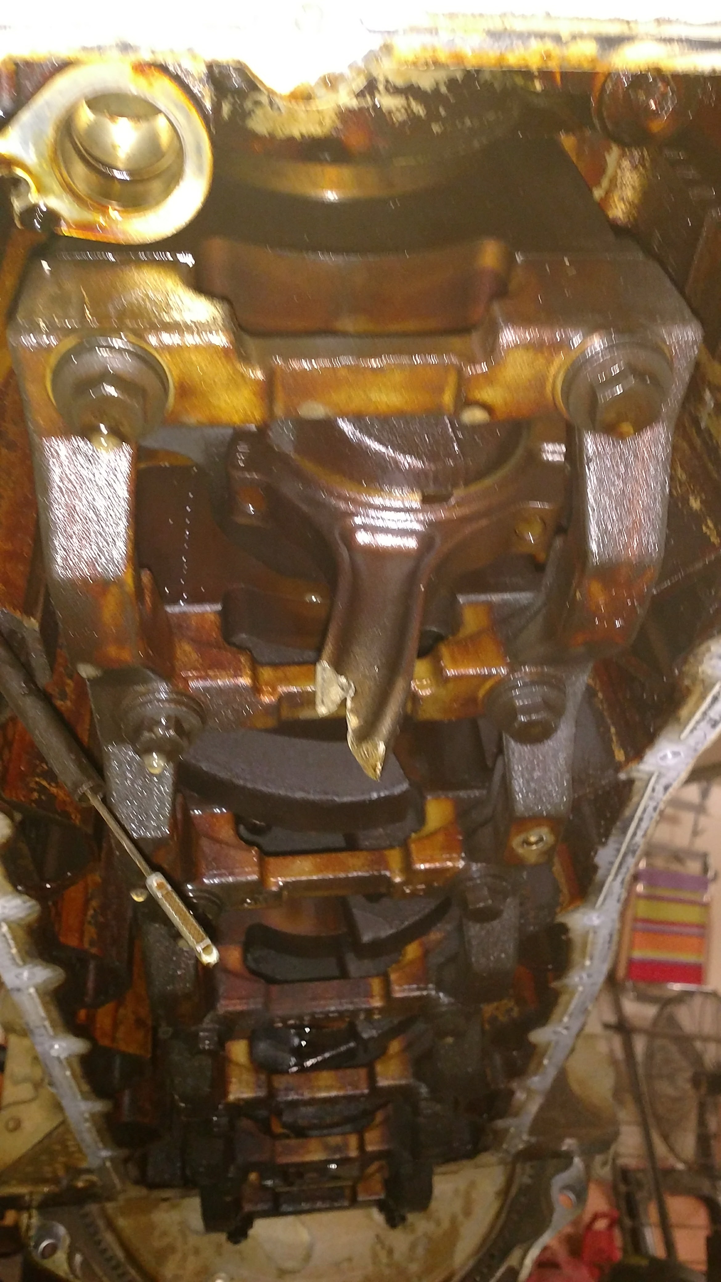

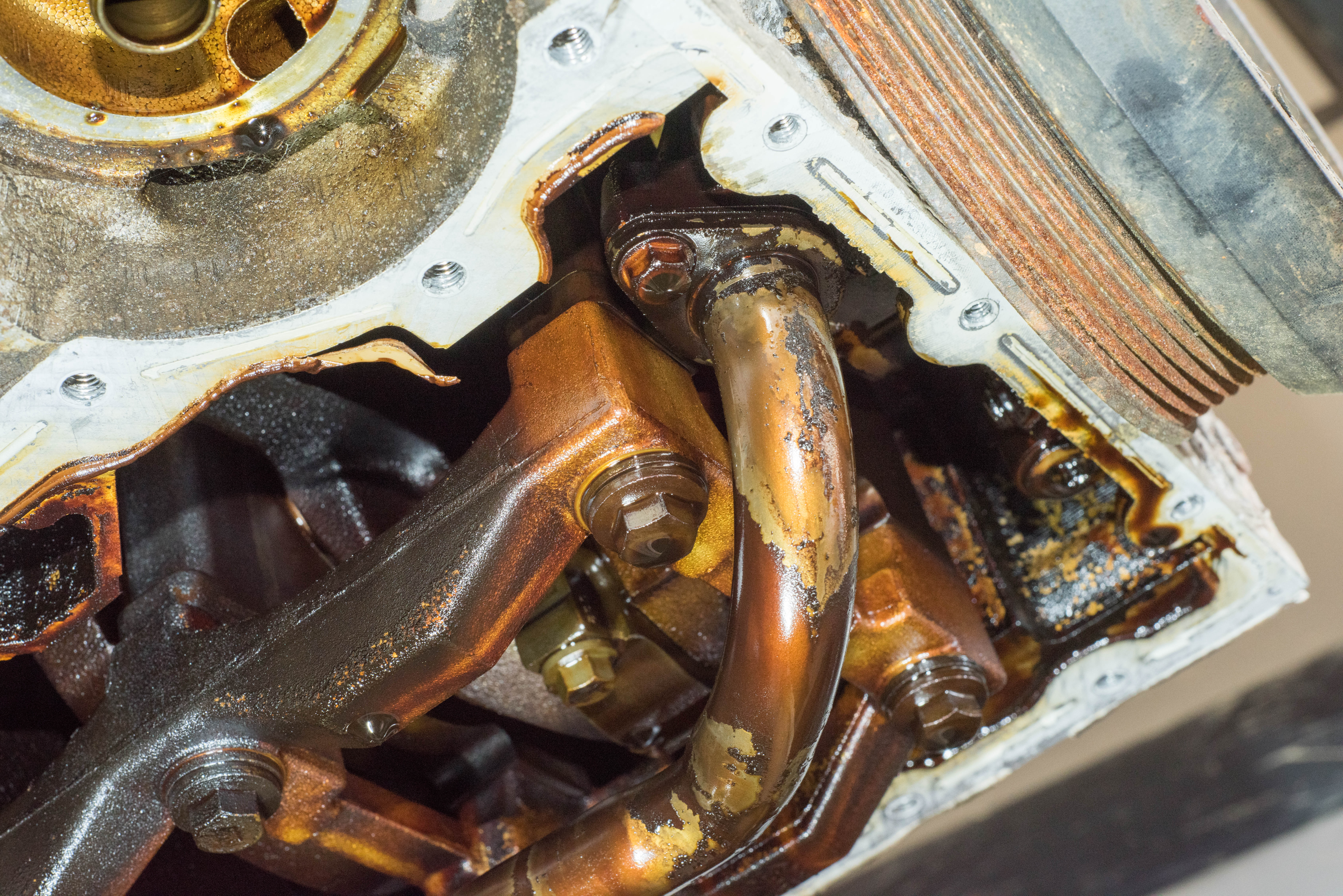

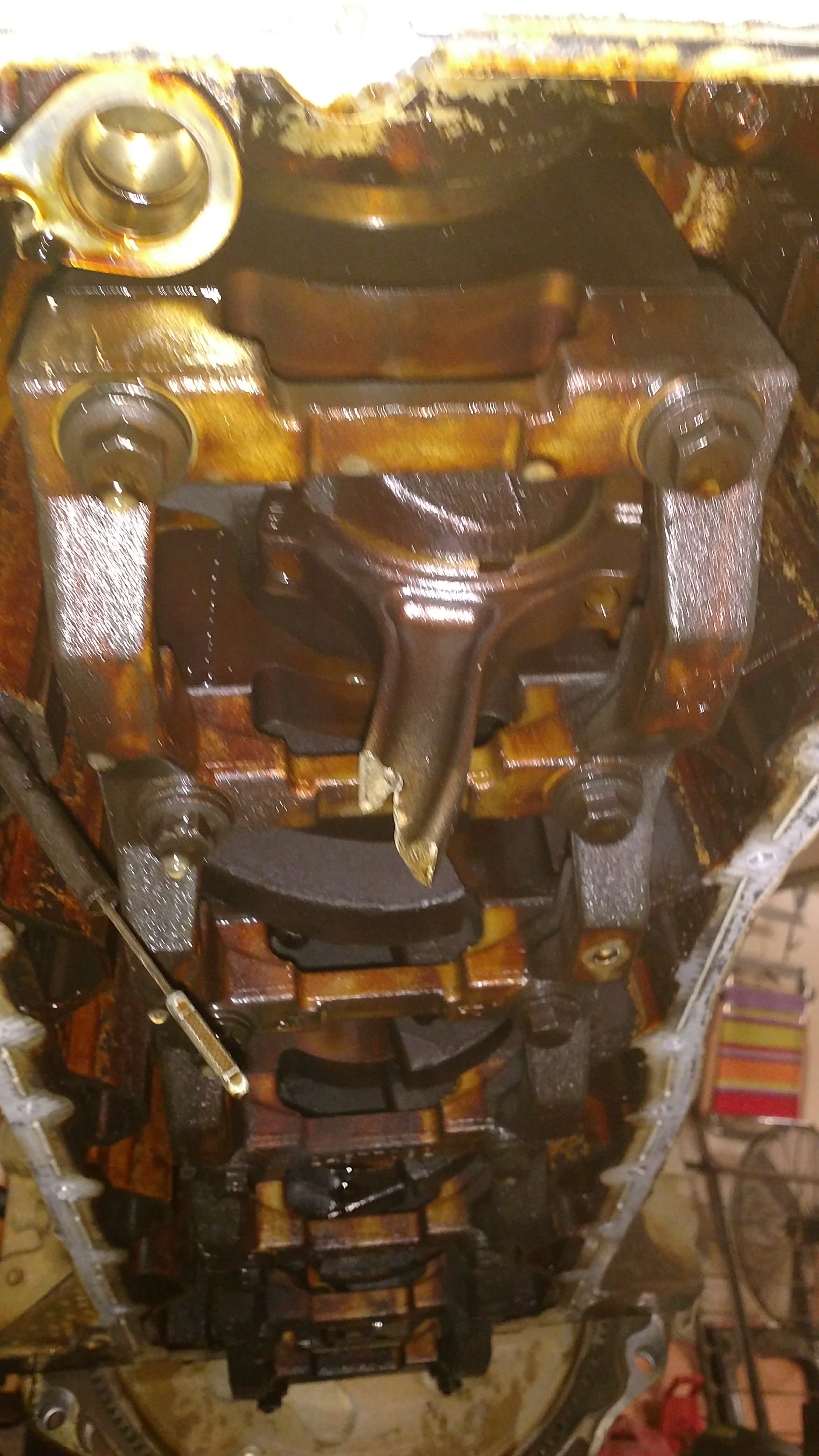

I took the oilpan off of the blown motor and found a broken rod hanging down on cyl 1, so theres our problem. I started swapping all the little metal clips and retainers from the blown engine over to the soon-to-be-used engine to replace all the rusty parts. I'm also ordering all sorts of sensors to replace whats on it now.
blownrod1

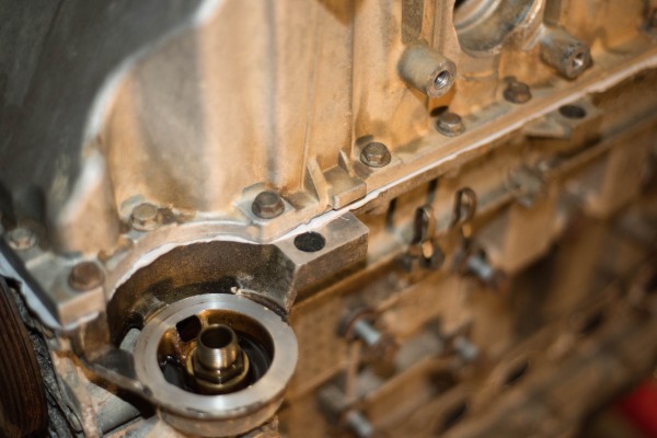

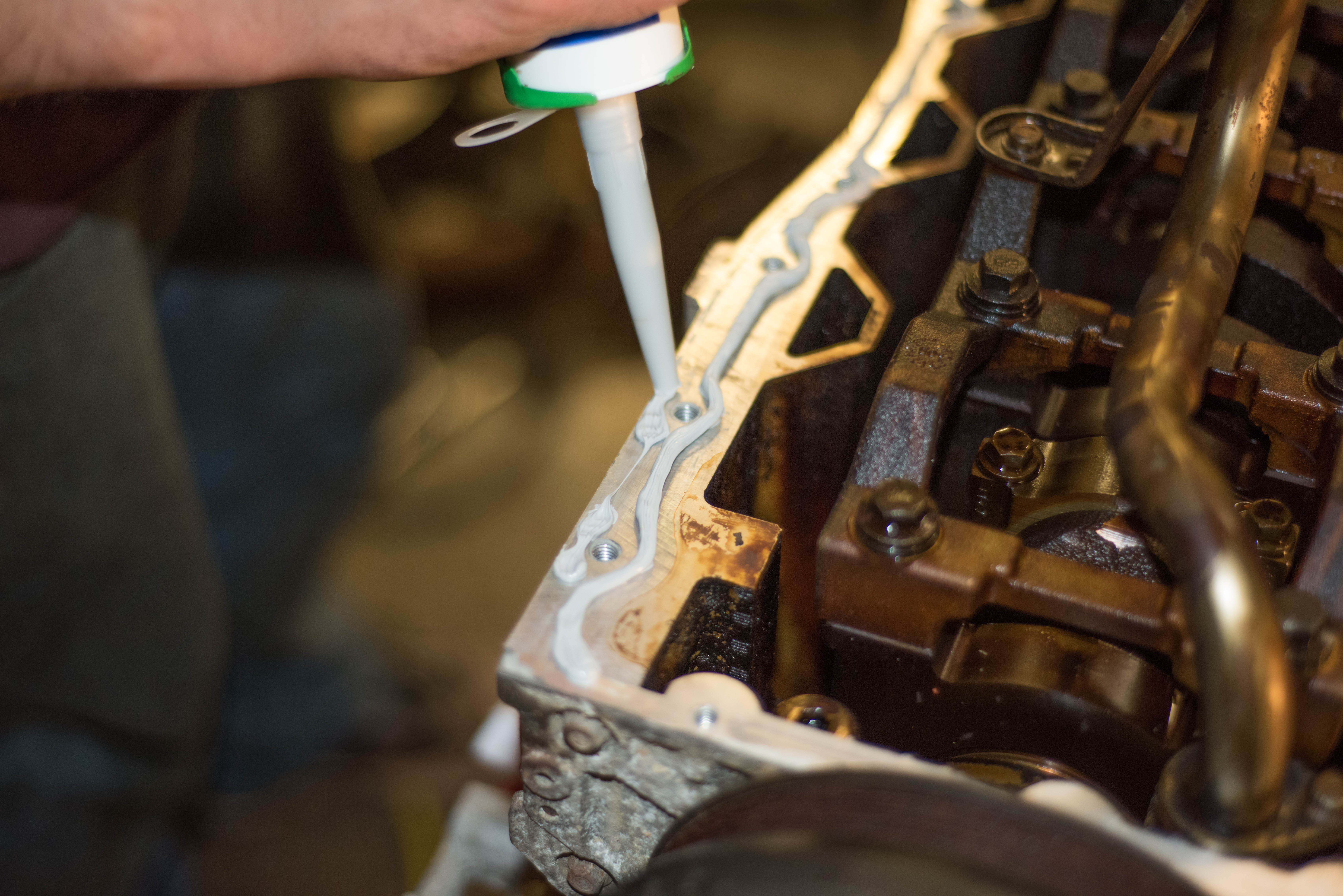

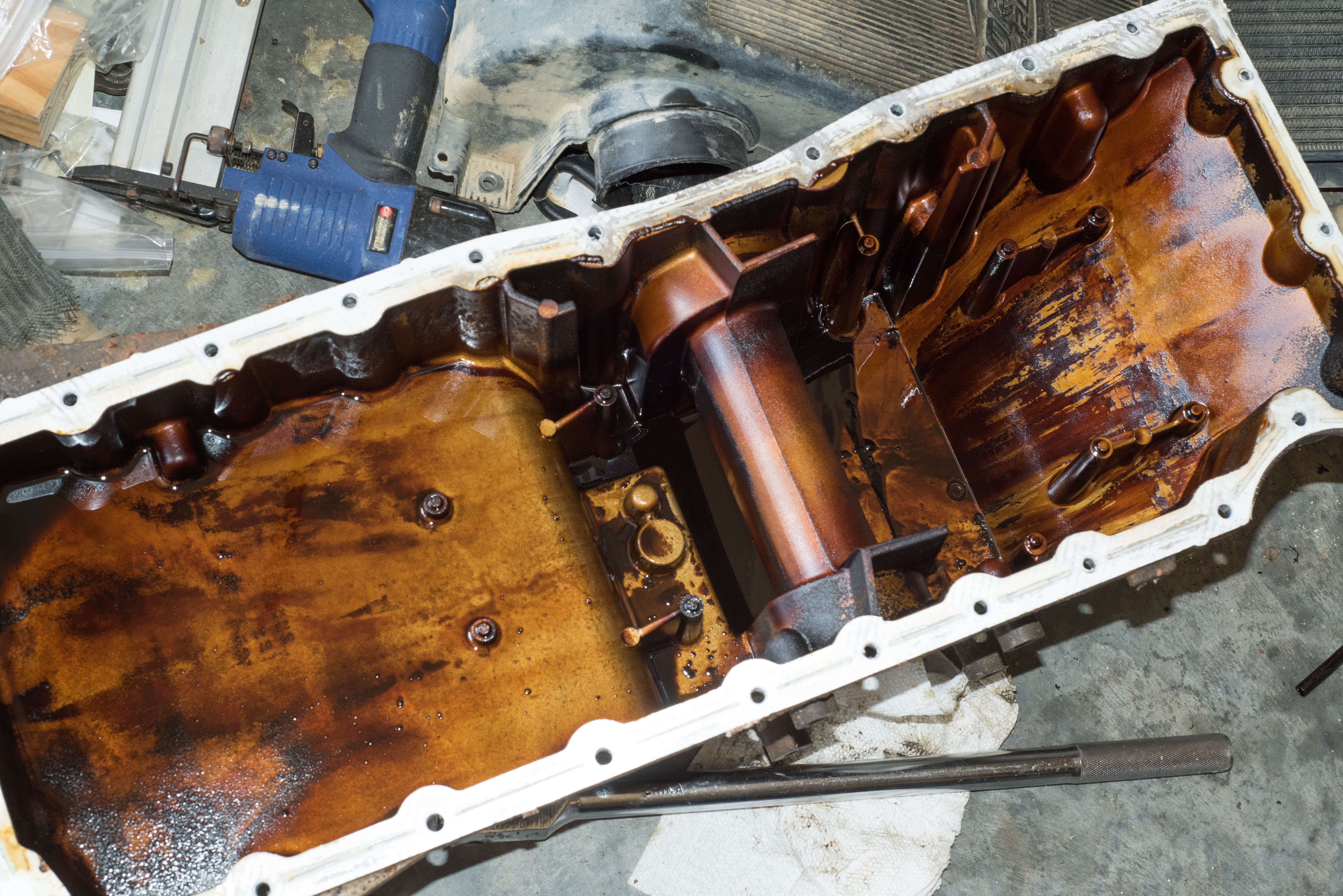

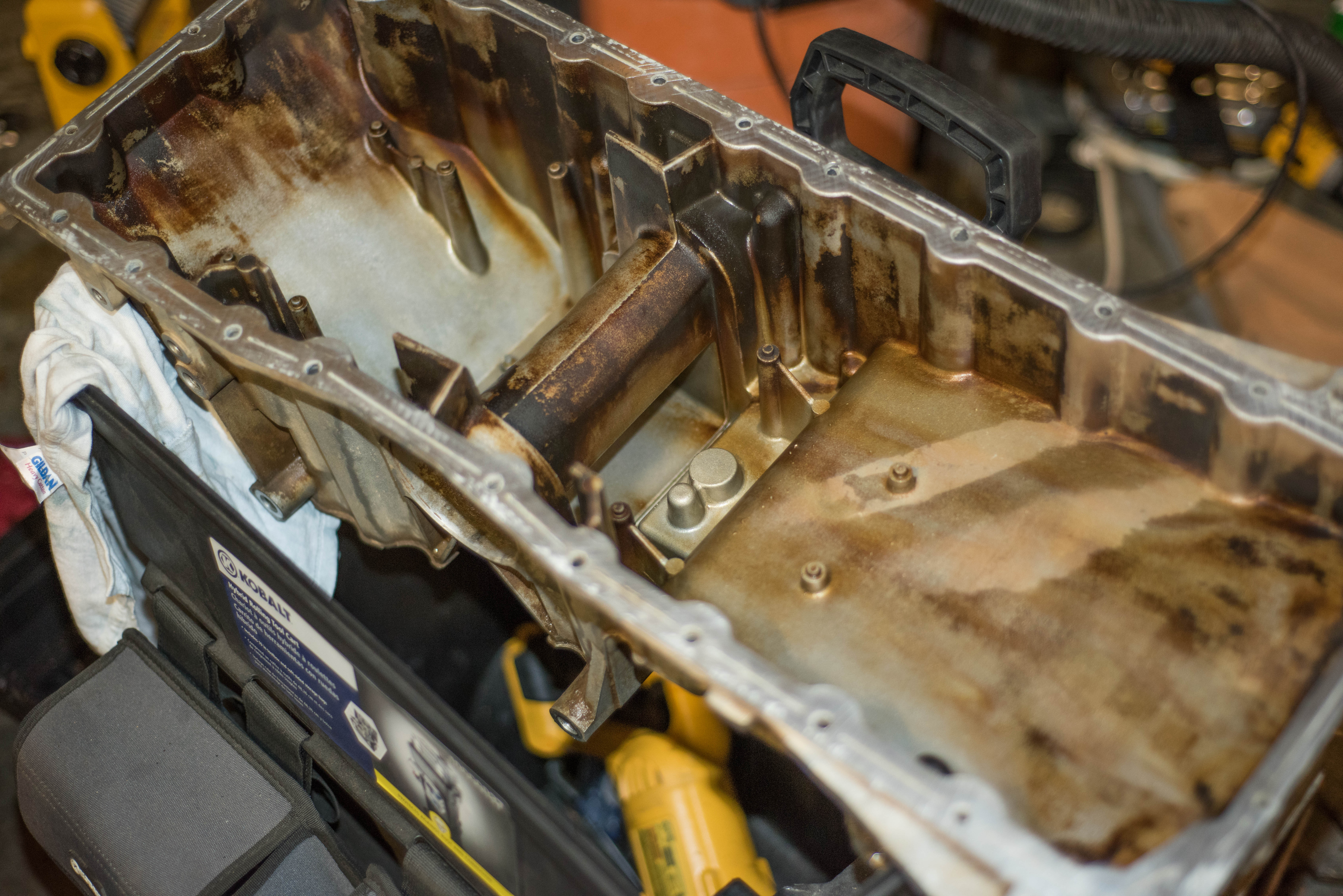

I cleaned out the oilpan for the old motor and got it ready to be installed on the new motor (I cracked the new motors pan trying to pry the front diff off of it). I took the oil pickup off and washed it out real good in a bowl of diesel before putting it pack on. Bought some ACDelco engine sealant and put a bead on the engine block and reinstalled the pan.
oilpan1
sealant1
sealant2
Then I took the valve cover off of the blown motor (again, I screwed up the other one trying to pull the engine out the wrong way), and removed all of the old gaskets and scrubbed it down with engine degreaser before giving it all-new gaskets. Rim gasket, coil gaskets, and the little gasket pieces that go on all of the forty-billion bolts.
