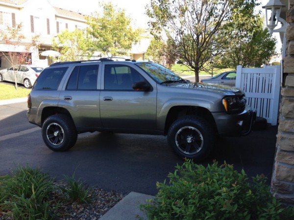

Hey guys, I finished my truck this weekend finally, I put on my wheel adapters from MarkMc I have 17x9 Black Rhino Dune wheels and 265-70-17 Nitto Terra Grapplers. After I put everything on and drove it when I hit the brakes the steering wheel shakes and it's only when I hit the brakes otherwise its fine. I have the wheel adapters torqued to 95 with the shank lugs that mark sent and the wheels are torqued to 95 as well I also have hub rings, any ideas what might cause the shake when the brakes are on? I have a 2.5 inch lift and the wheels are 17x9 6-139.7-12
