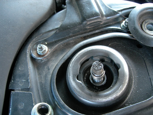

I popped the hood after driving to work today and noticed that the CENTER NUT on the strut towers was not tight.
Picture from one of the sites how to guides for reference
The new struts I put in a few months ago at the end of the threaded area on that center stud have a flattened area to get like an adjustable wrench on to allow you to actually tighten / lossen that nut (otherwise as many of you know the shaft just spins)
My question is can anyone think of a way to tighten that down without having to pull apart the front suspension, and take out the strut assembly to get at that nut.
I tried this morning to find a way to get at it and there just isn't enough room to get a pair of wrenches down there.
I could get a socket on an extension to turn the nut, but with out having access to the tip of the threaded area to hold it still the shaft just spins.
Any ideas?

Mine has something similar instead of a recess for an allen wrench the very end has cut outs so its not round at the tip its flat on two sides so you can keep the shaft from spinning with a wrench / pair of vice grips.
This is from a different vehicle obviously but its similar to this (btw wish we had this much room under the hood! lol)
if I had it out of the truck i wouldnt have a problem
but i can't get two wrenches in there while its on the truck there's just no room

If you have a shock like that, I'd suggest a ratchet wrench on the nut and an open end wrench on the tip of the shock shaft.

Use a crow's-foot on an extension for the nut. Good excuse to buy more tools. Actually, ANY excuse should suffice to buy more tools.

You can pick em up at a lot of auto parts stores too. If I recall correctly they're only torque to 30 ft lbs or so, not very tight at all. Also something like the wheel liner being loose can cause the sounds you mention. The ends of it can slap the metal around it and make a clanking sound
by Mudwheelin » Sat Nov 12, 2011 3:36 pm
I had the same issue a few months ago. I put the wrench on first and used a pair of visegrips for the top of the strut. It worked for me and I havent had an issue with it since.
