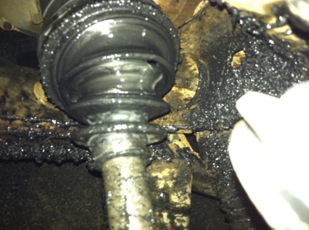

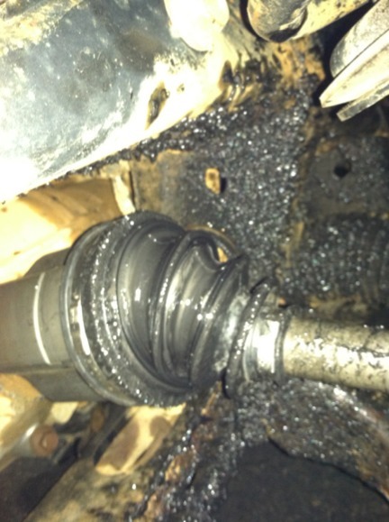

Has anyone else had issues with Cardone select cv half shafts? This is gonna be the third install on driver side. I have only had the second one for two weeks and the boot ripped, I have not gone off road for a while now. The angle on the driver side is a bit more than that of the oem on the passenger side. Not sure what the deal is unless it's just my good luck kickin in again..

by Mooseknuckle » Wed Nov 02, 2011 3:10 am
Pictures of the boot and the angle of the cardone select. What is the exact length of the oem shaft 27.7?

by Trail X » Wed Nov 02, 2011 8:38 am
That does look ugly Moose.
I have remanufactured shafts from Autozone and haven't had any problems. Boot seems to lie properly, and haven't broken in at least 20k miles.

I'm not having problems with any of my cardones. There's a slip joint in the inner boot, so the length is variable.
by Mooseknuckle » Wed Nov 02, 2011 10:54 am
Yea its a big ole mess. At least it's covered under warranty so it's not a total loss. I can also whip these out pretty quick having done them twice before. Thanks guys.

by OregTrailBlazin » Wed Nov 02, 2011 1:09 pm
fishsticks wrote:For now I simply cleaned up the outsides of the boots and duct taped them. It's hokey looking and doesn't seal perfectly, but it gets the job done.
Been that way on my pickup for around 4-5 years, still going strong with no problems. I did use the black gorilla tape though, for a little classier look! :D
Mooseknuckle wrote:Has anyone else had issues with Cardone select cv half shafts? This is gonna be the third install on driver side. I have only had the second one for two weeks and the boot ripped, I have not gone off road for a while now. The angle on the driver side is a bit more than that of the oem on the passenger side. Not sure what the deal is unless it's just my good luck kickin in again..
I'm running them with no problems. Any chance you didn't get the shaft to snap in the diff all the way. I remember when doing mine, it was tough getting it that last inch, and it would cause the extra angle your seeing.. :scratch:

by Mooseknuckle » Thu Nov 03, 2011 1:46 am
Yes i know what your talking about the first time Mario and I did it so I'm sure there was a snap cause Mario is the champ. The second time I popped it in it made a noise that sounded like it snapped into place. My question is the oem length is 27.5 if the cardones are 30.0 couldn't that be a culprit for the angle regardless of the variable? i spoke with an auto supply near me and they have an A-1 Cardone that he says is new for 61.00 so I will go that route cause rock auto takes a while to get here.
