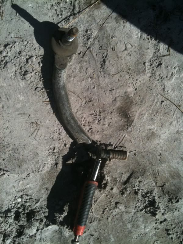

Guys just snapped my steering connection to my passenger tire, yes it's 2 am been walking for an hour and halfway to my boys truck,
Any idea what broke ? Just a tie rod or my steering connection??

Anymore details? Is the passenger side tire not steering or does it flop around in different directions then what your steering in? details and pics if possible I know not exactly the thing to do at 2am.

The tire doesn't steer it moves side to side in a circle not laterally- I thought I broke the new lift design, the rod behind the cv axle closest to the fire wall snapped,
I think a combo of 36f and being stuck in mud and water almost froze it and when it hit it snapped

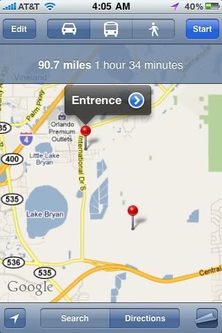

by Hpimichael02 » Thu Dec 02, 2010 5:08 am
And this is zoomed out pretty far on the map, I walked from the stuck pun to the entrance pin

Tie Rod end is what you describe.
A new replacement you will need.

Where exactly does the tie rod connect to ? Into the frame work?? It's broken right in the middle :( pics at around 8 am when advanced opens at 730 then to get a friends Atv to carry all my tools out there, ima give Ron a call in the morning to see if he can help, but the area I'm in I'm in 2wd drive but there's two huge sugar sand pits you need to go through :(

Don't forget to bring a new tie rod. You won't get very far without one.
by The Roadie » Thu Dec 02, 2010 11:18 am
Maybe you're already out there, but when mine broke, it also took out the inner tie rod end. You'll need loctite to install the inner, unless you just do a temp trail repair. Posted about it. Good luck.

Your LCA mount simply got misaligned.
There are a couple bolts below the frame that squeeze the LCA mount. Loosen them, move your LCA forward, tighten, drive on.
