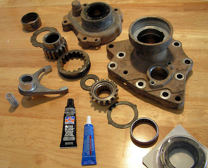

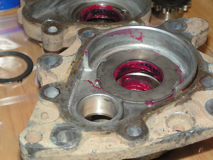

Everything is new, except for the outer housings, shift collar, and inner seal.

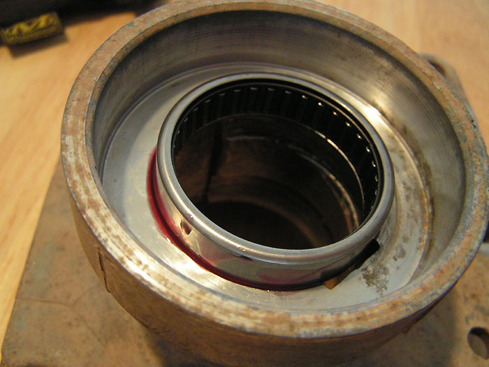

Step 1 is installing the bearings. Note the red locktite used. This is to help prevent the bearings from spinning in the press fit.
Installed using a normal hammer. Just remember to seat it by hand, then lightly tap it in using a star pattern (similar to tightening lugs).

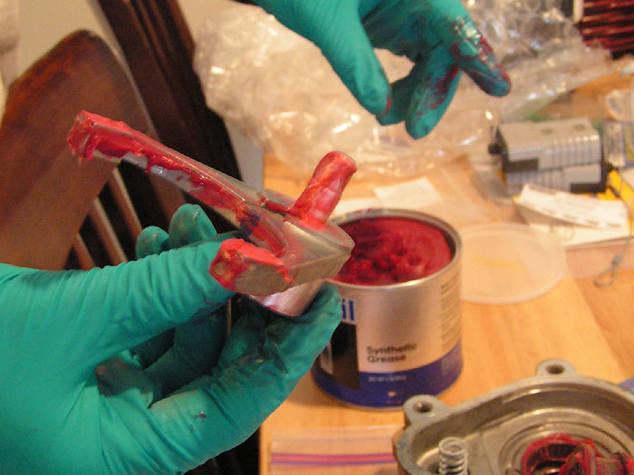

Begin the greasing process. I used a Mobil 1 Synthetic Grease. Begin by working grease into the bearings.

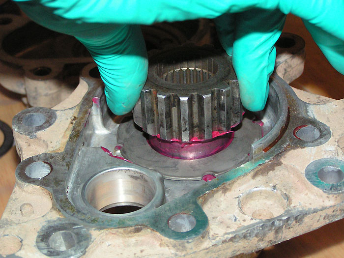

Start adding parts and more grease (this was a test-fit of the gear in the bearing, I added more grease!)
Greasing the fork... ensuring the grease gets on any points that rub:

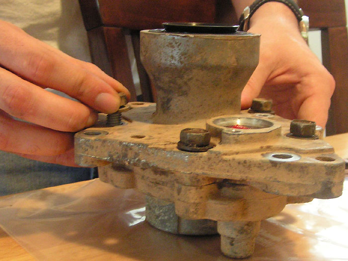

Parts assembled, time for the gasket. I used ultra-black RTV.
Stick it together, make sure the parts align, and begin inserting the bolts.

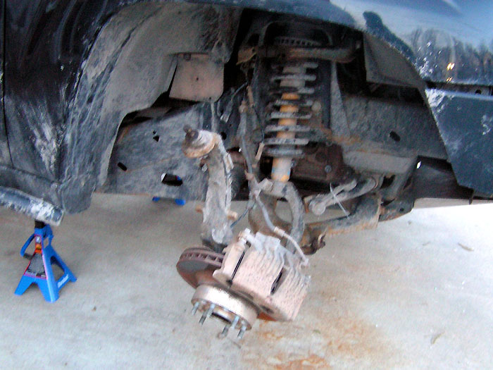

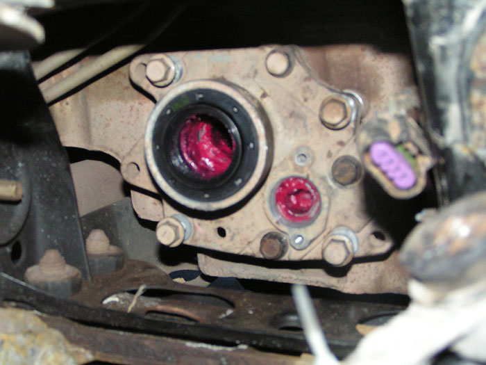

Steering knuckle disassembled for reinstall of the CV shaft.
Installation of the disconnect and bolts:
Back together and working well - so far!
