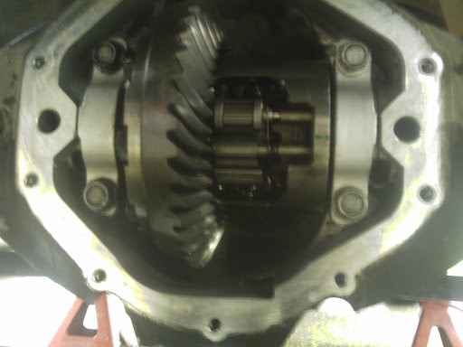

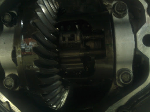

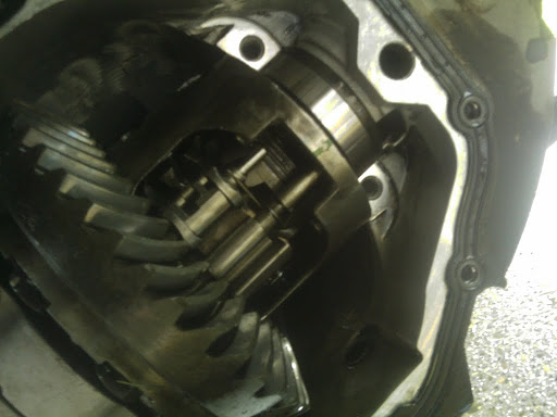

Well, the part arrived this morning. I was able to put it in without removing the carrier from the truck. It really didn't take too much time at all. My G80 engages nicely now.
The bad news: It doesn't look like I have enough clutch material left. While I can get both wheels to lock up and spin in the air, it won't drive off of a jackstand with one wheel in the air.
:cry:

by fishsticks » Wed Jun 02, 2010 5:09 pm
I was going to do a writeup of this procedure so I took pictures. I kinda got discouraged after I discovered my clutches are toast.

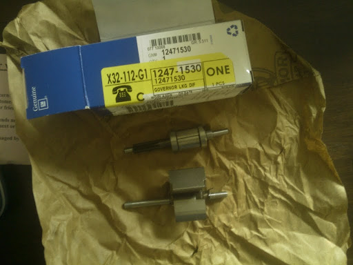

New Parts:
Part to replace:
Bearing cap off, exposing other side of bushings.

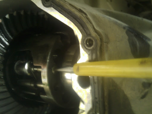

Using a 7mm wrench around the shaft of the old governor. I did this to keep the shoulder on the bushing in tact while I knocked it out. Put a wide blade screwdriver against the wrench head and gave it some slow but firm taps with my 3lb sledge. Slow and steady.

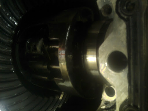

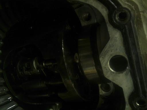

Bushing popped out. It's awfully close to that bearing, but you can wiggle it out without hurting anything.

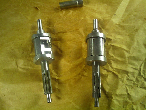

New vs old governor. Ick.
New part in place.
Bushing goes back in with a punch. Easy does it. You have to allow for some play or the governor won't spin and you'll have a locked up all the time G80.
All set.
I didn't do the bottom weight as the mating surfaces on both old parts looked fine and the bushing for the bottom weight didn't really seem to want to move.
I just wish it would have worked. :wallbash:

by fishsticks » Sat Aug 21, 2010 6:14 pm
So I tackled the G80 rebuild yesterday. I discovered pretty quickly that there was more extensive damage than I originally thought.
I did a write up on the rebuild for other's benefit, but my G80 is still in triage. I have cam gear teeth that are stripped, which I never saw until I disassembled the carrier. My spider gears are in terrible shape as well.
I'm to the point now where I'm no longer interested in sinking hundreds of dollars into this rear end. It's obviously not going to stand up to abuse. Junkyards are gouging for rear axles in my area, even in other gear ratios.
I'm thinking I may become the first Trailvoy on record with a welded rear end. Welding everything up will eliminate the problem of a flaky G80 as well as keeping my spider gears from exploding.
It's a functional, if temporary fix while I weigh my rear axle replacement options.
Thoughts?
