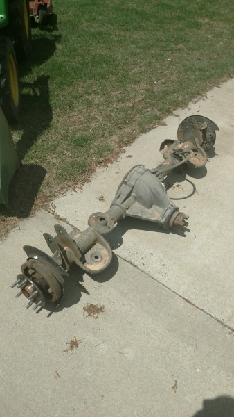

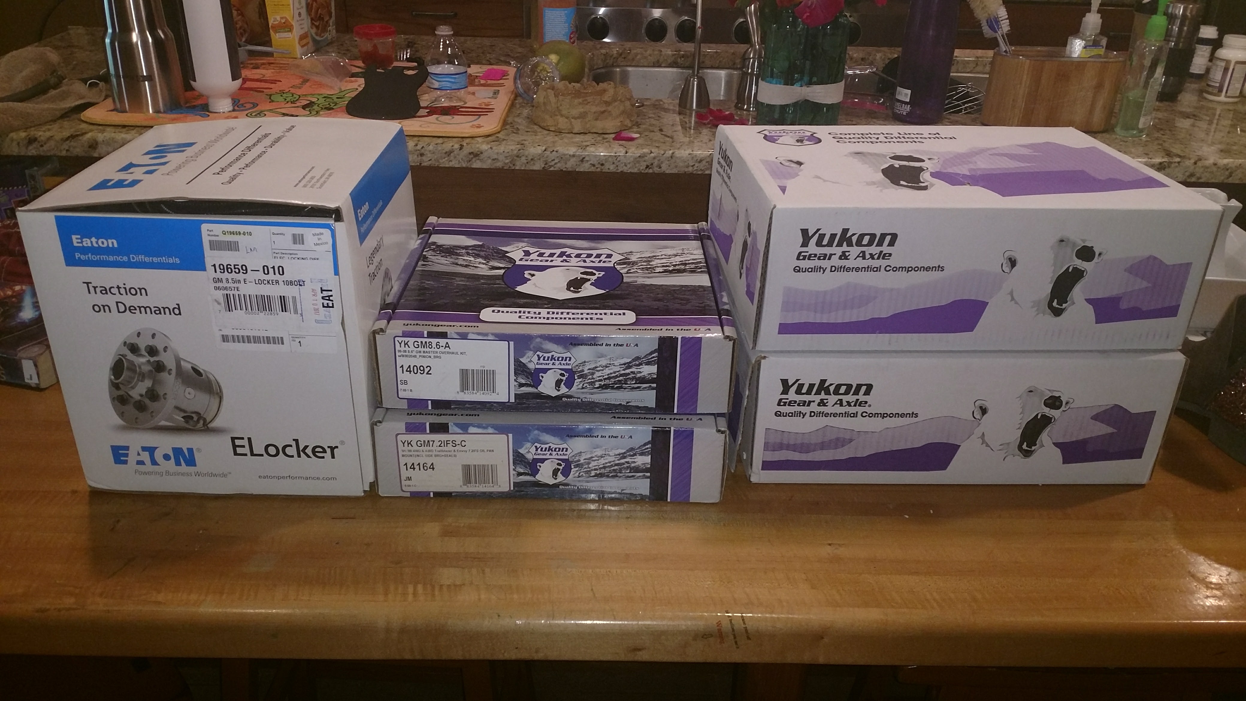

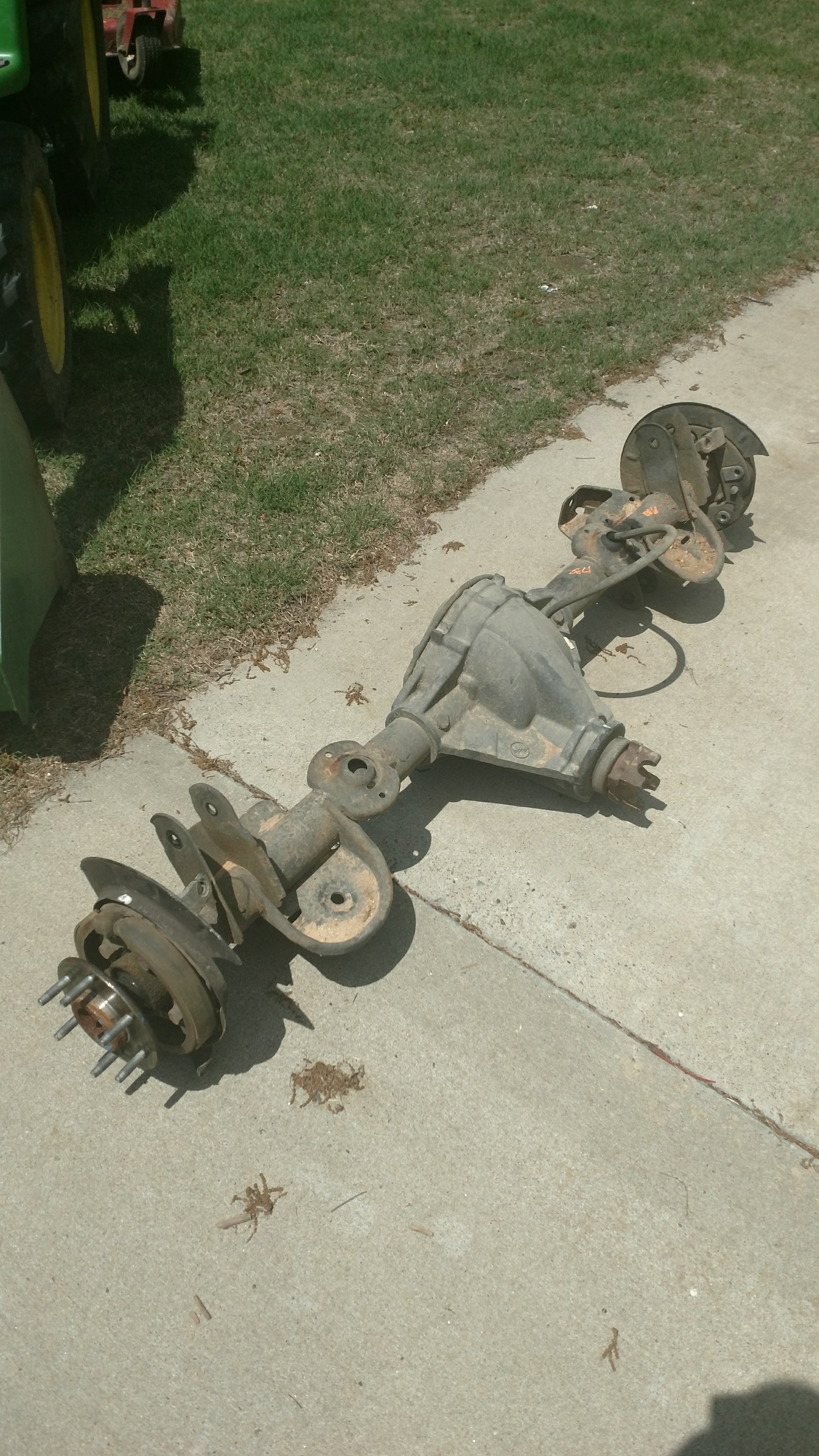

Christmas came in the mail today... 4.56s for front and rear, master overhaul kits for both diffs, and best of all.... E-Locker!! Not to mention I found an EXT at the local U-pull and got the 8.6 out of it!
rearend
christmas
by bljis123 » Fri Apr 21, 2017 11:24 am
Hey how hard is it to add a locker to my 8.6 diff? Would I be able to do it, like any special tools or tolerances that need to be followed?
Mine is a beast offroad with an open diff, a good locker and boom, I already surprise the hell out of everyone in the trails.
Sorry Mason for the high jack, I just saw your goodies!!! Hope you get back on the road soon!!!!

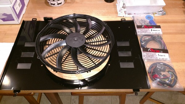

More christmas came in the mail today... PCMofNC Efan kit! Got sick and tired of pulling that damn mechanical fan off every time I need to work on something.
efankit

by Trail X » Mon Apr 24, 2017 10:30 pm
Did they come out with a new kit? I remember their old dual fan kit ended up failing the Roadie test and was pretty much scrapped afterwards.
by mason10198 » Mon Apr 24, 2017 11:00 pm
Trail X wrote:Did they come out with a new kit? I remember their old dual fan kit ended up failing the Roadie test and was pretty much scrapped afterwards.
Couldn't tell you on that one. There isn't a dual fan option for the 4.2s. Duals are only for the 6.0s and maybe 5.3s. I was concerned about it being more voulnerable to water damage since it's electric and not mechanical, so I emailed them and they said it would be fine just short of fully submersing it (Flashbacks...)
by KingBird » Tue Apr 25, 2017 11:26 am
Fully submersing the entire fan or just the motor? I mean, I've been in stuff deep enough to submerge the fan motor, but if it submerges the entire fan, you're likely sucking water into the motor.
I was thinking of turning a 90 straight out of the throttle body and shooting a very short "snorkel" into the cowl that the wiper motor is in. This would really prevent hydrolock as long as you kept the vehicle moving, but then I figured that once your fuse box got saturated, you're D-U-N done, so, I guess I'll just leave things where they're at.

by mason10198 » Tue Apr 25, 2017 11:31 am
KingBird wrote:Fully submersing the entire fan or just the motor?
This is what they told me -
PCMofNC wrote:Hey Mason! Short of fully submersing the blazer, it will be fine :) Both the fan and harness connections are all weatherpack connectors, so you shouldn't have any issues with off roading.
by bartonmd » Tue Apr 25, 2017 10:15 pm
The Roadie test that it failed was that it wouldn't flow enough air to cool the engine on low speed, high throttle activities, like 4lo climbing long hill trails.
by mason10198 » Tue Apr 25, 2017 10:28 pm
bartonmd wrote:The Roadie test that it failed was that it wouldn't flow enough air to cool the engine on low speed, high throttle activities, like 4lo climbing long hill trails.
Is that outside the boundaries of it's designated "operating conditions"? Because I will most definitely be getting my money back if it doesn't perform as good as it's supposed to.
