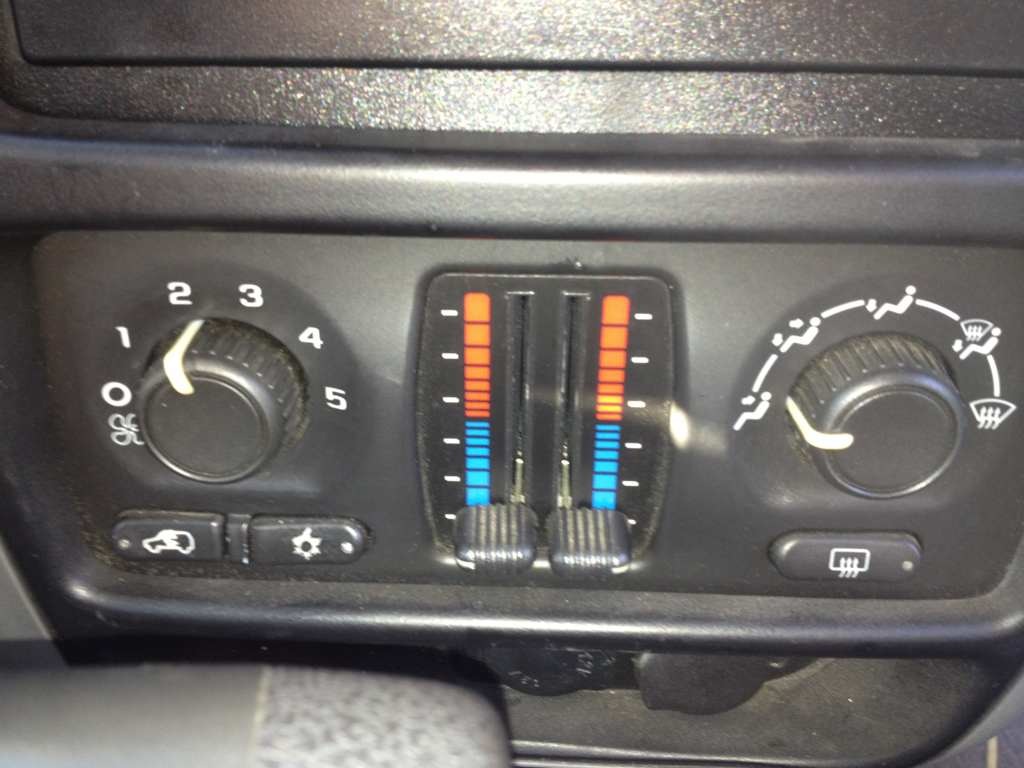

So the AC power knob works all the way to option 4, but when I switch to 5 all power to the system shuts off, as if I'm turning it back to 0.
This happens in both heat and cold modes. Is there anything I can do to diagnose this? Or should I start by replacing the control panel?
Here's a pic of my model for reference:

by The Roadie » Tue Sep 11, 2012 11:51 pm
Trivial. Search gmtnation for "resistor pack". $30 fix.
