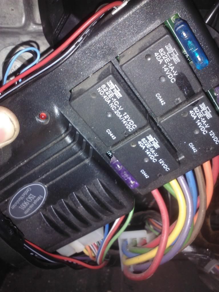

Sorry my phone died and i didnt get to finish the post. Anyways I have pics of the 2 boxes they are boath wired into the steering wheel and the cluster. I cant see them being OEM because there are wires splices all over. Hoping someone knows what they are.

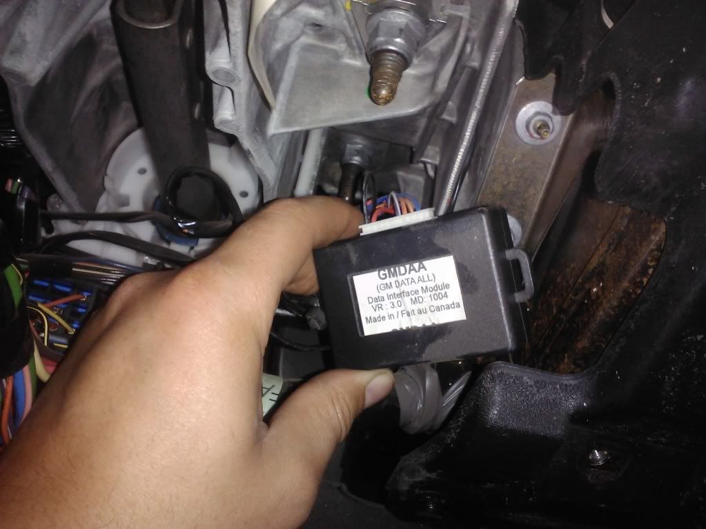

This is the first one I found zip tied just to the left of the of the steering wheel.

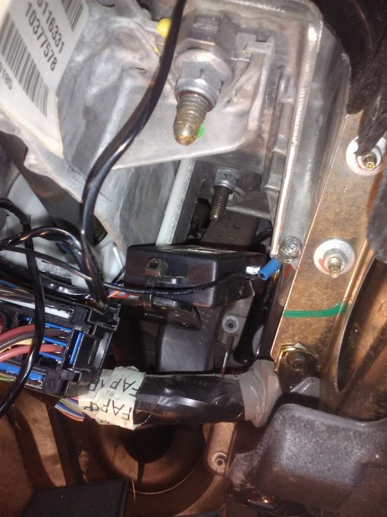

This is where it was and you can see the ground wire just to the right of the box attached with a screw
This is the second one I found just loose in the empty cavity to the left of the steering wheel.

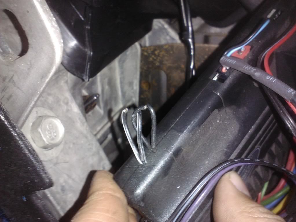

Thease wires have been cut I dont think thats stock.

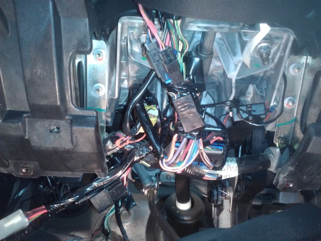

They are all wired into the harness coming out of the steering wheel and goung to the cluster.

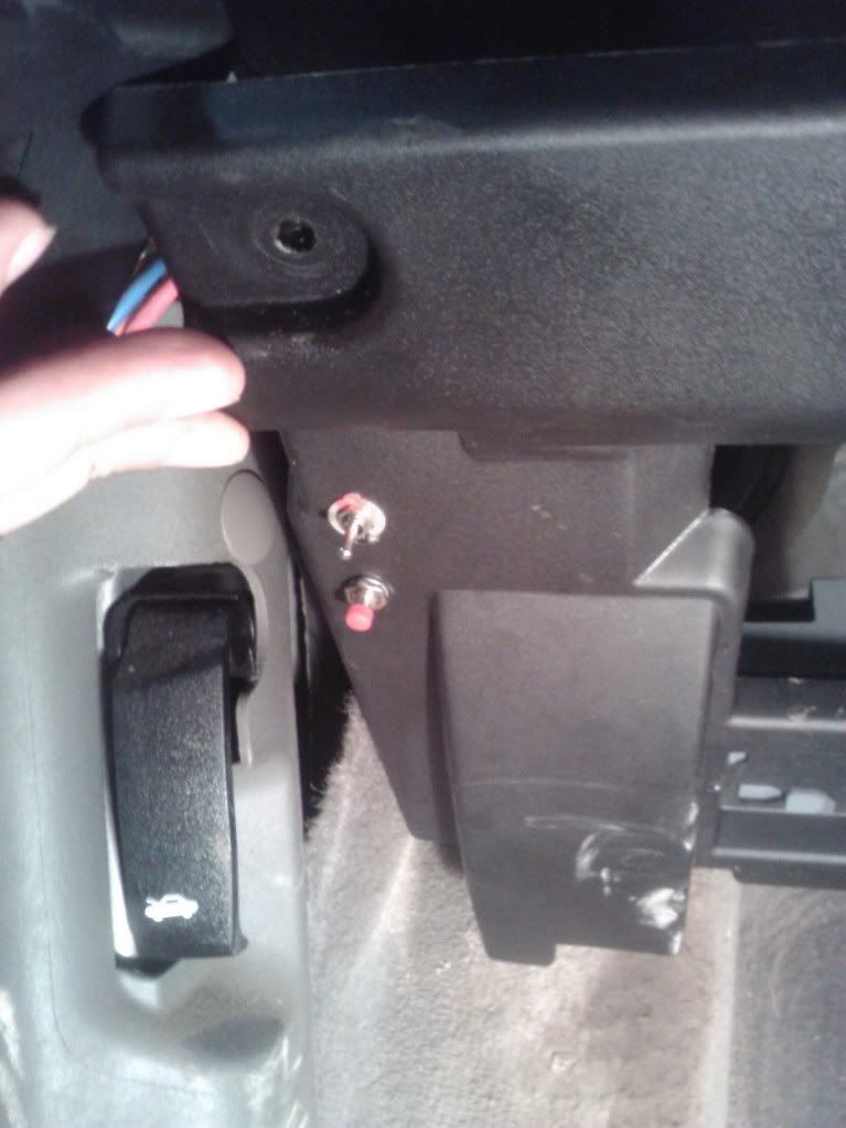

I also noticed that they are hooked up to this switch and button. Tried them but I didnt see anything change.

Its a transponder bypass and door lock interface kit. Check google, it will give you all the infor on it.

Ya I think it is a remote car starter. I did some more searching last night and I looks like some of the install write-ups. Its going to be a fun uninstall.

I don't think that has anything to do with your gauge cluster though. The GMDAA is a remote control/start system. Not sure if that's integrated with the larger box, which appears to be a security system. The switches down below are probably remnants of the security system. One of my old vehicles had a security system similar to that, and you had to press the momentary switch while turning the key in order to start the vehicle. The cut wires are probably 'option control' wires for the module. Any identifying names/numbers on the larger module?

The reason I suggested it's a security system are the relays. I'm guessing one is horn, one is lights, and one is some sort of starter bypass.
I'd honestly not mess with it, as I don't think that's your problem.

I haven't because I thought it must be ok or else everything would not work and this is just an intermittent problem. I did order one 150 that's what you guys use not the stock 125 right. I just don't want whatever this thing is to cause any problems down the road. I think it's a car starter because if it was an alarm It wouldn't have an on/off switch.
