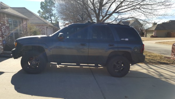

So I contacted Belltech yesterday and they told me the full extended lenght of the struts is only 15.9"
My measurements as my truck sits with worn 265/70/R17's is 37" front and rear, that's without my 2 inch spacers in the rear just Z71's
I changed out my front spring's to Moog 81114's and have Marks 3" spacer now my struts have the ability to be raised to +1 inch but I'm thinking with the 81114's it will be topped out what do you guys think? Go for the extra inch? Or just get bilstien's with the longer extended lenght? I'm trying to get it as close to 39" as I can since that's where mine sits with the 2" spacer in the rear

by eschy1990 » Fri Jan 29, 2016 4:38 pm
I actually just realized I've been fighting myself the whole time...my struts are LOWERING struts...I put my new spring's in and forgot about that fact so I've got my 3" spacers and my struts instantly took 2 away... (-_-) I'm gonna leave it for now until I can get some bilstien's and then It will be right...any opinions on where to order them from?
