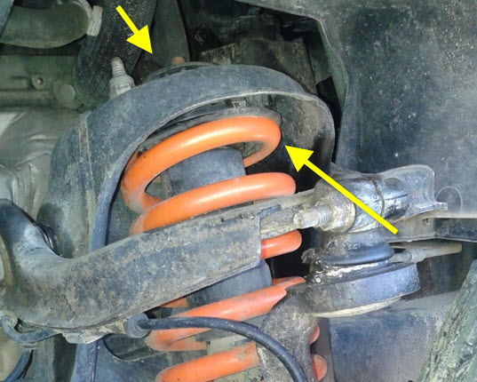

by andre4x4it » Wed Nov 06, 2013 9:35 am
front normal dx
sx
front max extension
Reason: Fixed img tags

by The Roadie » Wed Nov 06, 2013 9:52 am
Interesting. I fixed your "img" tags to make the pictures automatically load.
1) Are those new springs, or did you just paint them?
2) Could you take close-up pictures of two more things? The top strut spacer from below, and the strut top from under the hood. Thanks.

by navigator » Wed Nov 06, 2013 2:05 pm
HARDTRAILZ wrote:3 inch lift via springs only...
I think Kyle nailed it, springs only so far.
by Trail X » Wed Nov 06, 2013 2:07 pm
Bill, I see no spacer. Looks like custom springs??

by The Roadie » Wed Nov 06, 2013 2:35 pm
But I still don't see ProComp having a spring-only lift. I find "Pro Comp Nitro Lift Kits - 63215K" that has spacers only.
Andre, please find out where your shop obtained the parts they put on your truck. And what the part numbers were.

by HARDTRAILZ » Wed Nov 06, 2013 4:40 pm
I did not give a link, but I think what you are asking if with your current lift coils (whatever brand) can you add an additional lift of 2 inches via spacer.
Honestly, I do not think anyone can really answer that since the springs and spacers work together. It would depend on if you wanted inside or outside strut spacers, how much lift you have currently, what your spring rate and length is. You may be able to get more lift. The biggest stopper is when the CV is maxxed out and binds from extention. Not sure how close you are to that point.
If you can get spring length and rates and whatever other info the shop can share, we may be able to help you come up with an answer to your question, but right now I think we would be shooting in the dark since no one has done 3 inches of lift via coils only in the front.
FYI-- The rear can handle another spacer with no issue. I had 2 inch springs lift and two spacers at one point. The front is the hold up. Some geometry is involved in how the parts work together and create the actual amount of lift. Typically a spacer that is just outside of the strut assembly is not very safe, esp at 2 inches.
