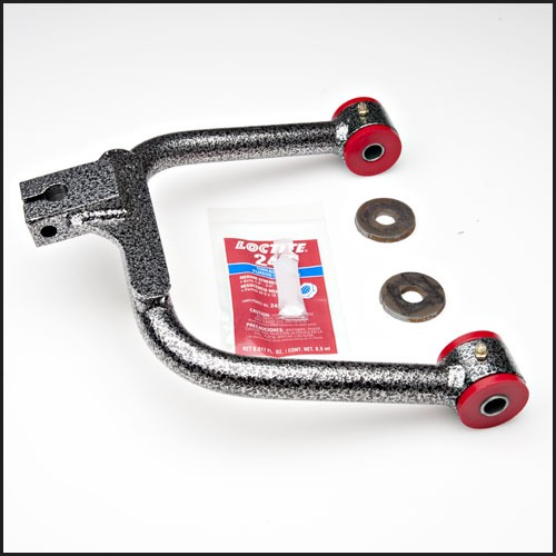

by TexTrail » Tue Oct 23, 2012 7:45 pm
This all I could find after more searching. It looks really dinky and if this is that was failing I can see why. My idea is out of CNC cut and then welded flat plate maybe 3/16" thick with threaded inserts and use heims for all the mounts or maybe just the upper ball. You would have to ditch the upper ball for a specifically designed misalignment spacer that would sandwich the knuckle where the ball joint was... I really need get those uppers out and measured and drawn into a 3d model.

by HARDTRAILZ » Tue Oct 23, 2012 9:16 pm
Thats the only option. Interested to see what you can do.
by v7guy » Wed Oct 24, 2012 1:05 am
Matt, those are the ones.
I'm with Kyle, interested to see what you come up with.

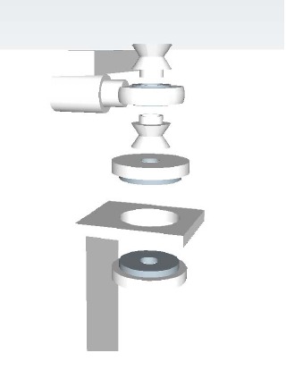

by TexTrail » Wed Oct 24, 2012 4:17 pm
I drew this up at lunch. This is a rough version of what I had in mind to replace the ball joint. I'm still mulling upper control design but I've got a few different ideas some are crude but sturdy and easy to fab others would look better but be more work and design intensive. As I get my ideas drawn up I'll continue to post them and if anybody else is motivated feel free to take them and execute them or call them dumb and tell me to play in traffic. I hope to pick one and build a prototype soon.

by v7guy » Thu Oct 25, 2012 1:37 am
That would probably work, but couldn't you just use a balljoint that's pressed/bolted into the arm? A heim/solid bearing would work... I use them everywhere in my firebird, but for something that sees a lot of miles in a dusty, gritty, wet environment they tend to wear relatively quickly. I've heard conflicting reports on the heim boots effectiveness. Just a thought.

by TexTrail » Thu Oct 25, 2012 1:41 pm
I also use heims on my jeep. My current jeep is one I didn't build but I know the heims lasted there for 2-3 years under heavy abuse. I just wish they were 1-1/4" heims instead of 7/8x3/4 at least on the lower control arms.
I've got three different ideas for both the joint on the upper arm and the arm itself. That's just the first rough idea.
The guy on the toy website was using uni ball joints in his which is just a heim with no threaded shank. The other purpose of the heim would be for camber adjustment. What are the chances we are all running the same lift where a fixed joint location is best?
Also a press in ball joint like stock is weaker and has less range of motion than a heim or a johnny joint (one of the other ideas). However I have a lot more research and design to do before there is anything even worth trying.
One of my three ideas uses the factory ball joint in a way that it would would be in a centered/neutral position at ride height. Upper ball joints are always a common weak spot but less so if operated in the range of movement.

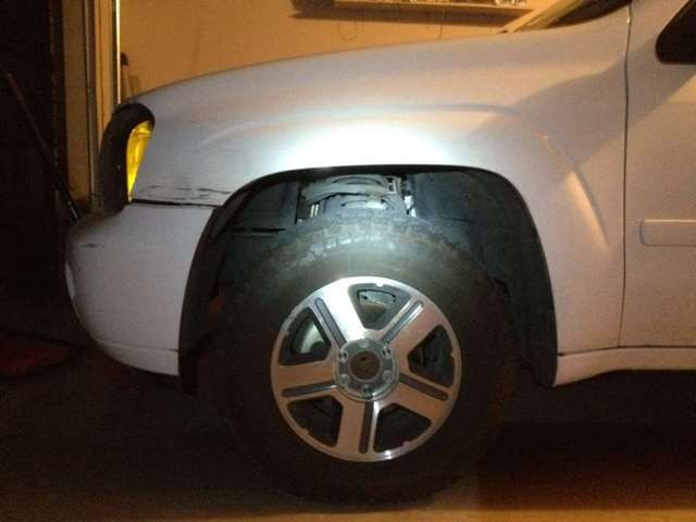

by TexTrail » Wed Nov 14, 2012 1:20 pm
I put a lift on my wife's car this weekend came out great. I made a front ready lift copy (I know the issues it presents but for $17 hard to beat for now) and z71 rear springs. I also upgraded the front struts to the ever popular bilstien hds.
I have started taking some angle measurements at the lifted ride height to establish a lower limit for the amount of lift the upper control arm will be made for. The break down will hopefully come out to:
2" lift the ball joint leaning slightly away.
3" ball joint neutral.
4" ball joint leaning slightly toward the vehicle.
I think 2 different versions will be good. The first will directly swap with a factory and use the ball joint. The second one that utilizes a heim and replaces the ball joint.

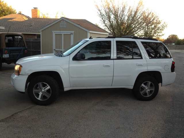

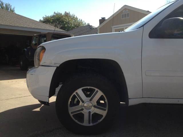

by TexTrail » Wed Nov 14, 2012 6:45 pm
Sorry I accidentally posted the first phrase. I went back to edit and got interrupted sorry about that I did finish the edit and here are the pics I have do far.

by TexTrail » Wed Nov 14, 2012 6:59 pm
I made front strut spacers out of 3" Dom and plasma cut plates I cut out at work with CNC machine. They are ready lift copies. I also put the bilstein hd front struts on. The rear is z71 springs and stock shocks for now until I decide what rear shocks. I'm thinking bilstein 5125s.
All in all the install went well. TB springs are so easy to compress compared to others I've done. The rear took about an hour with my 3 year old son "helping". And about 3 hours for the front including the fab work. I used to work in truck accessories so I no my way around an IFS with modified struts pretty well.
