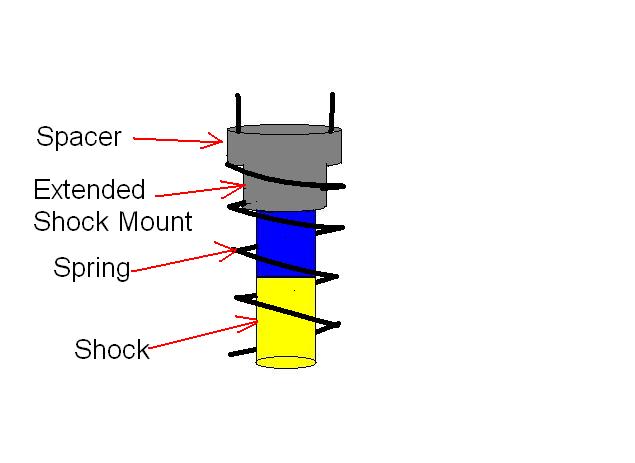

by navigator » Wed Feb 22, 2012 2:08 pm
I know it is a bit late in the game and I'm sure Mark thought of this in his design and a reason why not to do it but I'll ask anyway.
I've not seen any spacer(except the RC) up close but I expect they are all similar.
When making the spacer the top of the strut bolt is pretty much the top of the spacer.
What if the part the strut mounted to was recessed down maybe an inch, that would effectively make the shock an inch longer.
I know we can't allow the shock to have too much droop or we'll bind the CV but I would think there is an ideal amount of droop that could be built into the spacer.
I know that doesn't help the spring conversation on the surface but by that same token I would think a new top mount could be made that gave virtually no lift but would allow the stock mounting point to be recessed into the spring area.
I made a rough paint job of what I am talking about.

by navigator » Wed Feb 22, 2012 2:12 pm
I just remembered it would be a real pain to get an allen wrench in the top of the strut so you could tighten the nut.
Also if the bolt got rusty it could be a pain to remove.
I know for strength purposes you would also need to maximize the thickness in the side of the shock mount area which means the well where you get the nut/socket in would be tight.
Other than those issues what else have I missed?
by Trail X » Wed Feb 22, 2012 2:35 pm
Chris, I know my BDS lift does offset the shock mounting plate from the top mounting plate. I supplemented this offset with the "washer mod".
