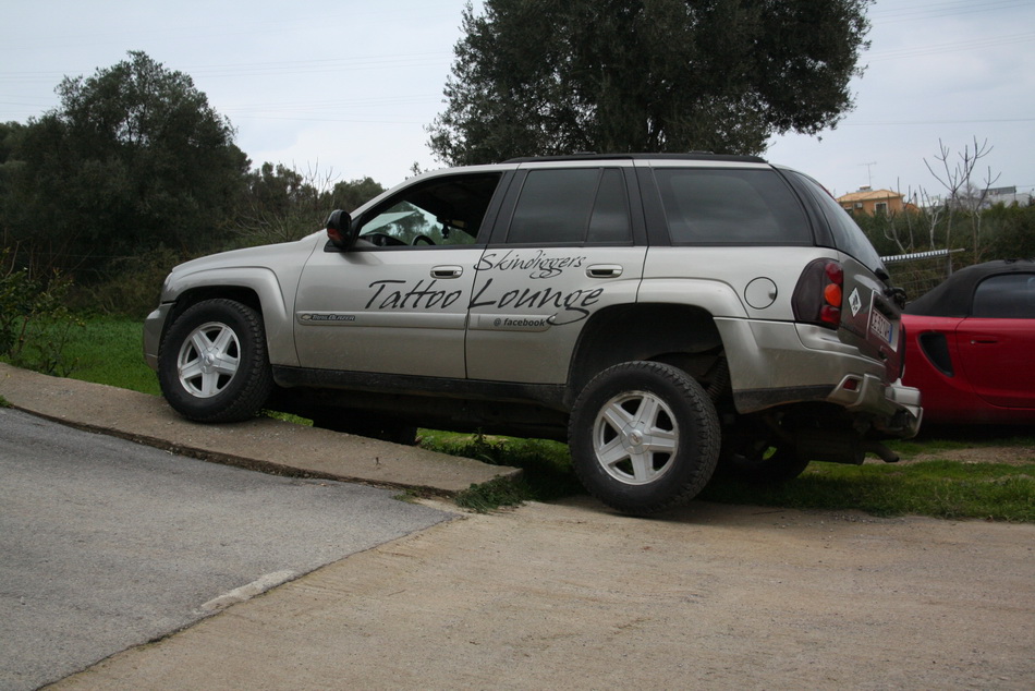

by Skindiggers » Sat Jan 28, 2012 8:33 am
I removed the front sway bar completely from the truck.. It's perfect without it even on the highway ! I have Mark's 3" lift and maybe that's why i don't feel any excessive roll ..
Not to talk about the flex , it's much , much better now !
Skindiggers
Posts: 128
Location: Crete, Greece
