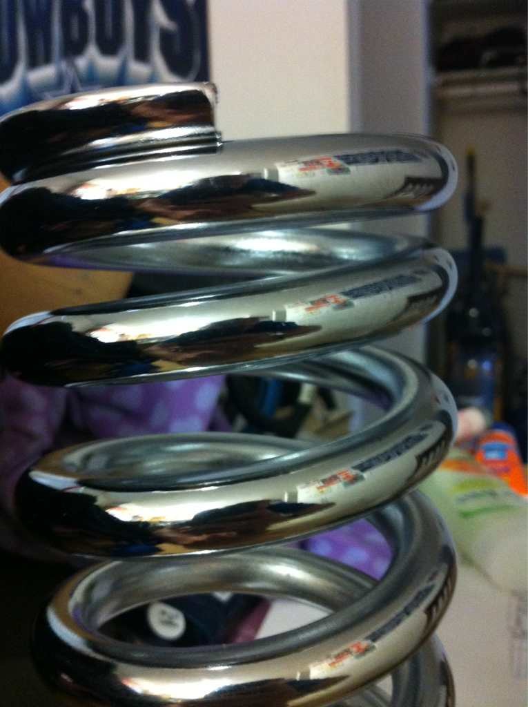

JamesDowning wrote:Looks like both sides are flat ground to me.
there is a slight lip on one side( let me see if I can take a better pic)Image

by lupisnegris77 » Tue Apr 24, 2012 5:59 pm
Not near as big as the stock but still not flat either

by fishsticks » Tue Apr 24, 2012 8:26 pm
That changes things a bit. :mrgreen:
Put the nonflat side down into the perch on the shock. Grab some 1/4"-3/8" rubber from your local hardware store (mine sells scrap for $2/lb) and use that on the top to keep any noise down. Just cut a circle out of it for each side.

by Trail X » Wed Apr 25, 2012 10:19 am
I think that's still considered flat ground.
by lupisnegris77 » Wed Apr 25, 2012 1:08 pm
JamesDowning wrote:I think that's still considered flat ground.
Either way when I get it apart I'm gonna play with the insulator and isolator and I'll figure a way to make it work. :mechanic:

by Trail X » Thu Apr 26, 2012 2:46 pm
I think the biggest challenge is going to be that bottom perch. I just don't see it working - and if the isolator from the top does work, I can't see it having any longevity. Also, not sure about your lift... but the BDS has a lip on the inside. I don't know what the OD of that lip is, but it could prevent the use of springs with a small ID.
On a side note - we really could use an aftermarket lower spring perch for flat ground springs... that would blow the whole market wide open. (Nudging some of our fabricator vendors)
by fishsticks » Thu Apr 26, 2012 2:51 pm
JamesDowning wrote:On a side note - we really could use an aftermarket lower spring perch for flat ground springs... that would blow the whole market wide open. (Nudging some of our fabricator
vendors)
IIRC it's just a ring that slips down the shock body and sits on a collar.
by Trail X » Thu Apr 26, 2012 2:55 pm
Yea, exactly. Might not be too hard to fabricate something that would work (basically a sombrero with a hole in the top). Issue is it prob needs to be heat treated so it doesn't open up around the shock's collar.
