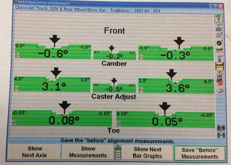

I have the 3" lift with 88s (maybe pushing 4" lift) and flipped control arms and had no real issue aligning it. I know there is a picture of the print out of my alignment on here as well.
Take the lower control arms loose and shove them way out and just try to get the toe close before you go. If it looks closer, they tend to do better.....or they end up like you and assume it is too far out to ever get in and only do it halfass. I found an alignment guy that had a lifted truck and he ended up loving my truck.
