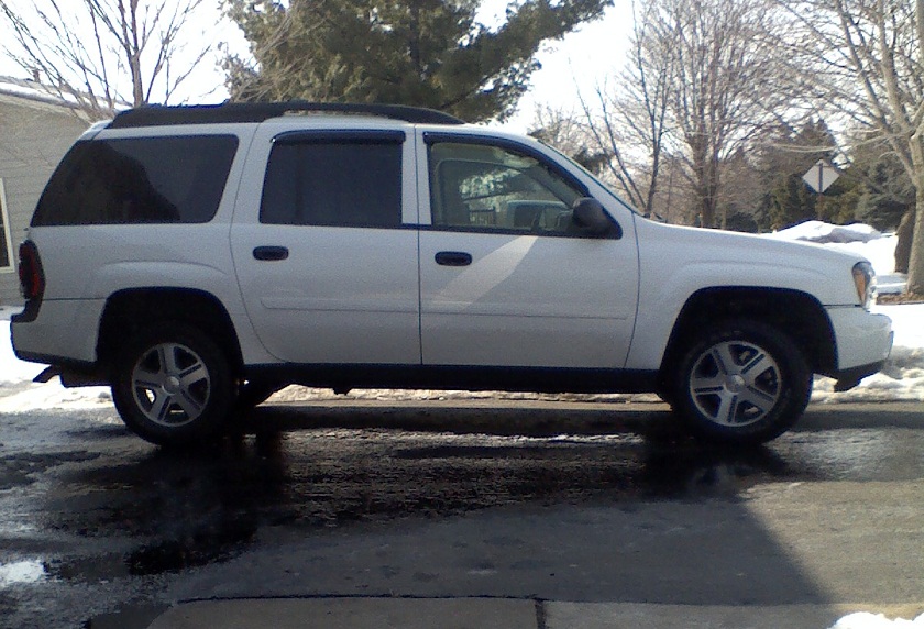

All done with the rear springs :woot: . Once again I had the 85's up front from the factory. I installed the Moog 81114's up front with a Mark 1/2" spacer. The rear got the moog 81069's. Finished result is 2" up front and about 1 1/4" out back. It looks like the only difference between the 81071 and the 81069's are just an inch free length, the thickness of the spring is the same. May make for a nice option for those who want some extra ride height but don't want the rough ride of the z71's. The ride of the Tahoe HD (69's) springs seems no different from factory or the Tahoe standard replacements (71's). Since these are rated for a 500lb heavier truck I don't expect too much sag fully loaded. I was hoping for 1 1/2- 2" of lift over all so if they sag slightly over time Ill still be very happy. It doesn't look lifted, it just looks right, why didn't they just build them this way?

Been running this for a year and still very happy. The ride is good, firmer than factory but far from harsh. I was looking for alittle more height and capability and that's what I got.
