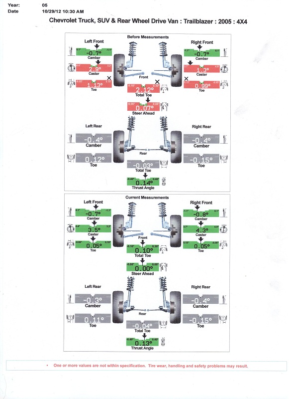

by ksmarshall » Fri Nov 02, 2012 4:05 am
my alignment after the lift

by sker13 » Sat Nov 03, 2012 10:29 pm
ksmarshall wrote:my alignment after the lift
Alignment specs look really good!

by ksmarshall » Tue Nov 06, 2012 4:32 am
i thought so as well , i was going to flip the upper control arms but read on here that it may mess with the alingment , i would rather have better wear on the tires , seeing the truck is still being daily driven

by Trail X » Tue Nov 06, 2012 9:30 am
Seeing that it's in spec, I wouldn't flip for now.
If you upgrade the front springs, then you might have a need for flipping.
by v7guy » Tue Nov 06, 2012 11:32 am
:Iagree:
by ksmarshall » Wed Nov 07, 2012 2:12 am
I also agree, I don't see taller springs in my immediate future though, with 3.42 gears I am limited on how tall of a tire I can go to about 32'' before I have to start looking at a set of gears, so with the truck on 265's I don’t see the need to go any higher yet, until I save up for gears that is by then hopefully I won’t have to daily the truck anymore and can go crazy on the build!!
