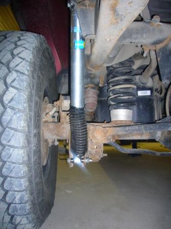

I originally installed the 5125's with 1/2" washers but I was not happy with how rigid the shocks were. So I followed Opeth's spacer suggestion and made some 1/2" ID spacers (3/4" pipe - 0.120 wall).
But when I pulled one of the shocks, the boot was half full of water. Looking at the boot, it has holes on the connection end, so the water spray from the road, has no where to go but become trapped inside.
While it is more common to install shocks boot up, at least in my experience, it appears to me Bilstein meant the boot to be installed down!
So I am trying it. Thoughts?

by Opeth » Sun Oct 21, 2012 6:01 pm
Yea I noticed mine had some water in them too, I sliced cuts up each opposing side and re sip tied the boots, problem solved. That's how most boots are anyways, being upside down and the piston rod becomes vulnerable if you go off roading. That's why I won't run mine down like that.
by bartonmd » Sun Oct 21, 2012 7:57 pm
I think they're supposed to be tube-down.
by v7guy » Mon Oct 22, 2012 1:35 am
Yeah "tube down" is the standard way. Some racers started installing shocks "rod down" to reduce unsprung weight. Some shocks don't tolerate the rod down position.
If it makes you feel any better I was working on a trailblazer that had boots installed on a tube down shock arrangement and it had significant amounts of water built up in it.
by fishsticks » Mon Oct 22, 2012 12:15 pm
Gas charged shocks go rod down. Hydraulic shocks rod up. (Ignore our front shocks) :mrgreen:
See Bilstein 5150s as an example.
If you run without a rear sway bar and flex the left rear wheel all the way down, the panhard mount will dent the tube if you run them rod up.
by Lauron » Sat Dec 01, 2012 9:27 am
To stir the debate a little more, Bilstein US got back to me and said I could install the shocks either way. I was very surprised the shock doesn't have a preferred orientation for better operation and/or reduced wear. If there is, I was surprised that Bilstein wasn't willing to inform me of it.
So for damage reasons I am going back to tube down. I will be punching holes in the boot close to the base of the tube end to drain the water.

by Opeth » Sat Dec 01, 2012 12:42 pm
Lauron wrote:To stir the debate a little more, Bilstein US got back to me and said I could install the shocks either way. I was very surprised the shock doesn't have a preferred orientation for better operation and/or reduced wear. If there is, I was surprised that Bilstein wasn't willing to inform me of it.
Just make a slit on the back side and re zip tie it back on so the slit is a tad bit open. That's all I did.
