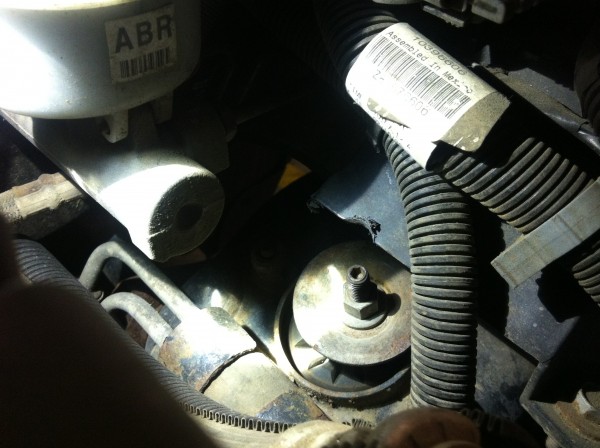

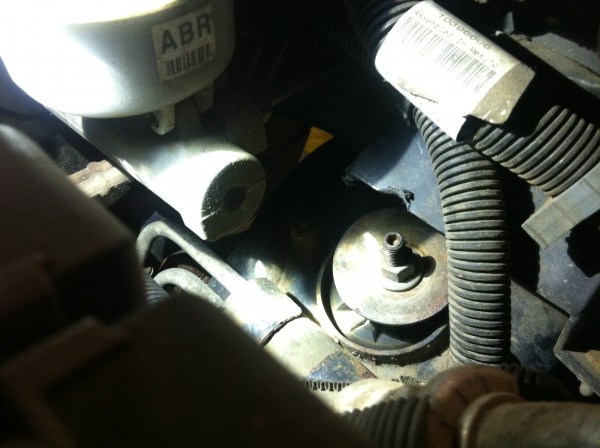

Well, it's time for me to join this discussion. Five months ago, I had the MarksMC 2.5" lift/level kit installed in my TB EXT, using the original front bushings, with about 90,000 mi. on them. Last night, in a townhouse complex with way too many speed bumps, I heard a clunk from the front. Upon inspection in daylight today, I found the drivers side bushing had opened up. I've read several of the related threads here, and I'm still unsure as to the preferred fix for this issue. Do I replace both sides with new OEM bushings and stock size washers, get aftermarket units with oversize washers, and if so, do BDS bushings work with stock Bilstein struts, or did Jrgunns Acura poly bushings prove to be the answer?

by Jrgunn5150 » Sat Aug 08, 2015 2:18 pm
Well that sucks.
I've had my poly bushings on in conjunction with some washers underneath for about a month now. I've put around 4,000 miles on them and haven't had a failure yet. I wheel about as often as you seem to, which is to say as often as I can.
Long-term, I don't know yet. I know many have had success with just the washers alone. As to going back to the OE bushing, the Mark Mc spacer is cast differently, so we are locked into this style of bushing now.
by BC backroader » Sat Aug 08, 2015 4:11 pm
Thanks for the feedback, Jr. It seems that you have the 3" lift, which I think mounts differently from the older 2.5" that I have. The 2.5 is apparently designed to use the OEM mount and bushings, with only a change in the washers, which I didn't get in my slightly used kit. My local tire guy has quoted me $400 CDN (about $300 US) to re and re both sides and do the alignment that I should have done with the lift, which doesn't sound too bad to me, so I'll get it done this coming week.
