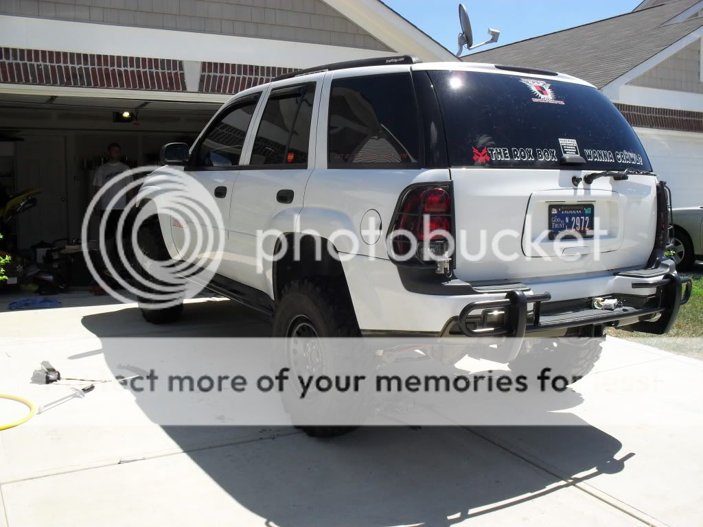

34x10.50x17 LTB on 17x7.5 stock base 1/2 ton chevy wheels

by Gordinho80 » Mon Aug 16, 2010 3:55 pm
New shoes, Kyle? Not bad...

by irishboy02 » Mon Aug 16, 2010 4:01 pm
Nice kyle! Are those the SS skinnys?

by KE7WOX » Mon Aug 16, 2010 4:17 pm
They look like SuperSwampers.
Are those TB 17" spare wheels?

by Trail X » Mon Aug 16, 2010 4:38 pm
Those look awesome Kyle. You're going to hijack the random shot thread!
by HARDTRAILZ » Mon Aug 16, 2010 7:31 pm
34x10.50x17 LTB on 17x7.5 stock base 1/2 ton chevy wheels.
I dont like them. They are taller but not what I want. I think the wider ones are more functional since we need to stay on top of rocks with the lower ground clearance and these seem like they would slide off more easily or not even grab where needed. I like to watch my tires for placement but with them set so far in you cant see where they are.
I'm selling them asap and looking for some 35x12.50 for fitment testing.
they look ok from side and drive pretty good, but not my taste. The truck looks disproportionate to me now. There is minimal vibration with 1 traditionally balanced and 3 with 8 oz airsoft .25gram beads each. They are loud but that is half the fun of swampers. Seems they could tear the pavement off the ground. 1 is new the other 3 have 3000 or less miles.
Hoping to get 600 for the set. They go for 190 a tire if you can even find them. I figure ask 700 and get some money for another set.
by KE7WOX » Mon Aug 16, 2010 7:50 pm
I kinda like the look, but they do look much more narrower than they are (~266mm), a look much more suited for a Land Cruiser. Looks like 12.5 will be slightly larger than the ones you were running, but should work with all the mods you have.

by Trail X » Tue Aug 17, 2010 8:55 am
Too bad you're not keeping the setup. It really gives it a functional appearance compared to your old wheels. Looks more like a working truck.
As fishsticks said on the OS, your wheel bearings, ball joints and steering probably like this setup a lot more too.
Good luck on the 35s... I'll be interested to see how they do on real trails... from what Guy's told us, 35s may be the breaking point of our diffs and half/CV shafts.
by HARDTRAILZ » Tue Aug 17, 2010 1:59 pm
I think they look ghetto as shit. They dont feel nearly as stable. Kind of has a tractor look to it. If i actually thought they would function i would leave them on for the offroad park this weekend, but I think my Pro comps are a better all around tire even if a bit smaller in height. I want the width for the extra traction it offers, sometime just a lug or 2 makes all the difference. The 34s would be a ton of fun if you were just goin muddin though.
My balljoints are already shot, so they will be new. the rest needs to be tested. If it breaks it is just more support that for real offroading you need to do sas or serious upgrades. I NEED 35's at least to keep up. I do think that 35s may wear some things more, but they will offer a few advantages that I think makes up for any wear.
hell i dont leave stuff alone long enough to wear out. If i dont break it I upgrade anyway, so 35 wont be any different.

by HARDTRAILZ » Tue Aug 17, 2010 3:04 pm
True. To each their own.
I have always seen and been taught that the skinnier tires will dig down and spin easier to clean themselves out and work good for mud until it become too deep and you need flotation. But i grew up and no longer play in the mud. It breaks parts and is not as fun as it was in high school.
My point is that I want 12-15 inches of tread trying to catch any traction available. These 10.50's, but they seem skinnier, just dont have the footprint to grab traction when you may only get a couple lugs to grab. I also like the stability of the wider track and tires. I know a couple places on dropoffs, rocks, ledges, where there has been nothing under half my tire, but the remaining 6 inches of rubber is almost as much traction as many of the skinny tires with all the tread down.
I am looking at conquering tougher obstacles more than overlanding. I love to wheel and camp, but there is too much civilazation around for me to bother with trying to set-up for more than a week or so of camping and even then you are likely to have to pass a town or somewhere to stop when traveling. I read the d.e.d. series and they try to stay off pavement out west and still hit towns and pavement fairly regularly. I have nothing against it, but in modern society there doesnt seem to be much use for it. I camp for days at a time pretty regularly but am almost always in cell service and an extention cord away from power. Hell a decade ago I used to sleep in and live out of my Suburban checking out Florida and the southeast, but did not do a lot of wheeling, just visiting and sight seeing. I made it over a couple weeks without dealing with people, except for gas stations. it is fun to feel self-sufficient and do something different, but now I will choose a campground with a shower and toilet over sleeping on the side of the road.
i use my truck as a daily driver and a weekend warrior. I dont see any real advantage to me for the minimal wear skiny tires would save considering the advantages i would give up in my offroad quests.
You can read and debate the skinny vs wide all the time, but I think skinny looks like shit and wont do what i want. I almost did not finish mounting the wheels and tires up, but figured i should for others that might have a similar idea. My buddy wants them for his yota 4runner and I looked up pics and they fit nicely on them, but they dont seem to fit my needs or the looks of the truck.
Hopefully i did not waste my time and the pics give someone else ideas. I know that my truck felt, drove and looked better before the 34's so it will go back to the others.
