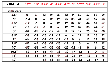

I looked here and couldn't find the chart that has been posted frequently, there is a chart on the following link that makes it easy to convert.
https://www.rsracing.com/tech-wheel.html

navigator wrote:I looked here and couldn't find the chart that has been posted frequently, there is a chart on the following link that makes it easy to convert.
Thanks again! That chart helps a lot.
TB's need Less than 5 inches of backspace to run bigger tires or you'll hit the Upper ball join correct?
If you're running the 1.5 wheel spacer you would want a backspace of around 5.5 (5.5 - 1.5 = 4), so you'll clear ball joint and stick out about 2 inches farther than stock?
However, you DON'T want to go too small of an offset / backspace or your tires will stick out ridiculously far?
~With a back space of no smaller than (with a spacer) like 4.0 inches ( 4.0 - 1.5 = 2.5), clear ball join, but have little more than 3 inches of tire sticking out)?
According to chart
~8 inch width rim +12 to +25 offset
~7 inch width rim +12 to +38 offset
These offsets would give you enough clearance and not too much stick out with spacers installed?!
I'm sorry, I am WAY overthinking this I'm sure of it! :wallbash: But, I am getting ready to drop a descent amount of money on wheels and tires! I don't want to get this wrong. :scratch:
SO THANKS for your patience and your help is VERY MUCH appreciated! :salut:
