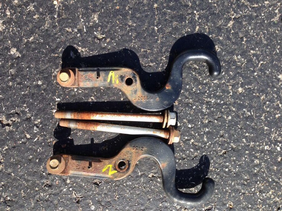

I searched the forum and only found a couple items on front tow hooks but it wasn't sufficient. Aside from a new bumper, has anyone fabbed any tow hooks in the front of their Envoy? I'm not concerned with cutting into the bumper or anything like that. I've looked at the mounting brackets that are used when flat towing but for the price I'm just holding off until I pick up a new bumper. Basically, just looking for something to finish out this summer. If there's already this discussion and I missed it just post the link please.

Why not go to a junk yard pull some factory tow hooks? I got mine for like $12 bucks.

Got go to a you pull it yard, one guy took a set of s10 blazer hooks and made them work
by TPuls » Wed Aug 20, 2014 11:26 pm
That's what I was thinking about doing just wasn't sure if trailblazer hooks bolt directly to envoy. I have some here for a Z71 I was just going to make work. Looks like it'll be about the same thing.

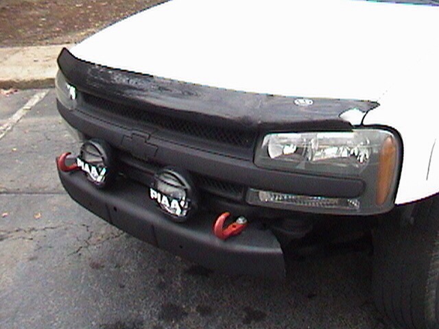

This may help you.
http://forums.trailvoy.com/showthread.php?t=72225
You could just take off the bumper cover and mount something like this.
by Trail X » Thu Aug 21, 2014 9:31 am
The stock TB hooks will bolt onto an envoy. You may have to drill and bolt the extra bolt on though. Not sure if the Envoy uses the same impact bar or not. You would have to cut your bumper cover. The stock hooks for $20ea don't sound so bad. I wouldn't do what is pictured above, not without a second bolt in the hook.

Trail X wrote:I wouldn't do what is pictured above, not without a second bolt in the hook.
Yea I should have said something in my post, I know better. :facepalm: :roll:

by TPuls » Thu Aug 21, 2014 11:31 pm
well i'm trying to resize my photo so it'll upload but I can't figure out these program with windows 8...anyways, got the tow hooks installed. I used aftermarket tow hooks but just moved them slightly from where the factory holes are so I had to drill. At least in my case, the Envoy bumper didn't need to be cut. I hat pull it down and give each side a good pop with my fist for it to slide through the bottom slot but not a big deal. Probably should have just kept it off. It's getting pretty banged up and probably just going to get torn off one of these rides anyways. I'll get the photo size figured out here and post a pic soon.

by TPuls » Fri Aug 22, 2014 12:26 am
lets see if this works

by Trail X » Fri Aug 22, 2014 9:06 am
What do you mean that you had to "move them from where the factory holes are"?
What member did you have to drill through? Its very important, because if you're solely bolted into the impact bar, you will pull your hooks off the first time you put a real load on them.

And the hooks are attached to the frame. I'm pulling my bumper off later to do a few other things I'll take a good shot.
