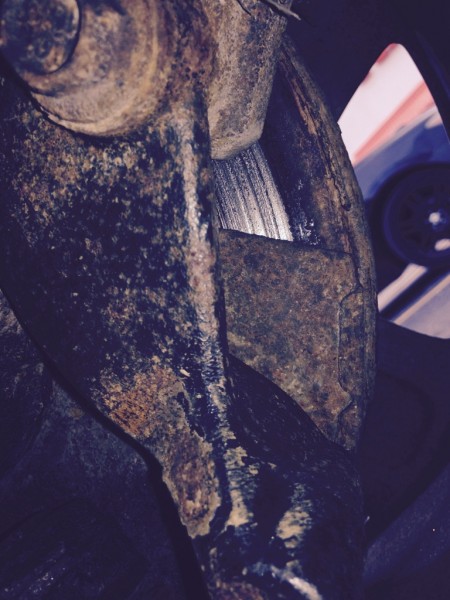

Check your brake pads and the inside of the rotor for scoring like this. Last TECORE I did newbie mistake and didn't check my pads. Knew from state inspection that they were low. Need less to say I changed out my front rotors and pads on the trail. :;

My brake rotors and pads are "adaptative" from NAPA and have only one year old. So I didn't think it could be that. And I know what kind of noise come from this scoring.
