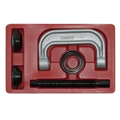

Also, not sure if anyone else ran into this, but I rented the ball joint press from autozone (pictured below). The press, however, was a bit too big, so it couldn't center properly on the ball joint (interfered with the vertical portion of the steering knuckle). When the press would come down on the top ball joint 'stud' (for lack of a better term), the ball joint would just rotate, instead of pressing out. A little secret - I cut a steel pipe down to around 2.5" in length, put that over the 'stud', which served to keep the stud from rotating when being pressed. I wish I had taken a picture.
