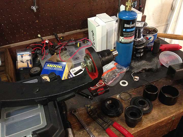

by mikekey » Sat Jan 18, 2014 2:08 pm
Slowly and surely getting things put back together. I can't believe it took 20 minutes to press in one freaking ball joint! These Moog ball joints look pretty nice however.
by Moots1288 » Sat Jan 18, 2014 2:13 pm
mikekey wrote:Slowly and surely getting things put back together. I can't believe it took 20 minutes to press in one freaking ball joint! These Moog ball joints look pretty nice however.
Looks good
