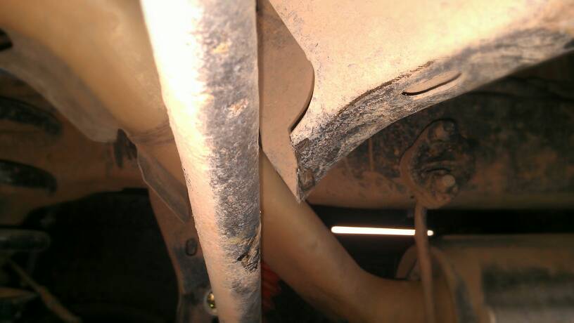

JamesDowning wrote:Back to the original subject, can the frame brace not also mount on the lower bolt hole? You're introducing bending into the bracket that doesn't really need to be there.

ErikSS wrote:JamesDowning wrote:Back to the original subject, can the frame brace not also mount on the lower bolt hole? You're introducing bending into the bracket that doesn't really need to be there.
I'm not sure I'm following you James. This bracket cups the C shape of the original bracket. It uses the original hole and 1 hole to be drilled as support. Then the panhard bar mounts lower.
ErikSS wrote:I'm pretty sure he has the Massive kit. Not sure if he realizes that makes a difference.
ErikSS wrote:I don't know of anyone who's axle stayed centered after a suspension lift. Yours is pretty tall. If you're panhard bar isn't level, your axle should be towards your passenger side.
Regulator1175 wrote:Do you have an adjustable bar? There is no way that your still centered if it is still the stock bar.
HARDTRAILZ wrote:I needed an adjustable bar to center mine under the truck. Did not need anything else with stock arms, 1/2 inch longer arms, 8.0 or 14 bolt rear end.
