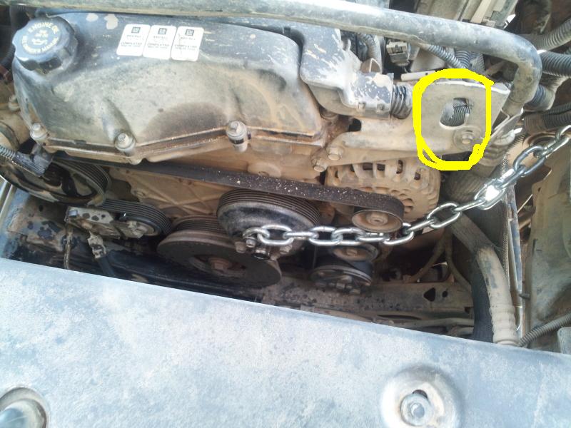

Shdwdrgn wrote:I'm trying to follow Regulator's suggestion for pulling the diff up through the engine compartment... Everything is loose on the bottom end (finally got the half-shaft out, and the diff is unbolted and popped loose from the pan)... HOW do you pull out the fan? I see four bolts on the pulley, and four bolts holding the blade to the fan clutch... but I don't see how the fan actually comes out?
take out those 4 bolts and then get a chain and hook it to the fan somehow and UN screw that big nut and the whole fan and shroud come out together
by Regulator1175 » Sun Oct 06, 2013 8:43 pm
I replace one of the 4 bolts with a longer one threaded through a chain. Then take the chain to the drivers side control arm and wrap it and bolt the chain to itself snug. Then it is just a matter of getting a big wrench to break the fan from the water pump. The fan and shroud will lift out in one piece.

In regards to the fan, usually if you put your wrench on that big nut, and give it a good smack to break if free, it will pretty much spin right off. And same thing when you put it back on, after its snug, give it a smack to lock it down.
My motor has a lifting point similar to this one built in. I know Dirty Bacon just runs the chain to here. I've done the same on my truck. If you dont have chain readily available, you can back out 2 bolts on the fan pulley and wedge a screw driver between them to hold the pulley. It works, but can be a PITA. The chain is definatly easier.
by Shdwdrgn » Sun Oct 06, 2013 10:06 pm
Oh I have the chain, I tied it to the lower frame, I just can't get the nut to budge.
