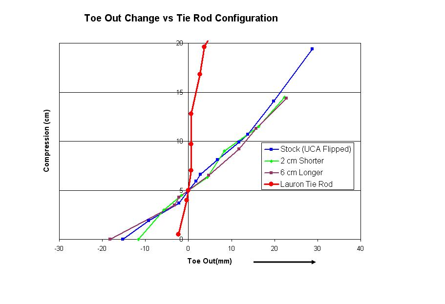

Bump steer measurement and tie rod components
Bump Steer Measurement 1.JPG (30.4 KiB) Viewed 18868 times
Tie rod components.JPG (24.44 KiB) Viewed 18868 times
