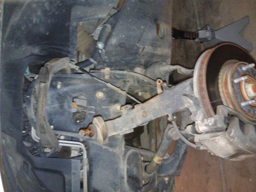

Cable810 wrote:I did it the same way as Jason and Chris mentioned. I used a set of Locking Pliers to hold the shaft and took some Big Azz pliers and clamped onto the shaft, PB Blasted it and Heated that Sucker up and had my friend take the nut off while I held the pliers. Came off like it was nothing.
