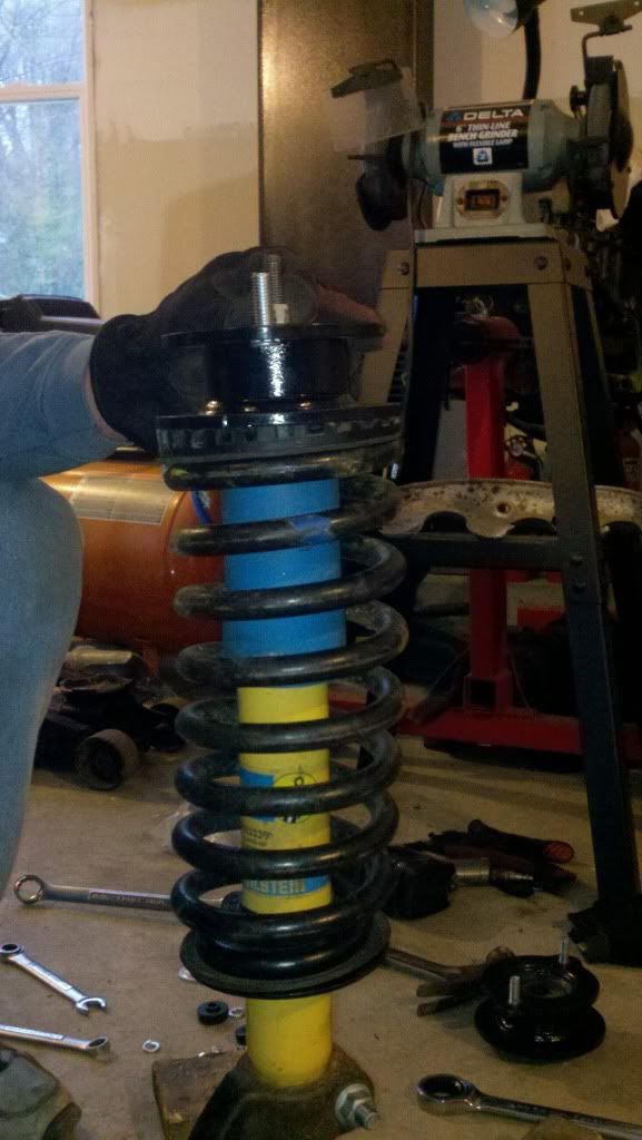

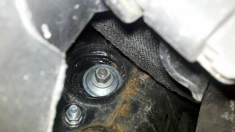

So RC sent me new hardware and a new spacer without question, which I received yesterday. I spoke with a representative online and via phone and I think what it all comes down to is not having the center nut torqued down nearly enough. Following the provided instructions it gave me no inclination I had to compress the bushings and go much tighter than what I thought was correct. I simply figured that having the same amount of exposed thread compared to stock would be adequate. But either way, RC stood behind their product and made it right for the customer!
So here we go,
This time I went very tight on the center nut. I got a full 1" of exposed thread, maybe 1/8 more.
Here is a better shot, you can now see the bushing expanding under the concave side of the washer as its being tightened. Campared to my old pics you do not see this and I only have about half the exposed thread.
Here is the pass side assembled, still has some kind of weird deflection going on slightly that the drivers side does not have. You can see the hat/spacer slightly lower on the left side. In order to get a straighter assembly on install I made sure the downward angled faced out (toward me) as the mount point on the vehicle is angled opposite slightly, as you draw the nuts up and tighten the spacer to the truck it will slightly bend the spring straighter, otherwise it will favor the angle more.
Now since I originally posted my issue I have barely driven the vehicle, and from this pic you can see the other spacer was just starting form a grove from the strut stem, but I caught it in time.
So now that I have it all tightened down and back together I think I'm gonna be ok :) I'm no mechanic, but I've turned enough wrenches and aftering doing it this last time I don't know how it never struck me odd. I should mention that installing the assembly was much easier this last time with the nut an extra .5" down, I was able to get the strut arm back on the control arm much easier, I was fighting tooth and nail last couple times. Thanks to all those who posted up responses you guys helped me out more than you know! Now off to get 1 more alignment to be safe. I hope my experience helps anybody else who bumps into similar issues.

by navigator » Tue May 01, 2012 10:48 am
glad you got it straightened out.
by fishsticks » Tue May 01, 2012 12:38 pm
You have them in there correctly now.
Keep that old spacer, it still looks serviceable!
