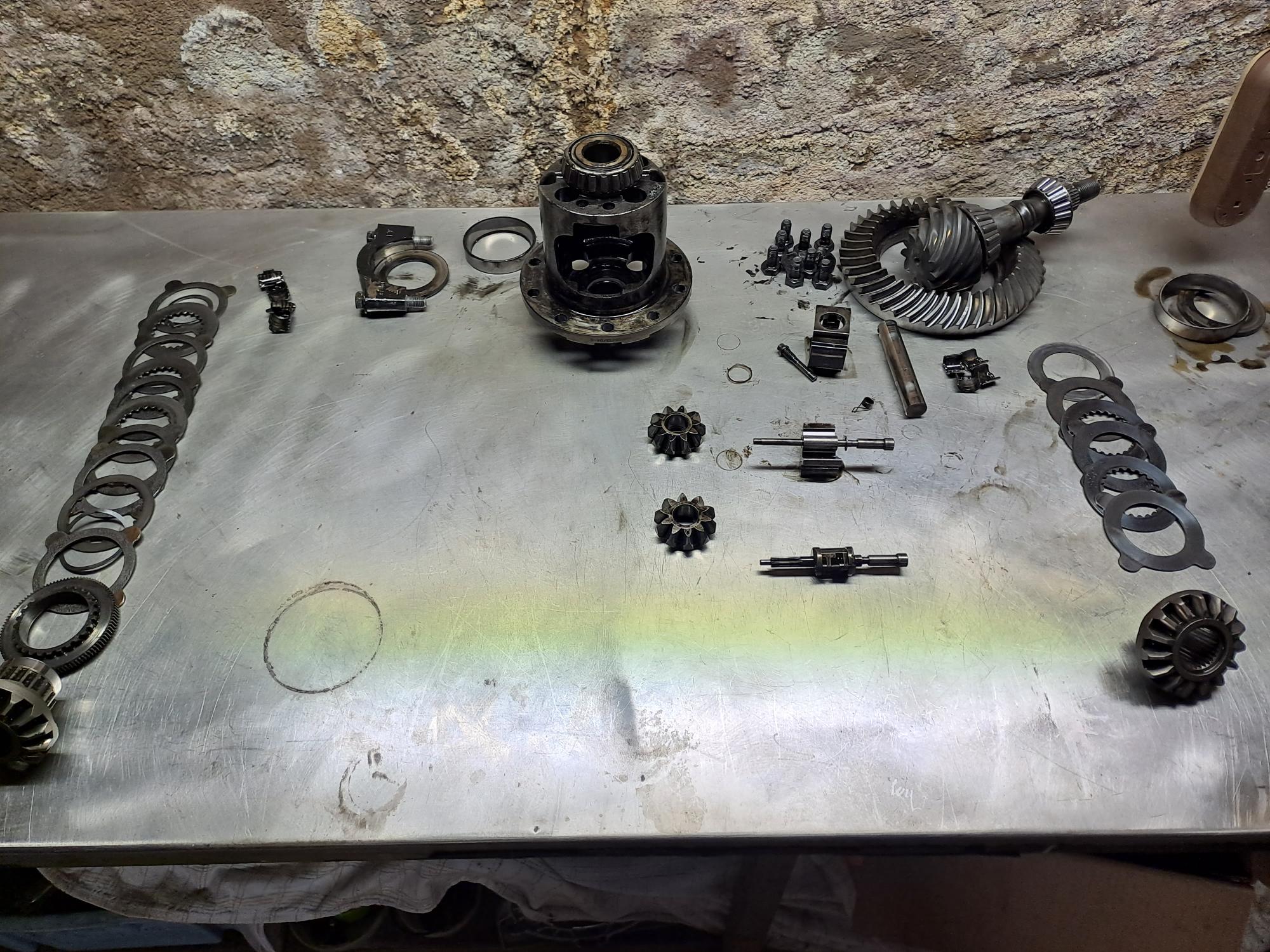

by jeantalus » Tue Aug 01, 2023 4:01 am
Decided to go ahead and disasemble the pumpkin to see if all other parts are serviceable and decide if this 8" worth a nex set of spider gears,
So take a look to the attachement, anybody have an experience with those parts and could tell me if they're ok or not ?
Thanks community !!!!
my question is, on the ride plates pack , they look shinny and mostly smooth
on the left pack, side with slotted device under pignon to get pressure on plates, they look more rough
