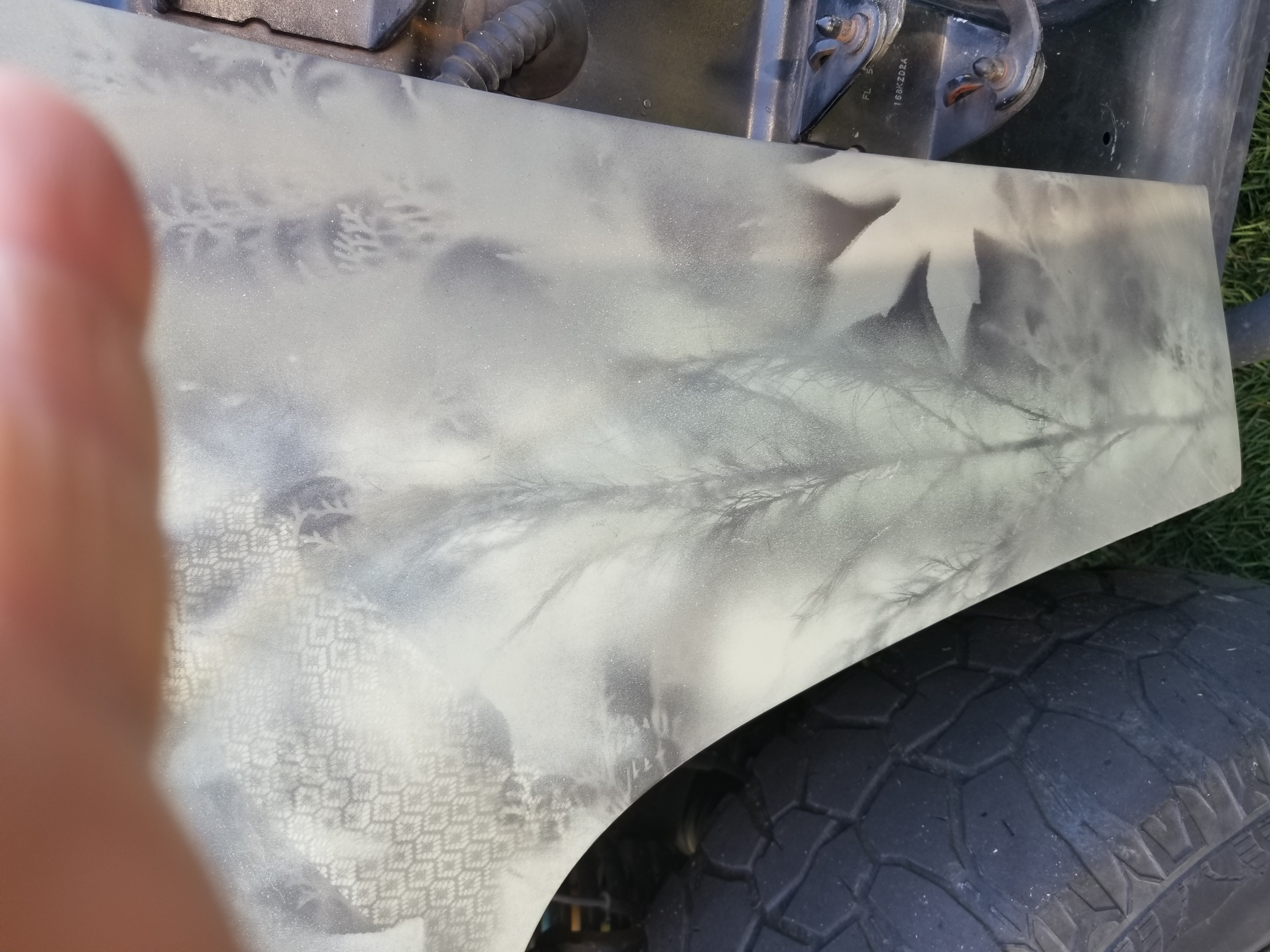

I love paint.
by mall_creeper » Thu Aug 23, 2018 5:57 pm
Bored.....

Not my cup of tea but looks like you were really bored and it turned out cool!

That is AWESOME.
How hard was it? And how much was it?

Lol cost about 60 bux. to paint. Easy to do, impossible to mess up.

So did you just use stencils?

No stencils. I painted the truck dark forest green, then used weeds, by just spraying them laid against the truck. While the weed is against the truck dust it with two different colors, but not every one. I am making some digital stencils for the other side. Practice different techniques on cardboard till you get your desired effect. I used a perforated piece of cloth on the right front fender to get the snakeskin effect. The spray over media available is limitless.

I'm digging it. Almost looks like a winter camo kind of pattern. haha

wow, looks really nice ;)
