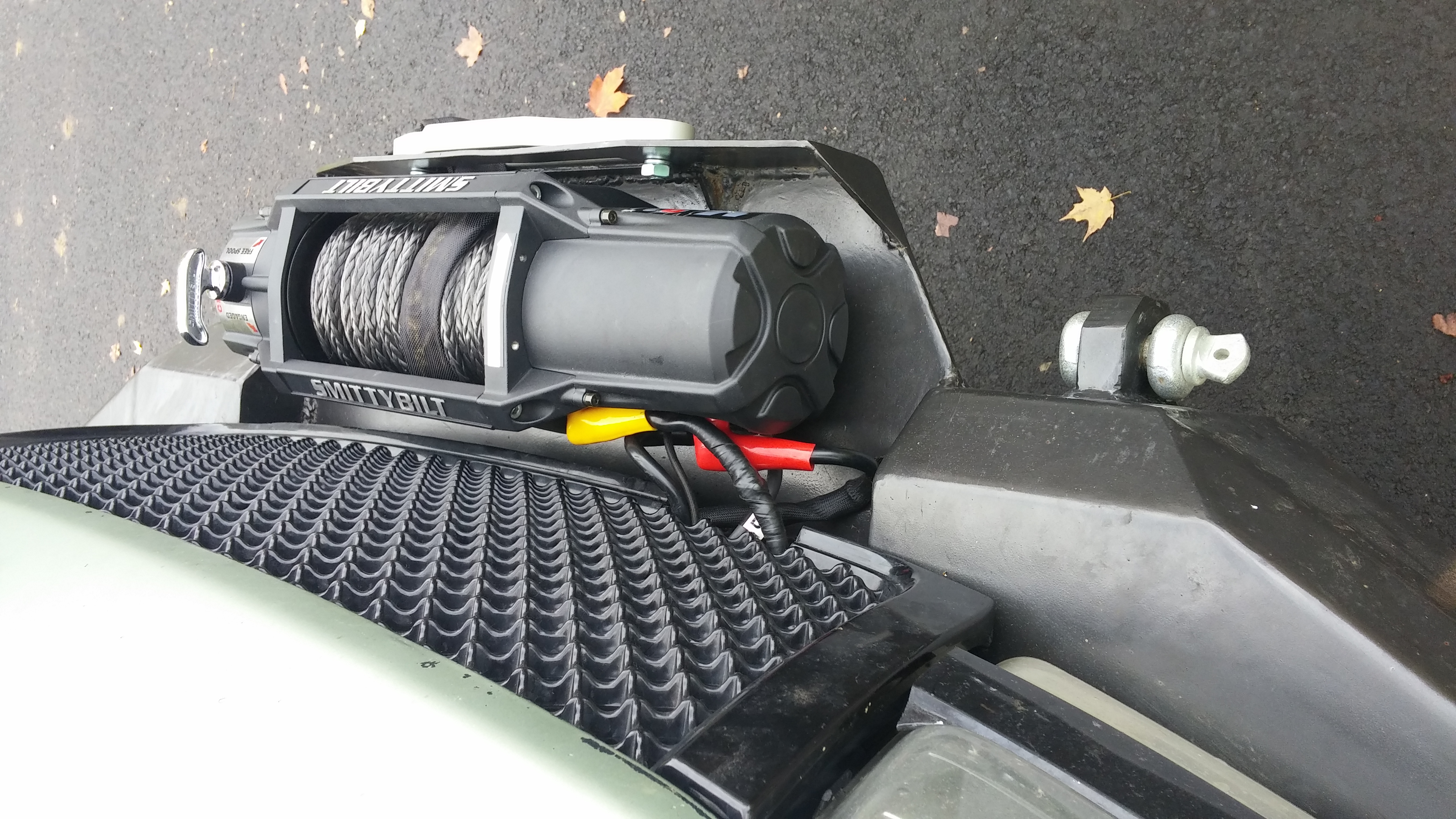

Winch pictures. Remote mounted the solenoid pack for a clean look.
