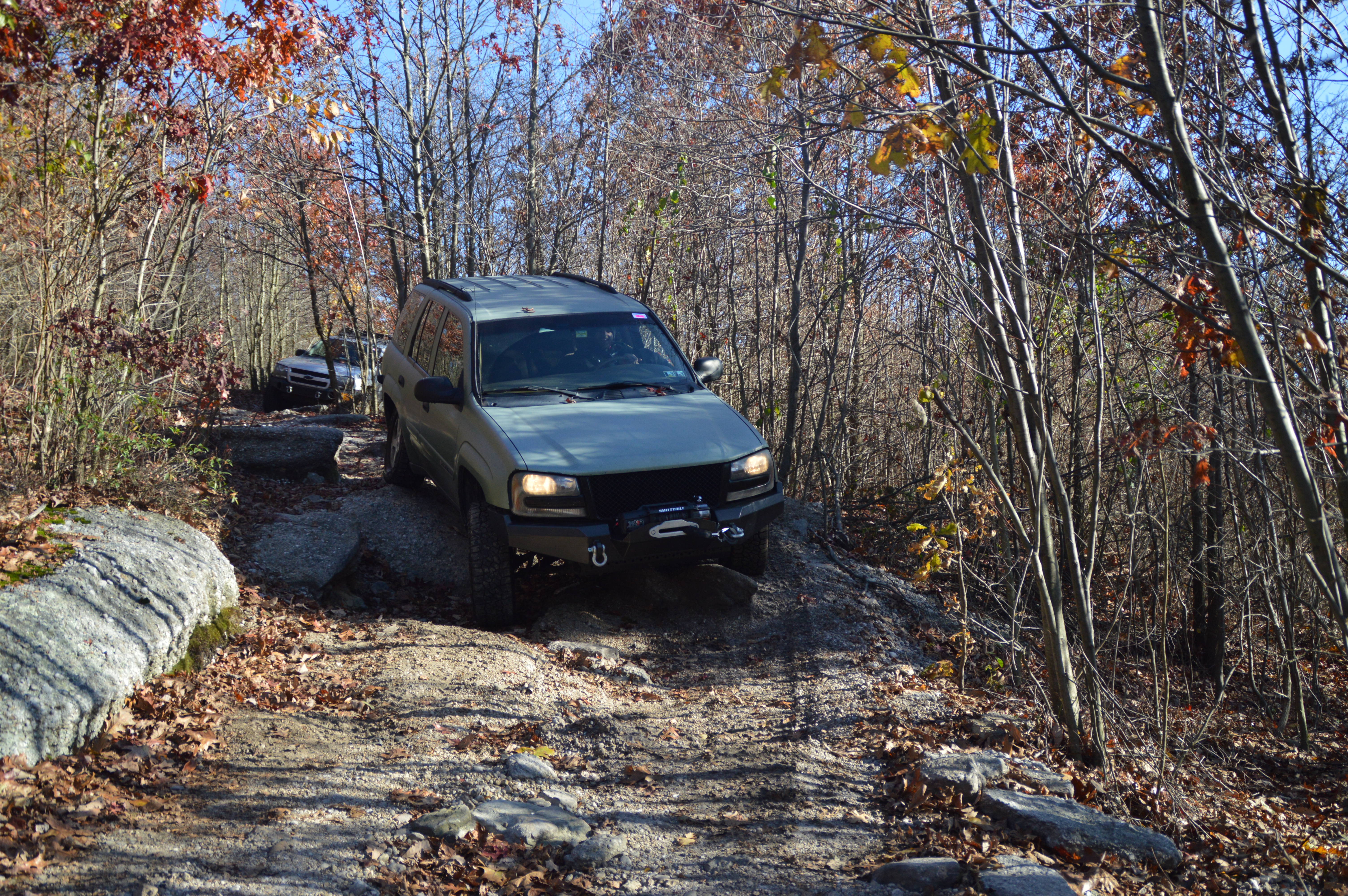

by dvanbramer88 » Sun Nov 12, 2017 4:14 pm
Rausch Creek 2017
