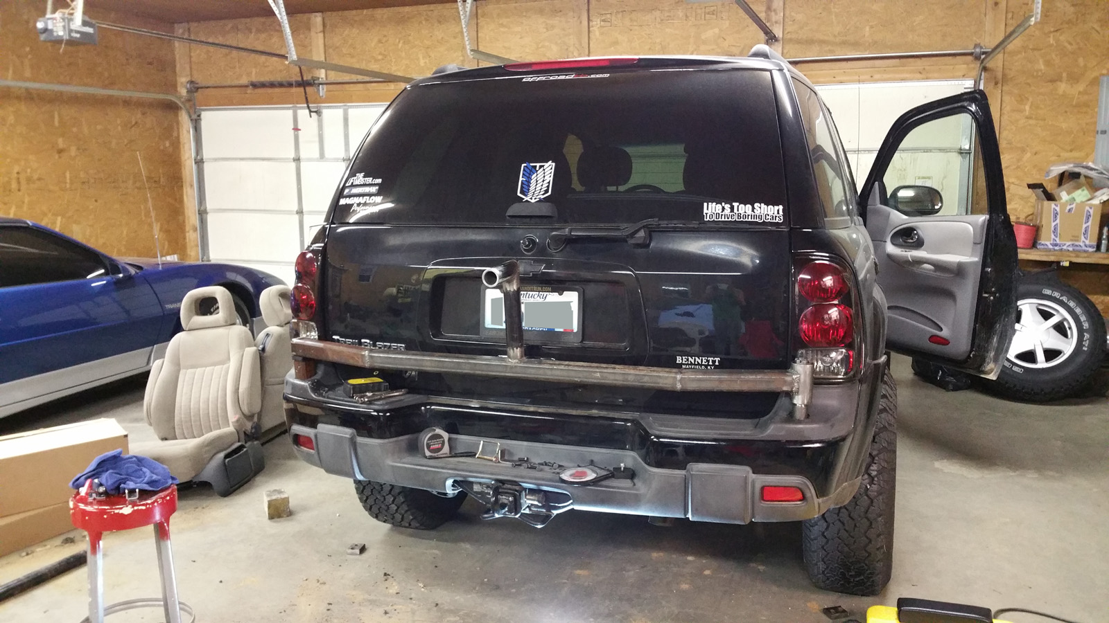

by TBYODA » Sat May 23, 2015 10:21 pm
Got some 1" square tube welded to my tire carrier to hold my Hi- lift. Still got some gussets to add but ran out of wire. :(
My welds are getting better starting to know my welder.
by Trail X » Sun May 24, 2015 12:07 am
The gusseting may not be needed today, but if you plan to keep it on there, I could see it cracking out over time without them. Better to be safe than sorry. Looks good Robert!
by TBYODA » Sun May 24, 2015 12:28 am
Thanks James, this is really is just in between step. I was going to totally rebuild the tire carrier and try to make it shorter and still lay mostly flat when the tire is down. But instead I decided to spread the effort on some type of swing out which is what I really want. Yea I decided to add the gussets because of side to side action that the hi-lift will have mounted horizontally. Probably would have made more sense to mount the hi-lift vertically.

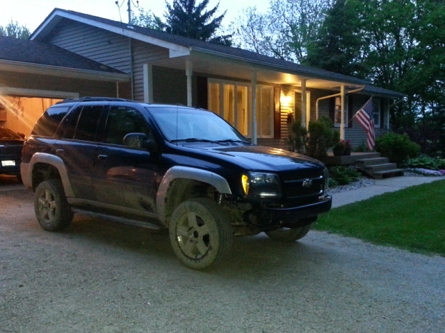

got my lift on yesterday and did some adjusting. wish i had lifted my first tb and done this one sooner.
limited testing

I always love the ltz fenders when lifted.

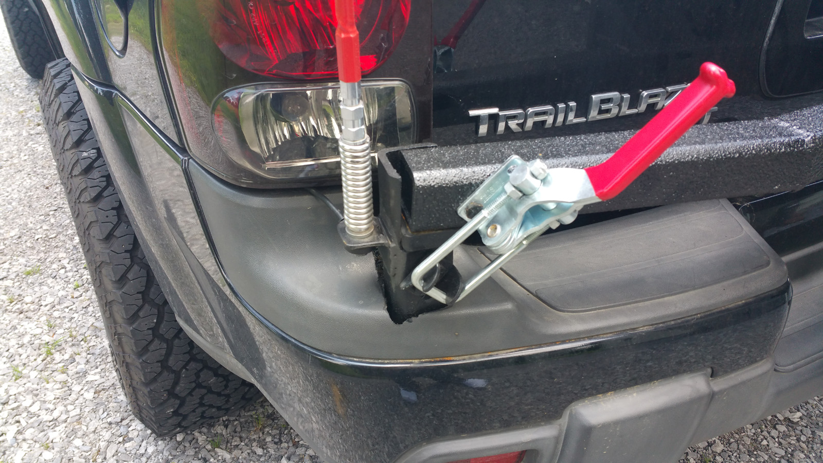

Been crazy since we've been back from our short stay at TECORE last weekend, so I never got a chance to post pictures. Here is the tire carrier we built. Not fancy or elaborate, but we're weekend fabricators and it works. Still trying to come up with a saftey pin to attach as well, for a 'just in case'. I have a strut I'd like to attach too, but it may be to stiff, just haven't had time to mess with it any further. This made the road trip to Virginia and back without an issue.

I like it!

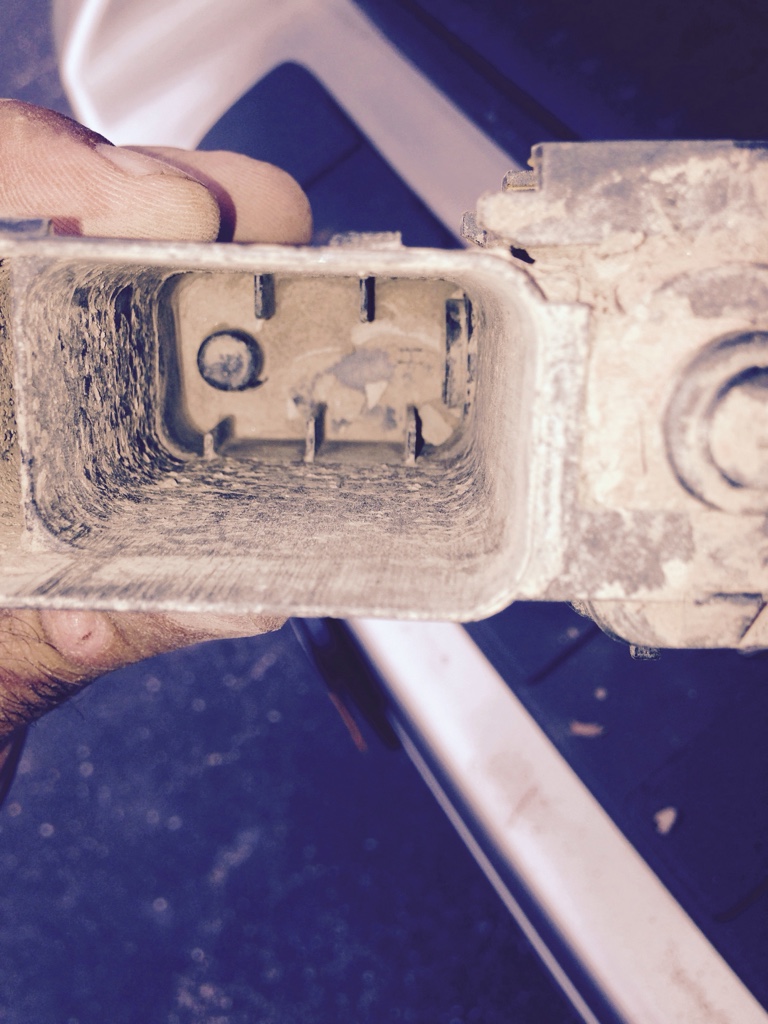

Been chasing a Evap code for a few months. Has any one thought of relocating the purge solenoid near the gas tank?
Seems to be in a bad location when going through muddy water etc.
It really nothing special has a filter inside it and was full of mud. Was able clean up, keeping as spare.
by TBYODA » Thu Jun 11, 2015 7:59 pm
Here the old part. Might have been able to get away with just cleaning it.
