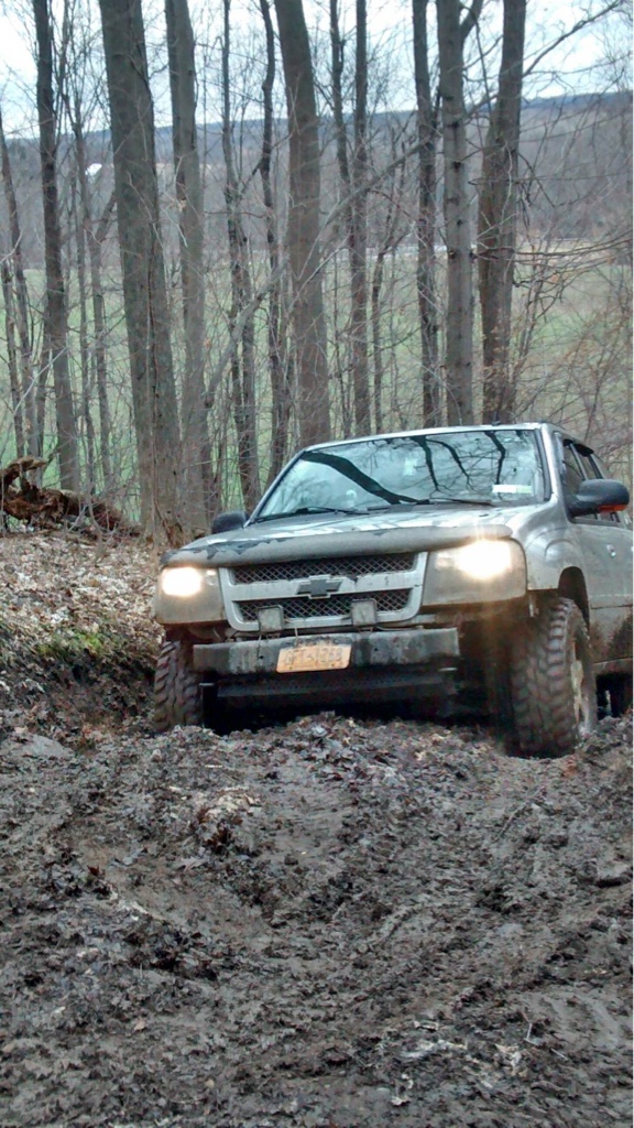

I went out and got her muddy with a few local jeep clubs, tried to go up a pretty rutted hill and couldn't make it, instead got some fender damage. Was able to bang it out after.

by TBYODA » Mon Apr 13, 2015 10:44 am
Trail X wrote:Nice pictures Robert! How'd the tires do?
The MXT tires performed excellent, they cleaned out great, dug in great. I didn't really have any issue on 90% of the trails, never got stuck. Only areas I couldn't do were the really deeply rutted spots but not because of the tread but tires size. Over all I am very happy with them.

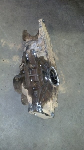

Front diff is in! That is quite possibly, one of the dumbest things I've ever had to change in a vehicle. Everything came loose with ease until we got to the last bits. Had to replace passenger UBJ, it was long gone. Grabbed a cheapo at the local parts store to get by until I can order one that isn't way overpriced.
I got lucky on the disconnect, as it was seized, but didn't shatter on us, got it out in about an hour. Stub shaft came out, no issues there. However... the differential wasn't going anywhere. We spent longer dealing with the removal of it than the entire tear down and reassembly of the project. Last night we finally threw in the towel and hit it with the air chisel to break the oil pan sleeve off of the diff. Once out, we were able to chisel the remainder of the pieces out, including the threaded adjuster. We didn't have enough Kroil in the world to penetrate the built up corrosion on the mating surface.
Thankfully, after a heavy coat of antiseize on everything, the assembly went smoothly.
Thanks goes to Fishsticks' old top side removal write up. I have an efan, so I was able to axe a large portion of what he recommends, only removing engine hoist plate, alternator, idler bracket and compressor, along with unbolting the PCM to make a hole to flex some stuff around. All bearings looked great on the disco and diff, so we opted not to rebuild them, but did replace seals and heavily regrease everything.

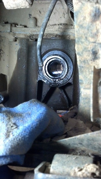

Got my pan hard bar and bumpers/skids on last night!
Found I now have a small tear in my passenger CV boot, but it's on the flat surface near the band, so hoping the Permatex fix holds. Also my trans output shaft seal is now leaking. I can't win for losing.
