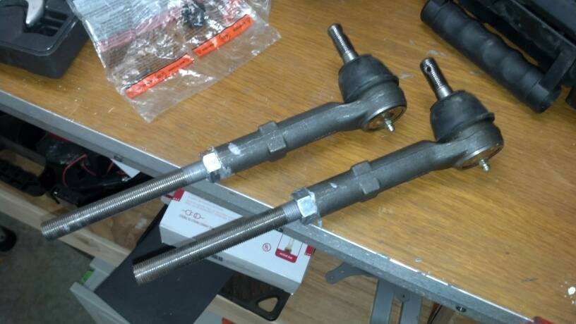

I used the outer TRE from the 2007+ HD trucks, and used the inner TRE from our trucks. Same thread. All I needed to bridge the gap was a 7.5" long M16x1.5 threaded CrMo (class B7) rod.
It simplifies my trail spares, because all I need to stock is the threaded rod. Might pick up some amount of strength from the CrMo rod, but I'm not exactly certain of the stock TRE material to compare the material properties to.

James, how are you adjusting them?
by Trail X » Sat Apr 19, 2014 11:51 am
Same way you adjust stock TREs. Loosen the clamp on the steering boot, loosen the jam nut (I guess you could loosen either one) and then adjust by turning the 26mm inner TRE hex.

by TBYODA » Wed Jun 11, 2014 3:45 pm
Trail X wrote:I used the outer TRE from the 2007+ HD trucks, and used the inner TRE from our trucks. Same thread. All I needed to bridge the gap was a 7.5" long M16x1.5 threaded CrMo (class B7) rod.
Seen your update to you build thread on this nice mod. For those of us that are not a ME or have access to source/buyer at work. :mrgreen: Could you help out your fellow members with maybe a source or the best way to look it up with the right terminology.

by Trail X » Wed Jun 11, 2014 5:07 pm
TBYODA wrote:Seen your update to you build thread on this nice mod. For those of us that are not a ME or have access to source/buyer at work. :mrgreen: Could you help out your fellow members with maybe a source or the best way to look it up with the right terminology.
B7 grade M16 threaded rod.
I had luck finding it on Mcmaster and Fastenal. I purchased 1m sections, and cut them down to size myself.
mikekey wrote:Surprised you did that James, I thought you were in favor os just using the stock TRE's. Did we all determine that the original bent shape was because of the tire position?
I don't think I was ever in favor of the stock TREs. As soon as I saw that the tires were no longer interfering with the tie rods, I wanted a better option. I was not in favor of upping their size too far though, because it would potentially push the stresses into the rack. The thread size I used is the same as stock (M16), the only increase in strength is from the material, and that property technically doesn't come into play when calculating buckling strength (which is how these generally fail).
