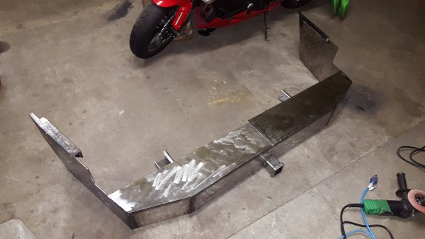

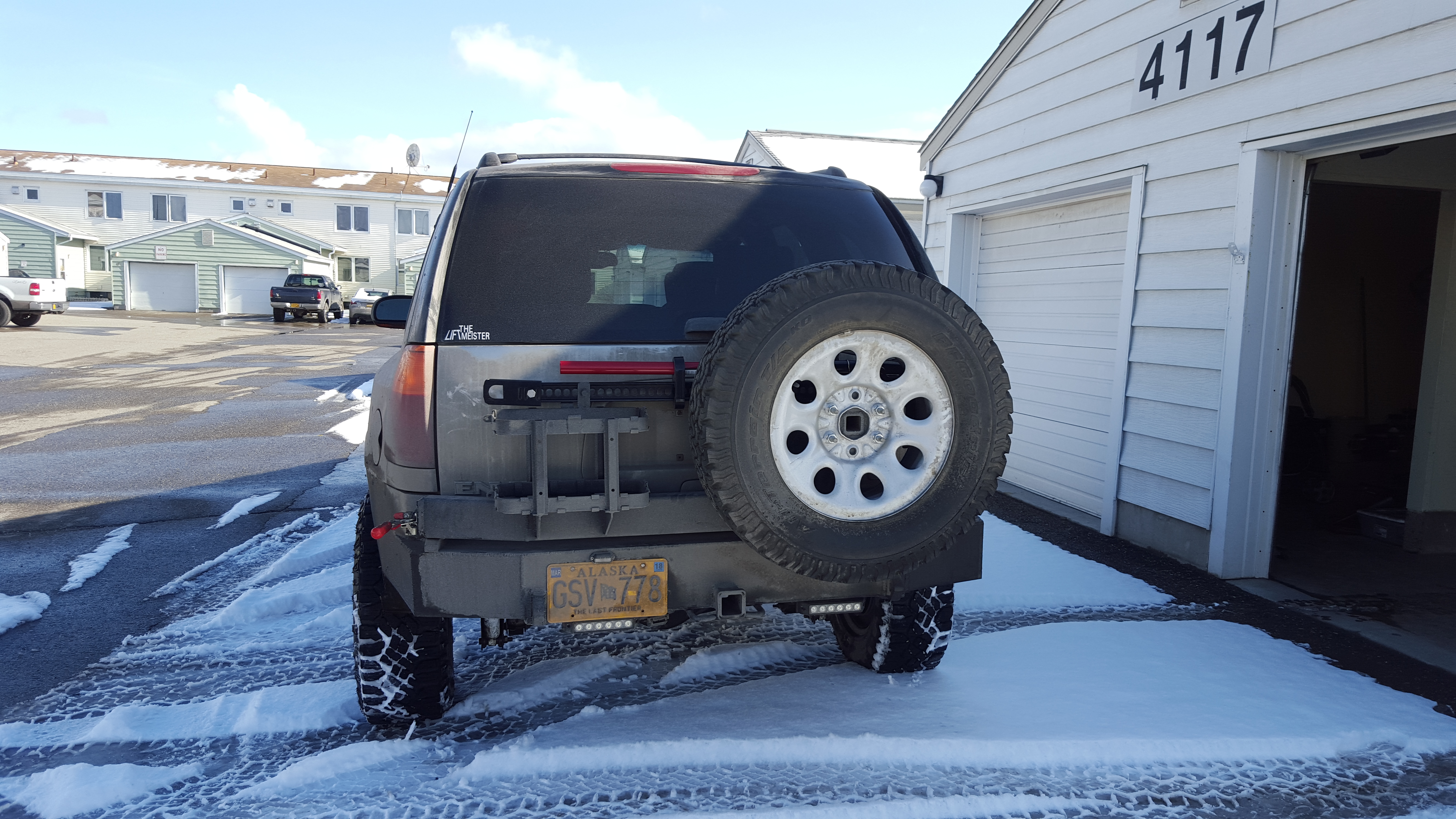

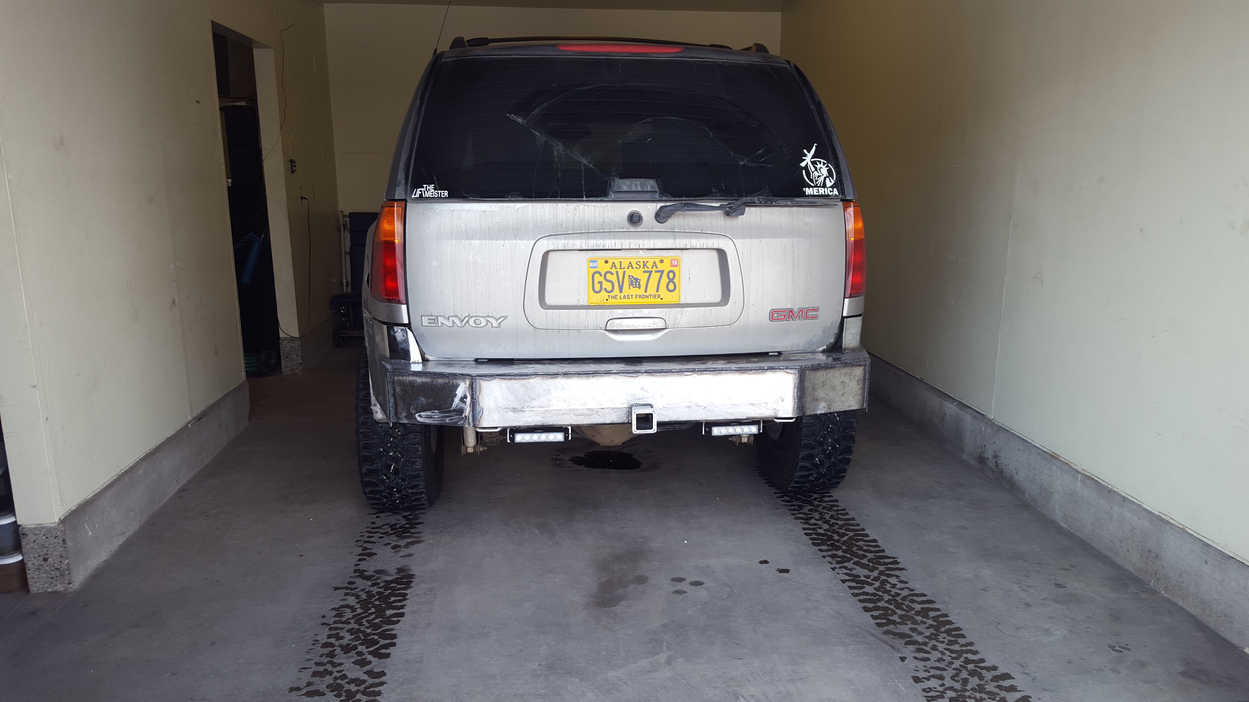

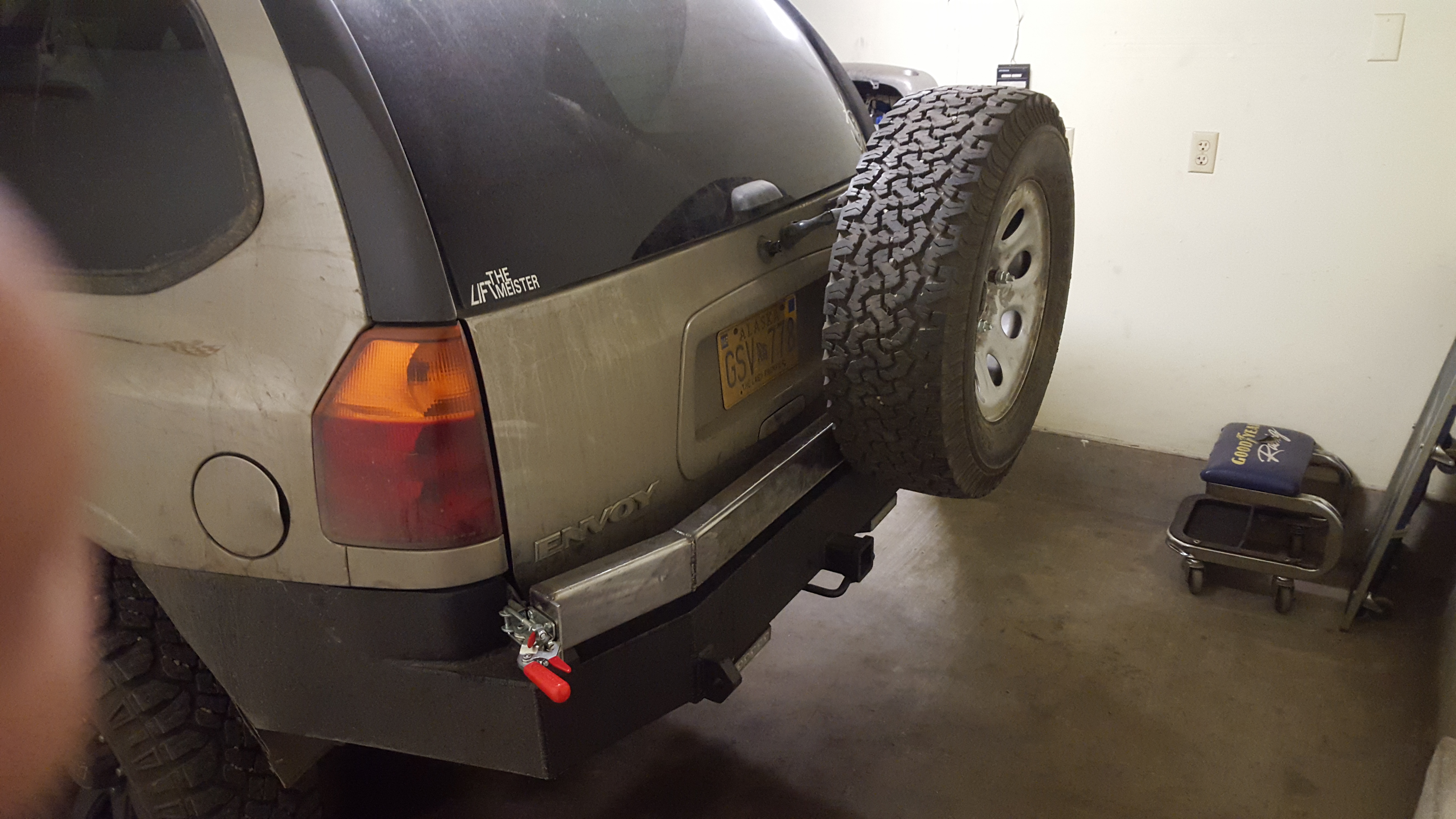

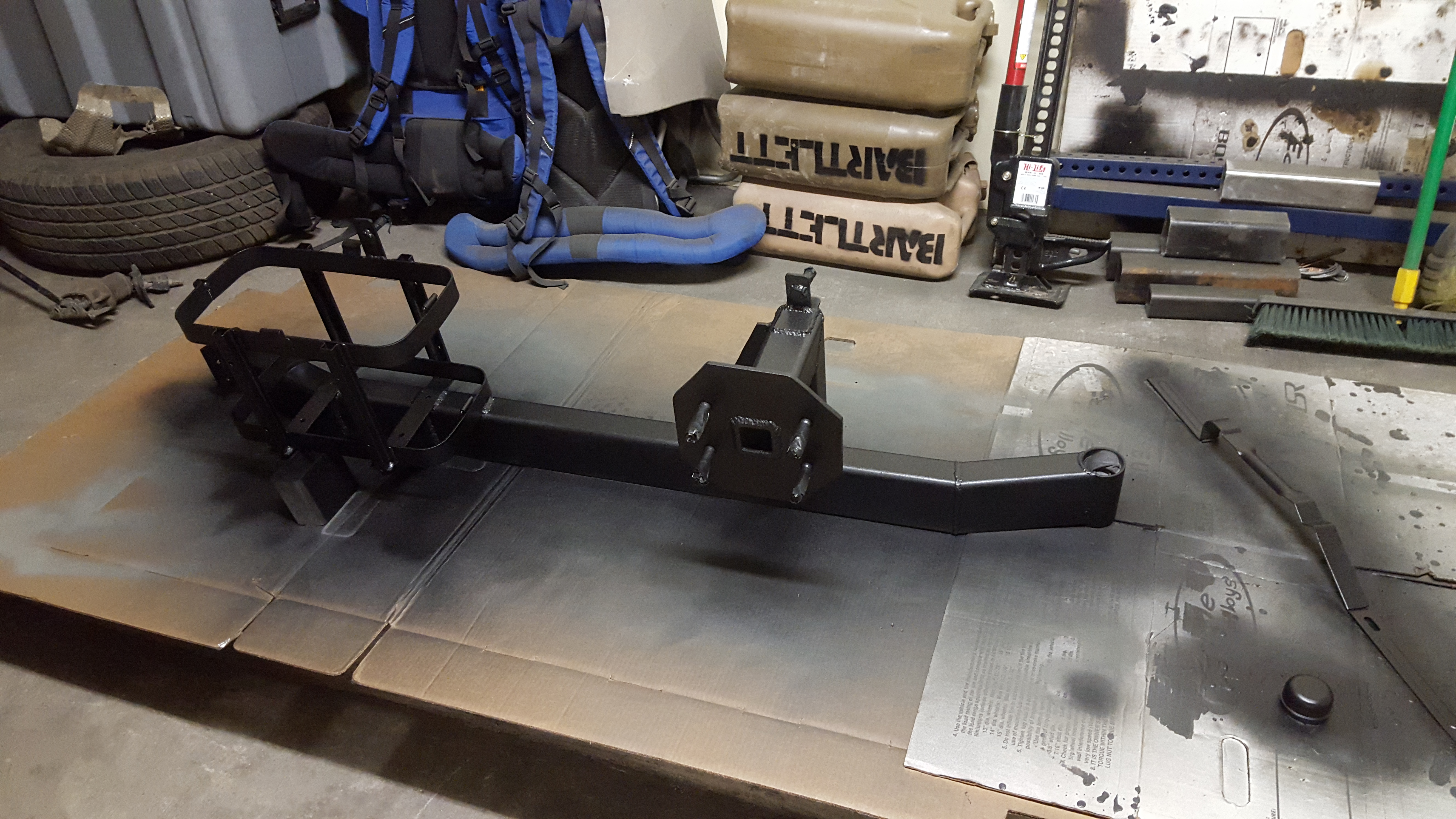

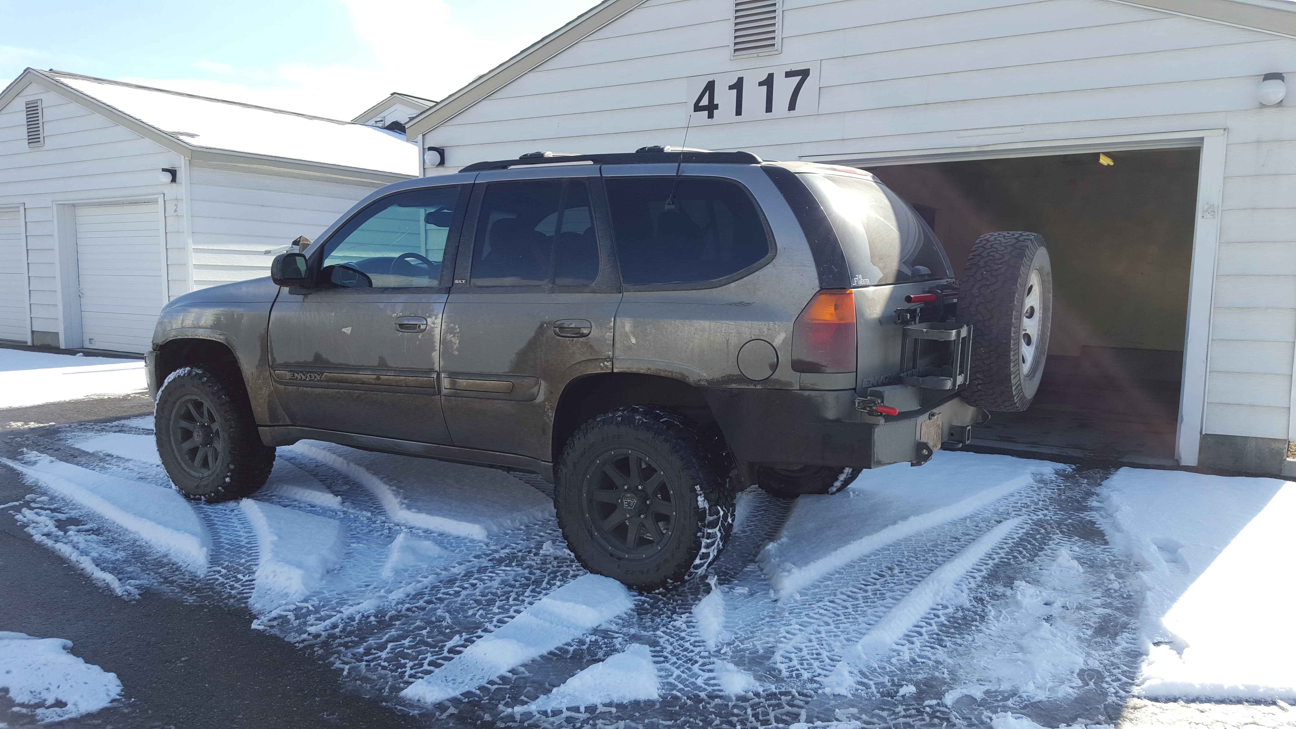

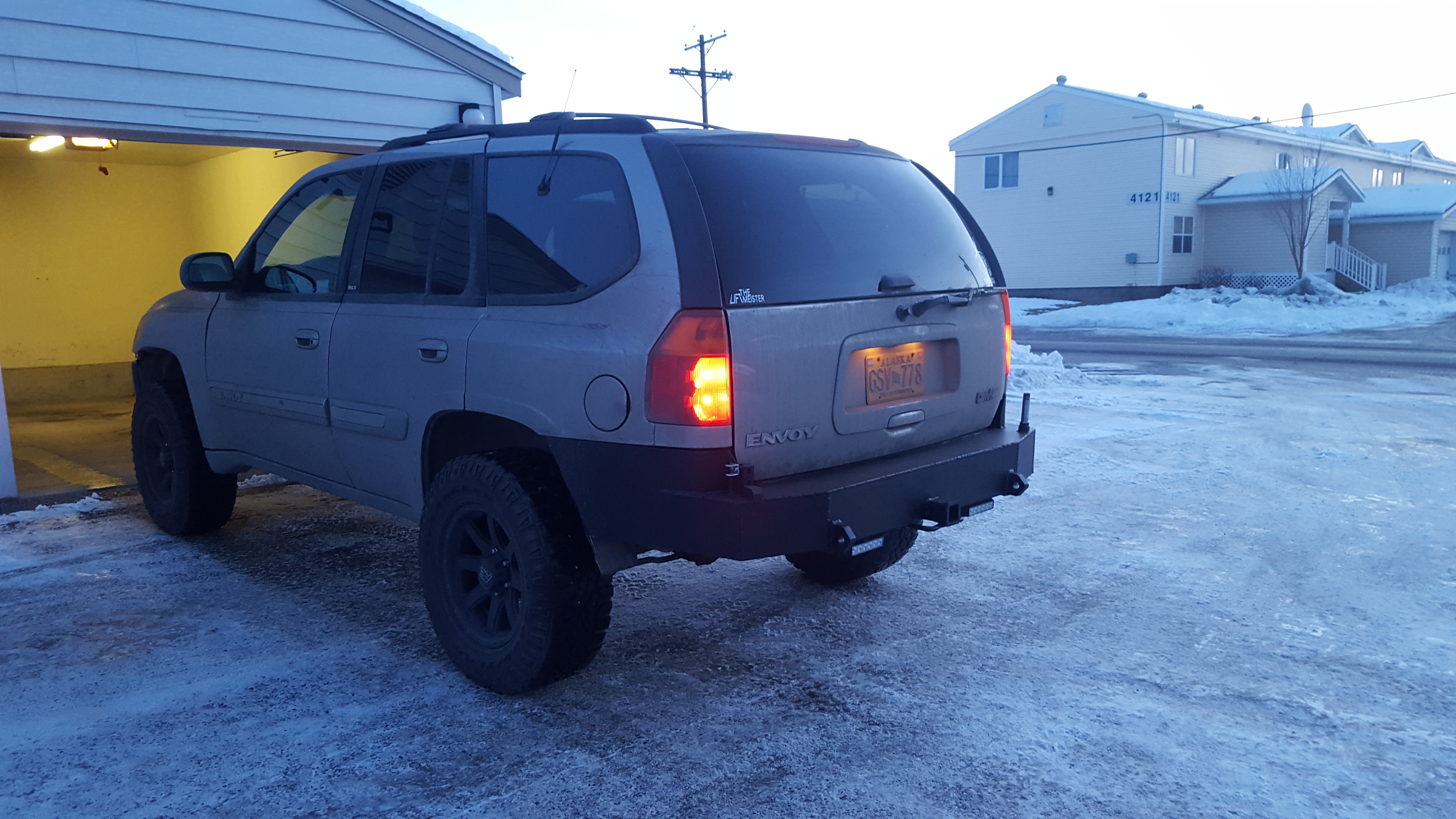

After way too long and probably an unnecessary amount of work my rear bumper is finally finished. I've wanted to have a nice bumper for quite a while now and after drooling over the ones on here I decided to start on it. I owe so much to Barton for helping me out by pointing me in the right direction when I wasn't sure of what to do, or the best way to do it. I would've loved to have one of his bumpers but being in Alaska, the shipping would've killed me, as would my wife. It's not perfect by any means nor is it even close but for the first time fabricating anything I'm happy with it. Anyways, on to the pictures now....

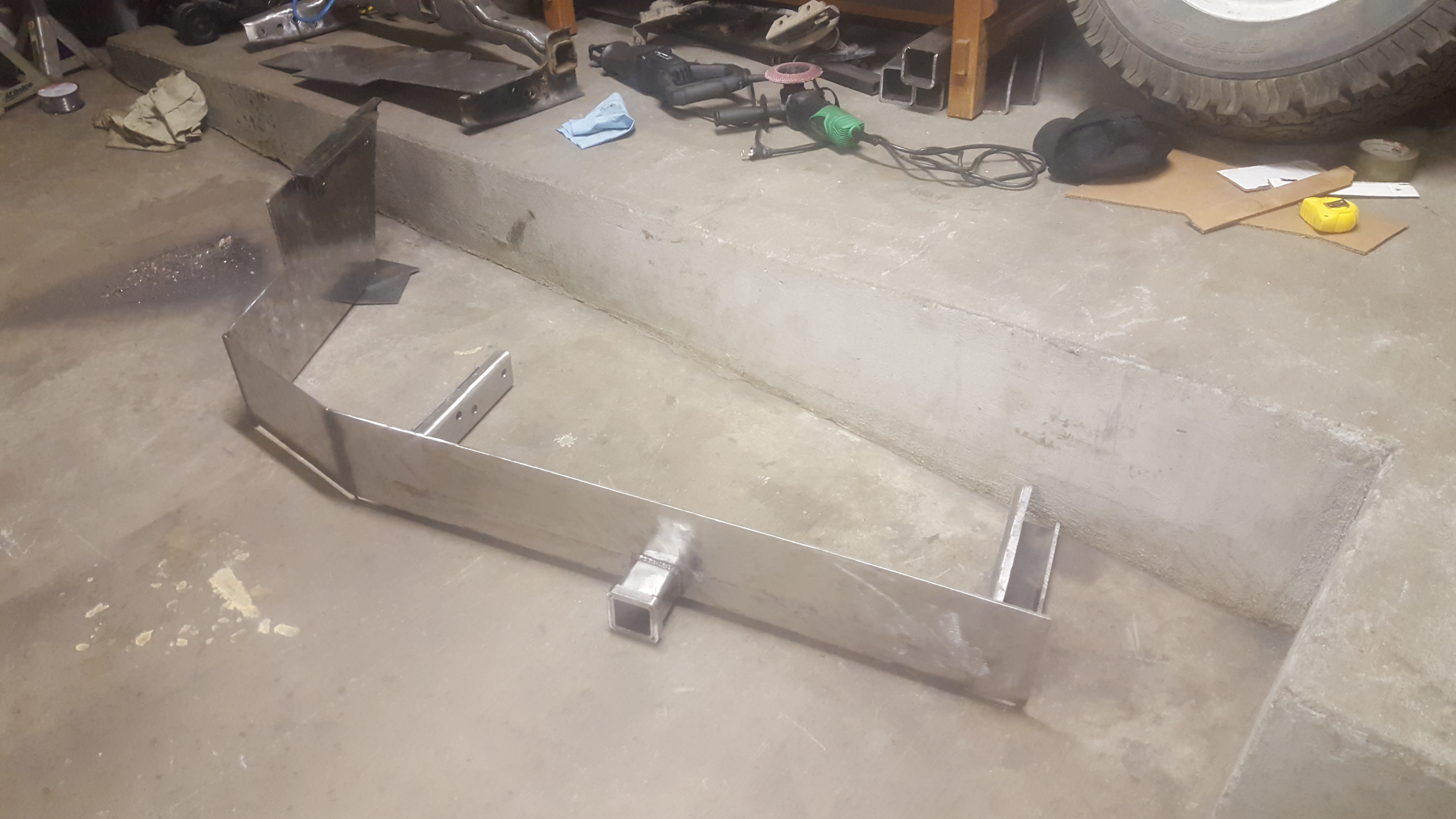

both "wings" attached now
on the vehicle with one of the under the taillight sections done
bumper is done and coated in truck bed liner
tire carrier and latch added to the swing out
Added a Smittybilt jerry can holder. Swing out finished and coated in truck bed liner
Finished product with spare and hi lift mounted
Some of the parts I used
Mega spindle tire carrier hinge kit from A to Z fabrication
Swing out latch, De-Sta-Co 341-R
Smittybilt 2798 Jerry can holder
Kawell 18W 6500K LED flood lights
Swing out polyurethane stop for the swing out from EMS Offroad

It looks nice! Is there something more than the plate going side to side supporting the hitch?
by Trail X » Tue Apr 05, 2016 8:32 am
Wow, first time fabricating? Well done sir! Looks like a really nice job.
How did you reinforce the hitch?

Thanks guys!! Just like Barton said, I started off with the hitch like he does, 3" square tube in the frame rails and 2.5" tube in-between. I seem to have lost the picture of just the hitch though. All said and done I think I was around 600-650 into it.
