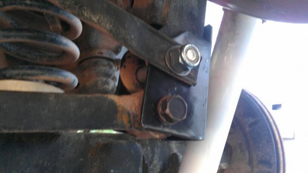

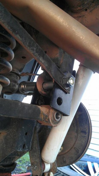

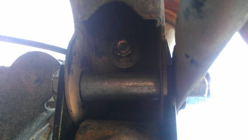

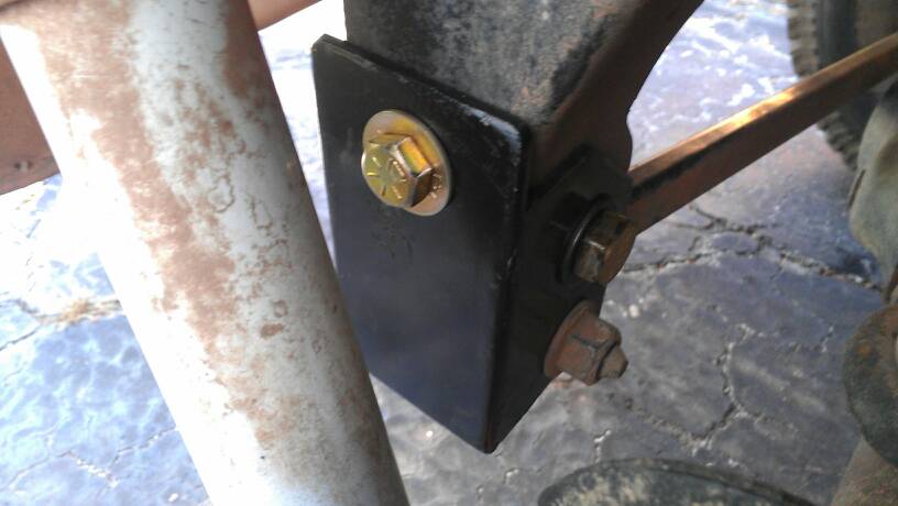

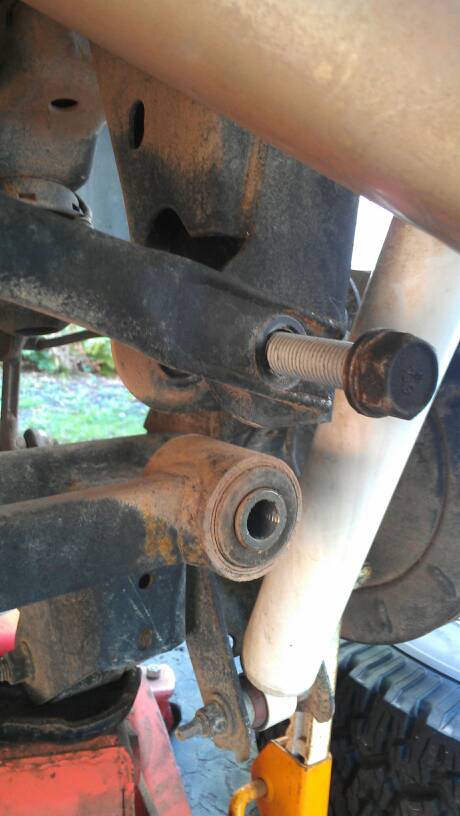

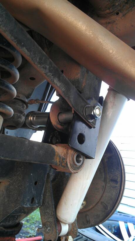

My screen name is ErikSS. haha, sorry man. Those pics are ON an SS with 315/70/17s
Regulators biggest problem is the Envoy wheel wells.
TBYODA wrote:I did a little googling to find what what the panhard bar does, have a idea on that. So what's advantage of lowering the mount point on the chassis, more side to side stability? Please be nice .
Opeth wrote: So with those 35's your still running the stock rear control arms and have made no adjustments backwards with the axle? I assume the rear sway bar is connected too?
ErikSS wrote:TBYODA wrote:I did a little googling to find what what the panhard bar does, have a idea on that. So what's advantage of lowering the mount point on the chassis, more side to side stability? Please be nice .
The panhard bar holds the axle from side to side motion. With a lift, the bar swings not only down bot towards the passenger side. The point of lowering it is to center your axle and reduce the sideways pull on your drivetrain.
